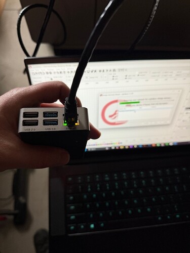

Sounds like you have been pretty thorough, good to try everythingā¦ could be as simple as a bad cable between the pi and the laser? maybe try the same ethernet cable you used to join the PC and the laser directly?
Might also help to power off the laser, and the PI. Wait 10seconds then power on the laser, and once the laser has fully started and finished homing, power on the Pi, and once that has fully booted and connected to the network you may need to use the āRe-scanā button in the LightBurn Laser Window to re-establish the connection from LightBurn to the bridge.

The lights on the Pi Bridge are right hand side (from looking at the port) amber solid, left hand side green. One thing i notice is when i first power on the bridge the right side goes amber, few seconds later the left side flickers green for a couple seconds and then goes solid green as in the pictures.
