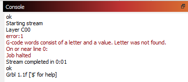

Yes, the ‘… On or near line 0’ note is usually caused by an incorrect setting.
One other setting that can cause this error is selecting an incompatible device profile which in turn generates incompatible GCode.

So this same problem just occured on a differant machine, able to fill text and a square, but not this image….
no errors or nothing, just will not run.

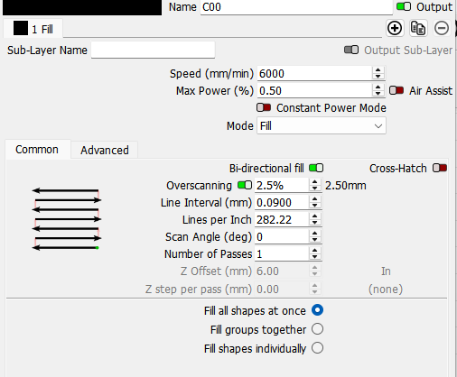

Screeen show of cut layers window…
Your power is on 0.5%. Nothing will engrave at such a low power setting.
And the speed is set to Ludacris speed!
Get your power sorted at a speed of 2000mm/m and then tune. Most machines can move 2000mm/m and get decent results. Very few will do the same at 6000 mm/m.
0.5 is the lowest my CO2 machine will fire. I am engraving on leather. Even if I engrave on acrylic or Romark these settings work well.
