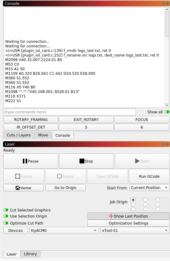

Can you capture the full exact output in Console? Also, please take a full screenshot of LightBurn with the Laser window in view.

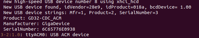

Have you looked at dmesg output to confirm that a serial TTY port is being created for the device?
I have some new lines when I open Lightburn before powering the S1 (on the first test the machine was already on before I opened Ligthburn)

dmesg_output
Here is the dmesg output
The Console output is very atypical for GRBL style machines. You said you’ve connected in Windows successfully. Can you capture the same Console output in Windows?

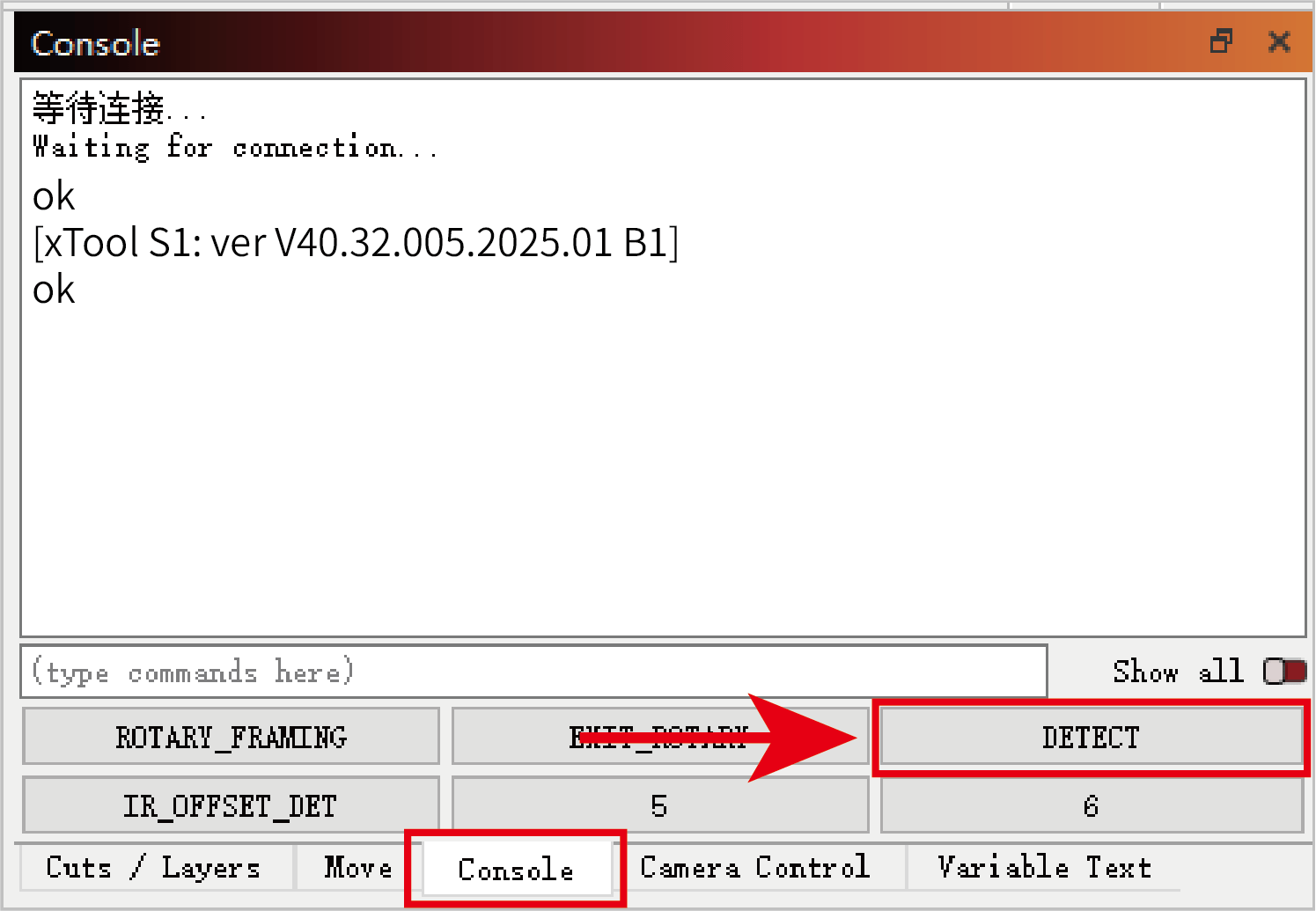

Are you able to try connecting with LightBurn from Windows? It looks to me like you’re not getting a proper full connection. Or possibly the machine is not working in a compatible mode.
You should be greeted with a welcome message similar to this:
