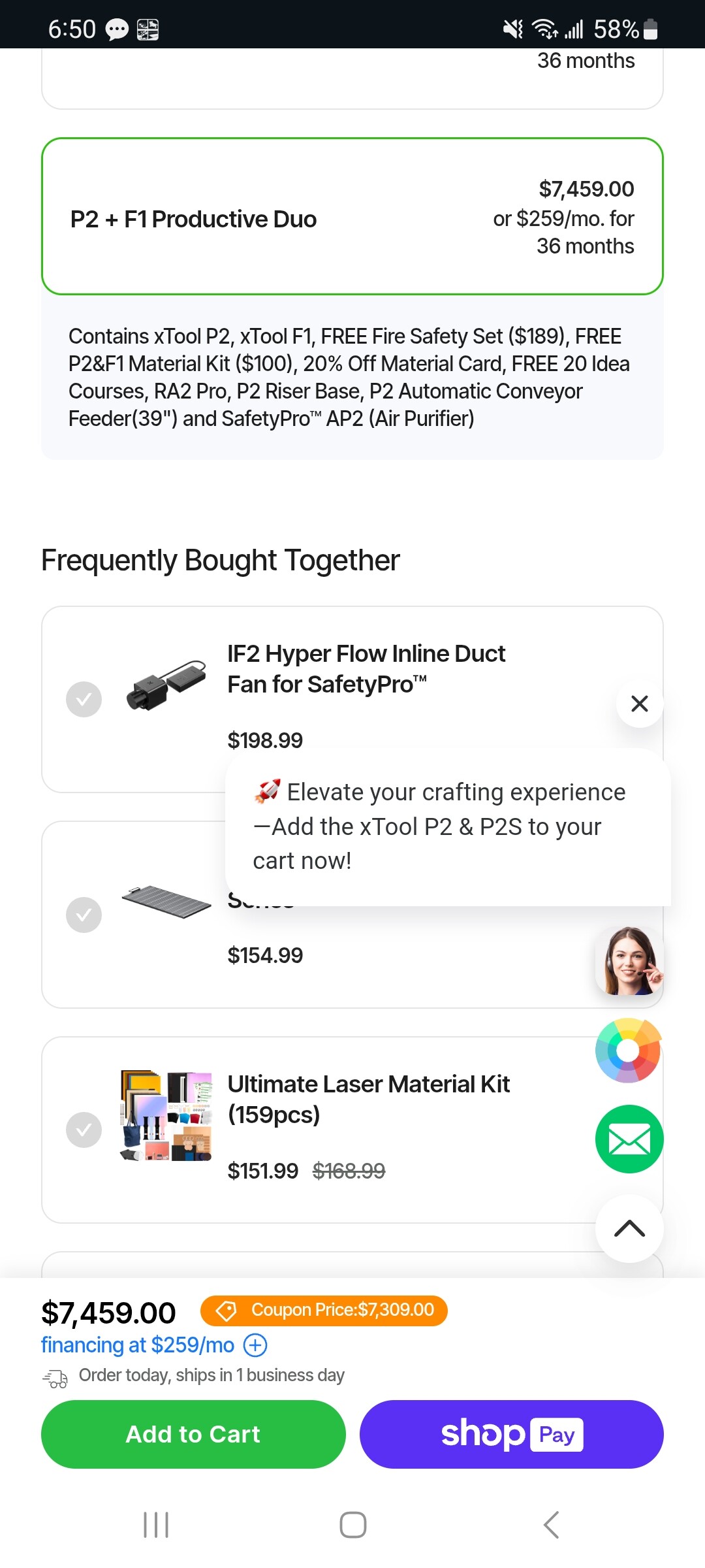

I found 2 different units for sale @ $4K with the rotary/conveyor feeder (which looks like it would be cool to use) and base riser. Well past $5500 new, that was the attraction
Appearances can be deceiving, no?
Perhaps relevant:
Well I am looking at the omtech 60w and a Boss EVO desktop. Trying to decide how much space i want to give up
Welll, i went with this. For all that for$4000
