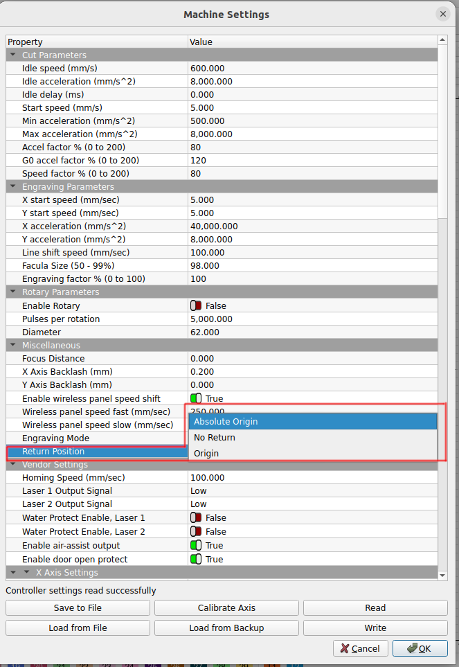

I dont think this is a lightburn problem but i know how knowledgeable you all are out there, and hopefully 1 of you can shed some light on this. I have an old blue and white 100 watt 900x600 Co2 laser. I changed the original crap Leetro controller to a Top wisdom controller, and for a while was happy with it till i outgrew its terrible memory capacity. I upgraded to a Ruida controller with more memory…but no matter what i try i cant get the laser head to start from wherever its ended up at after its last job. I contstantly have to press origin on the controller. I guess thats no big deal, but after 2 years of not having to ive ruined quite a few jobs because of it, and its annoying knowing that i never had this problem with the 2 previous controllers. Any help greatly appreciated. PS changing origin settings in lightburn make no difference.

You can set the machine as to where it returns after a job in the Machine Settings.
Mine is set to origin and returns to where I have set the origin on the console.
