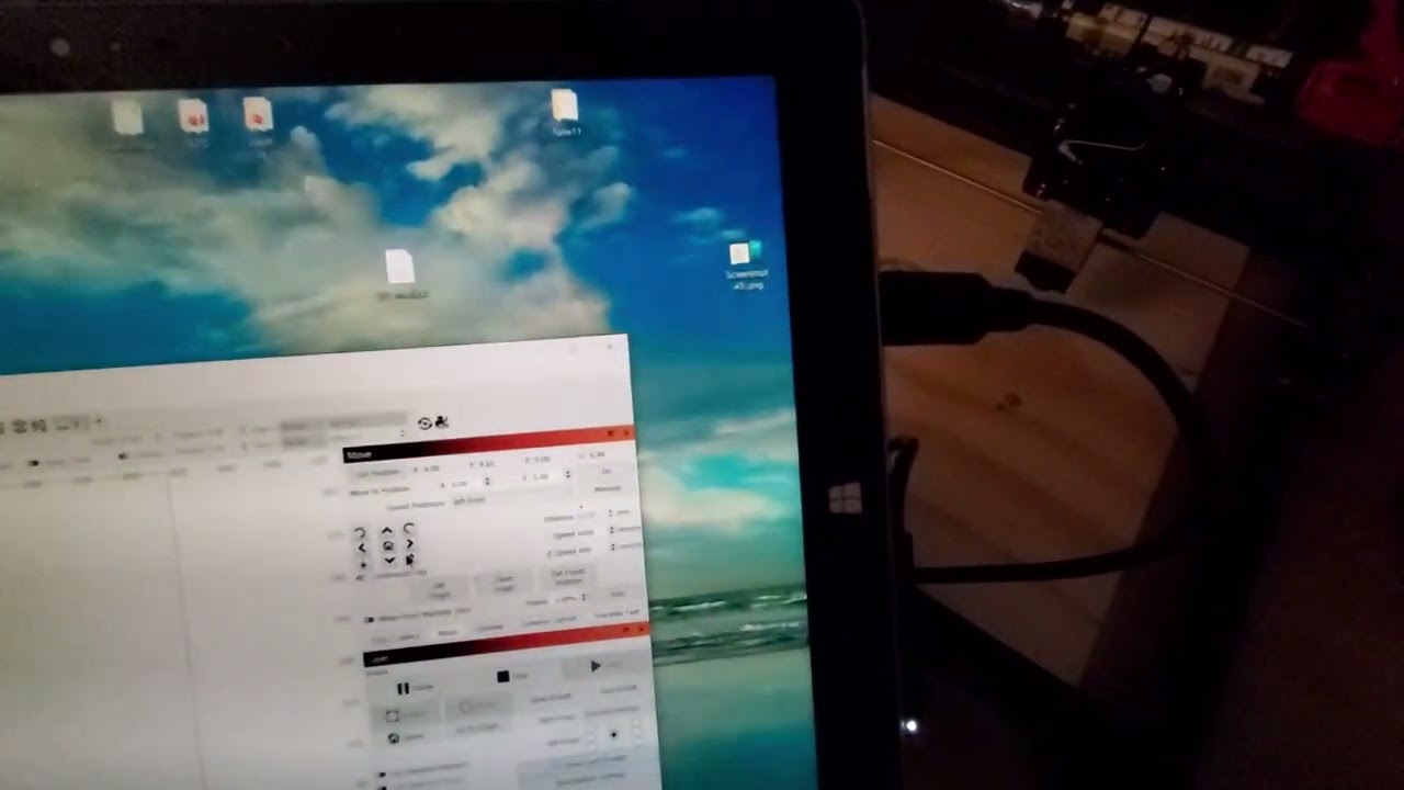

Homing from multiple positions :

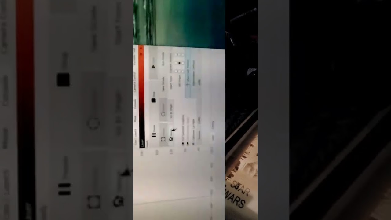

Manualy moving the laser :
Definitly something worn, i never seen the Y axis moving on the same direction with both buttons.
I am suspecting a cable has a micro cut somewhere,
Could i ask 2 things
Unplug X stepper motor → bring X cable to Y axis
Try jogging X axis left and right (will Y move back and forward?)

You just posted the resolution there’s someting wrong with the Y cable after plugging the x axis cable into the y socket the jogger moves up and down (using the left and right arrows). Thank you very much for all your help I’ll open a support ticket and get a new x & y axis cable.
