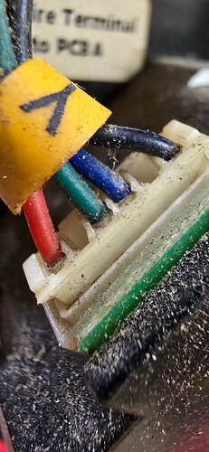

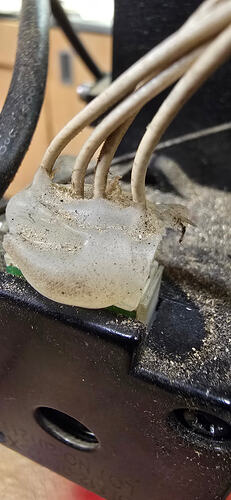

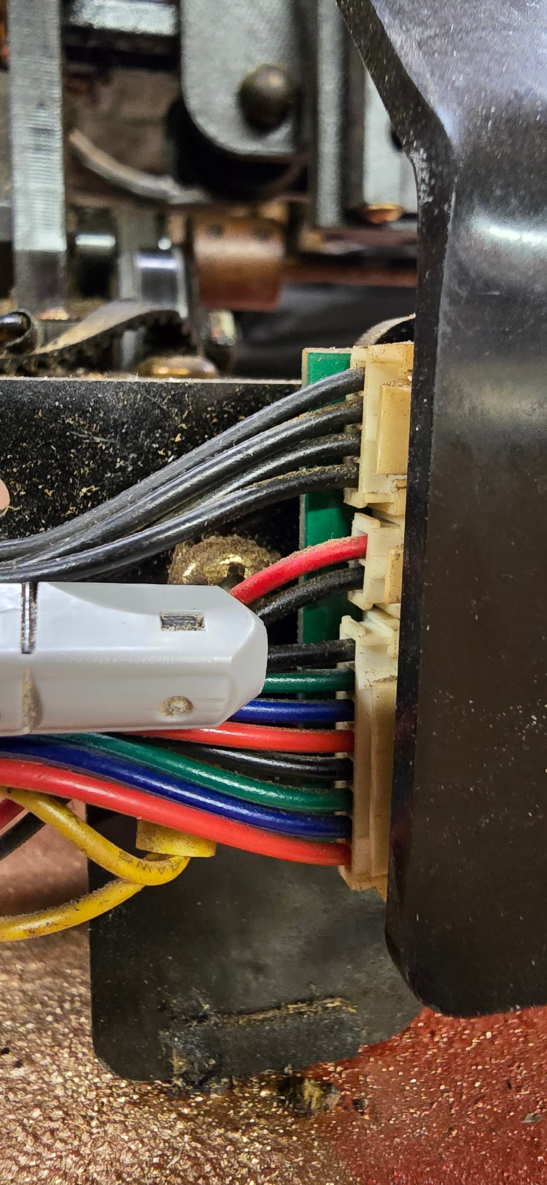

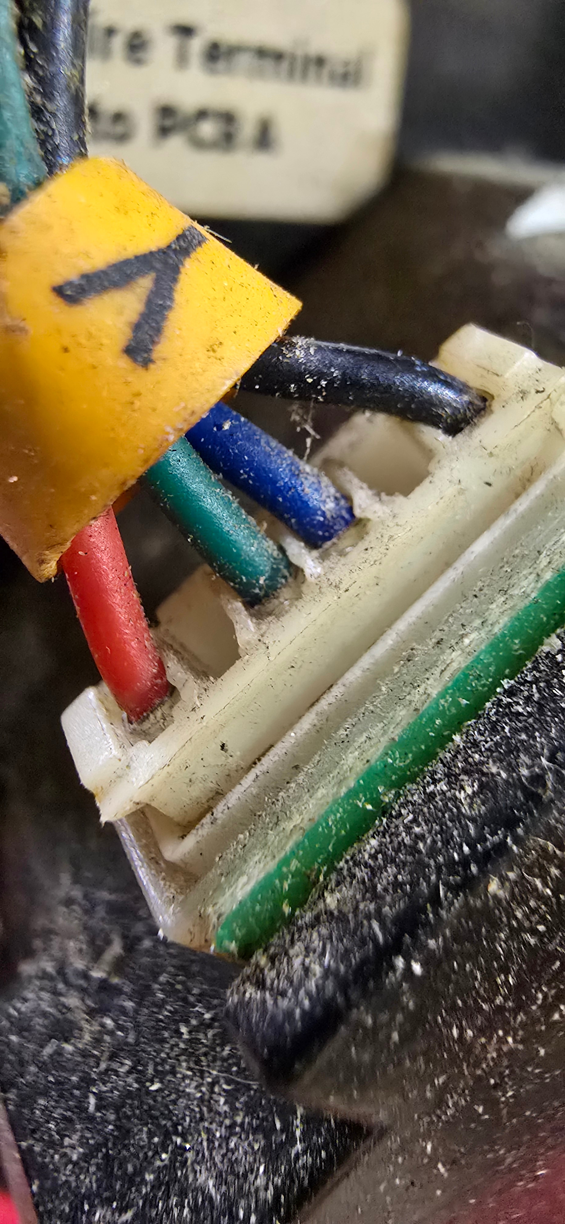

Could you take up close images of the motherboard wiring points, and both motors?
Inspect for a faulty wire or cut wire.
Hm, I’ll try to redo the connection of one of the black wires (think it’s the x axis).
Pictures attached - the connector on the X motor is glued because it got disconnected multiple times while running the machine.
Maybe an additional info - both motors are making this noise. When I disconnect one, the other makes that noise. And the other way around also.

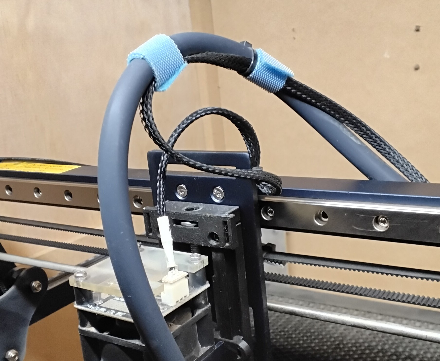

Your video indicates your broken wire issue is a Never Ending Story. With the constant flexing, breaks are guaranteed. Not enough time to do it right, but plenty of time to do it over? This image gives you an idea on how it can be done. You can use inexpensive spiral wrap to minimize the sharp bends.
Thanks. I do have spirals on the cables indeed, but removed them now for inspection. If one “doesn’t know how it should be, he’s not meant to be wrong” :face_with_hand_over_mouth: I got it this way and been using it for years. So thanks, will take this hint. But first need to somehow get it working before :grin:
