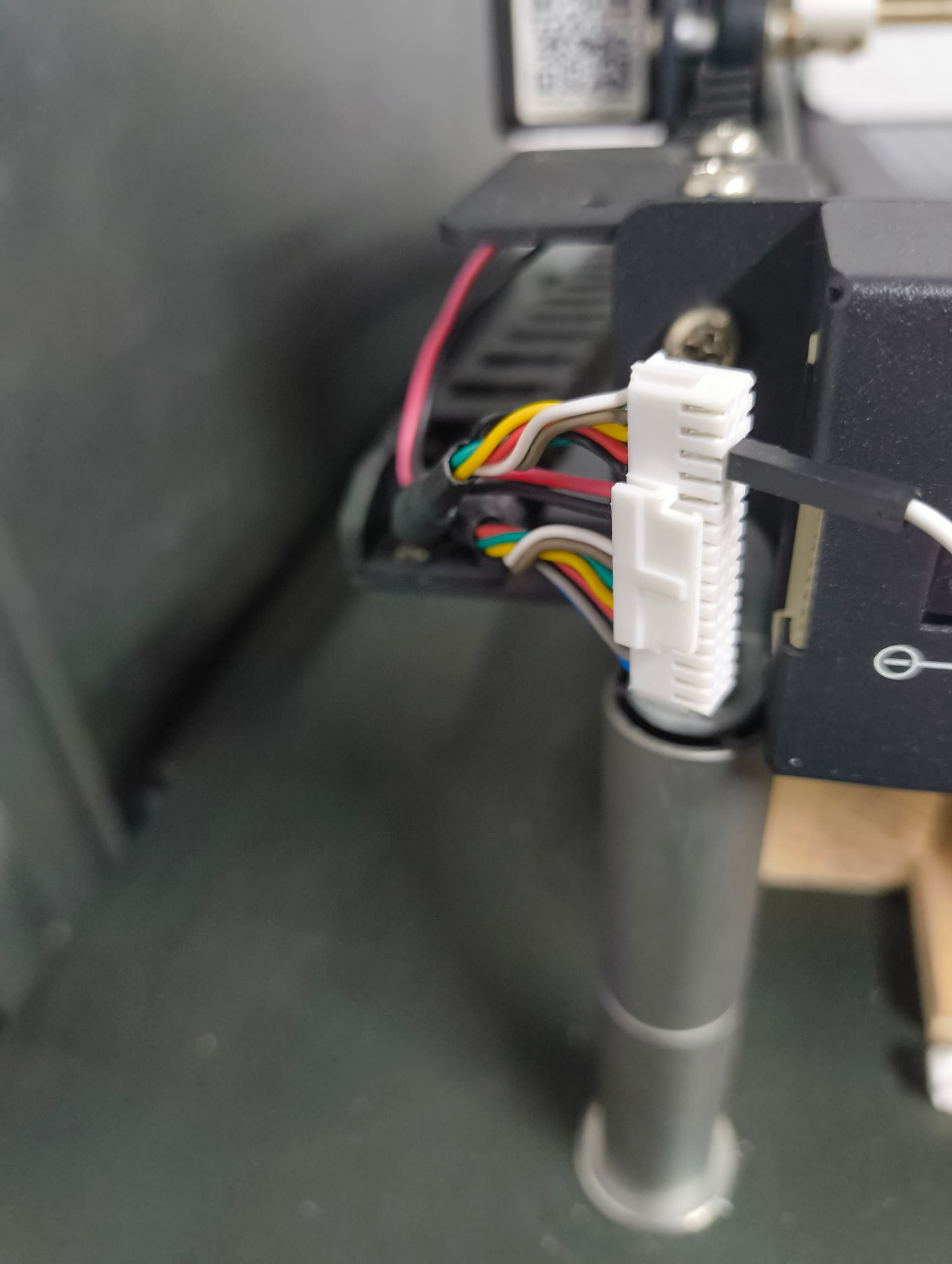

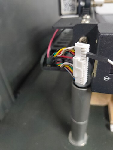

I have an Ortur Laser Master 2 Pro (I believe it’s a S1) with a LU2-4 module. I recently bought an LU2-10A kit to upgrade it.
To my surprise the cables did not fit straight out of the box (I should have done more research).

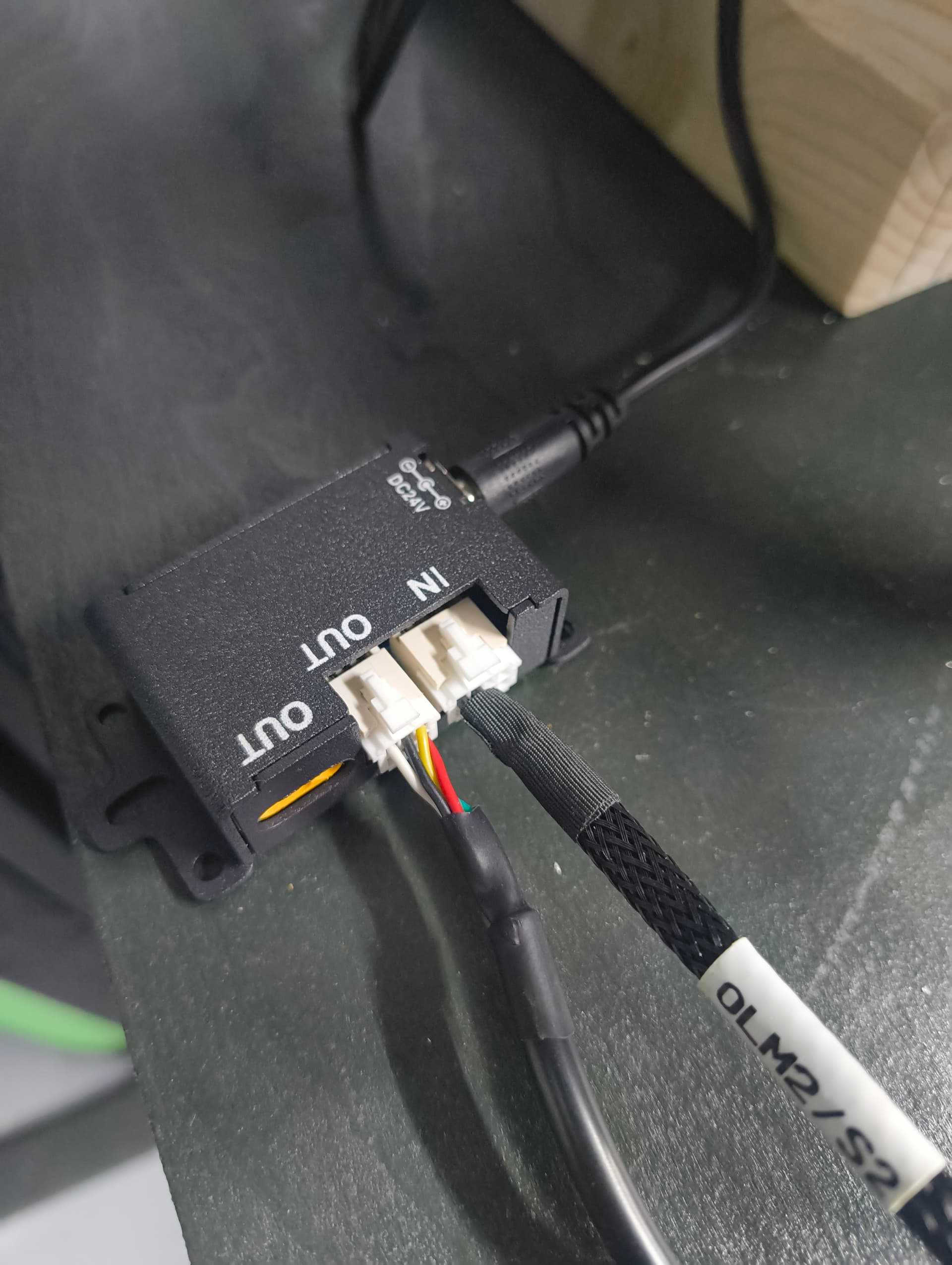

The motherboard is already running on 24V so I connected the PWM cable coming from the motherboard to the OUC v2 that came with the new laser module.
Laser moves as it should but does not fire. I double checked all cables and can’t get it to fire. I then reconnected the old laser but it also not firing, which is strange.

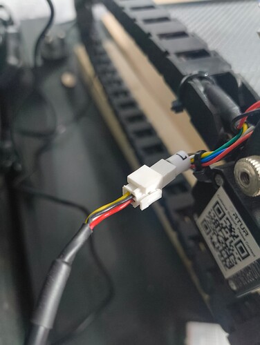

I have checked the original laser connector, black/ red wire is outputting 24.1V.
I have checked the “Out” of the OUC, black/red wire is outputting 23.8V.
The fan on the new laser turns On and the red light on the module is On but it does not fire.
Any idea what other checks I can do and if it’s possible to check the PWM wire?
Well, it sounds like it’s getting power. That would leave the PWM signal. PWM should be between 0V and 5V depending on what percentage of output power you’ve requested, i.e. 2.5V should result in 50% laser power output (this is a rough approximation, YMMV). Based on this ratio, pick a low output power percentage and see what the PWM voltage is. The trick is to do this in as safe a manner as possible. I would search for a post on how to test the PWM voltage vs. power percentage. There should be a way to test this without actually firing up the beam. If there is no PWM voltage, then that would explain why it’s not firing. Hopefully Jack or someone else with a bigger brain than mine will chime in.
I just tested the PWM wire at 50% power and 100% power and both times the multimeter was reading 0V. I guess the issue is somewhere in the motherboard
If I may ask, where did you check the voltage at? I would do a continuity check of the PWM (yellow) wire from the two farthest points, just in case there’s a wiring (or OUC) issue. The first OUC adapter Ortur sent me was bad. Here’s the pinout on the plug.
I checked the voltage on the original 4 pin connector, same connector as the photo in my original post.
I checked for continuity with the multimeter between the large connector at the motherboard and the output pin on the OUC and it’s good.
Based on your thoughtful and thorough troubleshooting, it would appear that something got fried on your controller. Several years ago, I decided to replace the controller on my OLM2 Pro (S1) with an aftermarket one designed and built by Tim Rothman, called the B-N-B 3 (Black-N-Blue 3 GRBL Laser Controller with wifi and sd | LaserUpgrades). The original controller would randomly stop mid engrave (I ruined a lot of tumblers) so I started looking for an alternative. I’ve been running the B-N-B 3 for a couple of years now, and I couldn’t be happier. It has Wi-Fi and an SD card slot, which I found very useful. He makes a number of versions depending on what type of OLM2 Pro you have, and they are running about $132 USD. For me, it was money well spent. Good luck.
