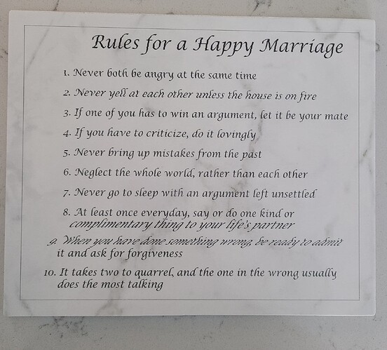

Hello, I have an ORTUR LM2 Pro (24V). The other day I tried to burn an Lightburn job I use regularly and the text became all weird and shaky. I switched to a different font and font size to no avail. I ran another job that I use often and it too produced similar results as in the attachment. I cleaned and oiled the wheels and nothing seems to help. I used compressed air and cleaned the Laser and fan assembly and that did not help either. It may help if you view the attachment and see what Im talking about.
This ORTUR is my 1st laser and I’ve never had any issues with it. I’m wondering if the laser unit or stepper motors (X & Y Axis motors) are going out? I would assume a laser module would just stop working completely, rather than have the shaky font appearance. Any ideas?
There have been no changes to my saved Lightburn jobs or where my laser is set up. It is not on my washing machine during the spin cycle, although it does appear that way. I also tried a brand new text and it did the same thing.
Thanks in advance. Well wishes out to you all @ Lightburn
This is a mechanical problem.
Notice how the numbers, which should be aligned vertically, drift leftward after each garbled line. That says the machine is losing its mechanical position; the controller does not get feedback of the actual position and cannot correct this.
Although this guide is for Sculpfun lasers, it should give you a good idea of where the problem lies:
Follow all the steps, carefully check everything, and you’ll figure out what just worked loose.
