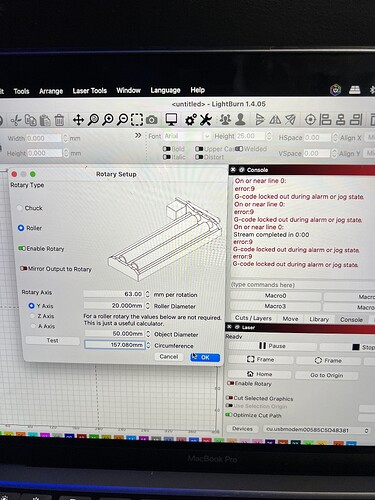

I go to the Laser tools tab and select rotary setup
I made sure Rotary type is set to Roller
Enable Rotary is on
Y Axis is selected mirror output is off
In Rotary Axis I have set 63.00 mm per rotation
Roller Diameter is set to 20.000 mm
(as per the Instructions included with the YRR 2.0
I inputed the object diameter at 72.760 mm
The software calculated and input a circumference of 228.582mm
If I hit the “Test” button nothing happens mechanically and I get the error 9 message

I also made the changes you stated in machine settings (Remove DTR” and have the screen pic for you in addition I also made changes on the Rotary tool to coincide with my setup and took a picture for you per your instructions.
If I select test I am getting the same error code.

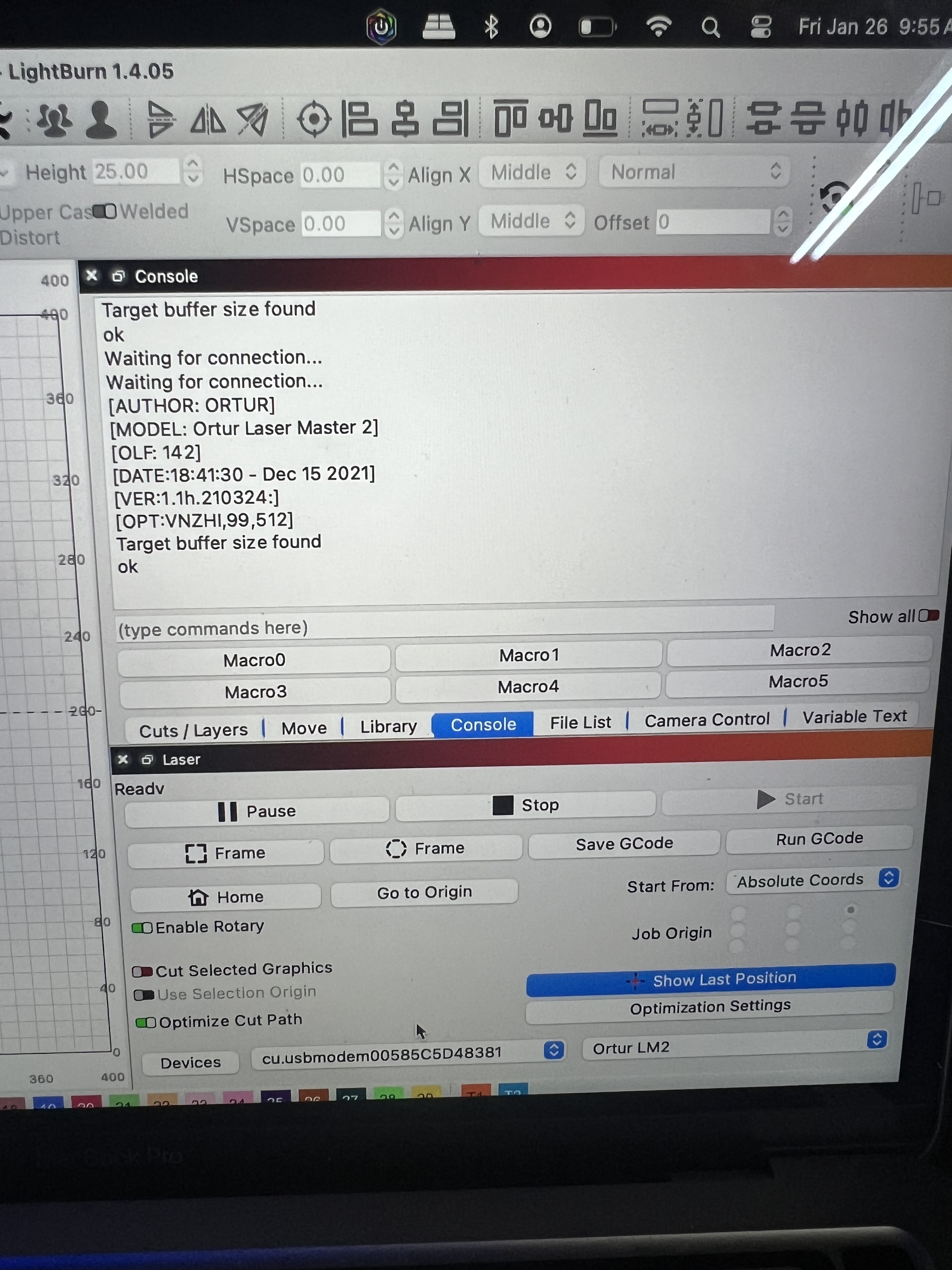

Shut down power to the laser hardware and closed Lightburn then turned the laser hardware back on and relaunched Lightburn
The hardware was immediately auto detected in the devices window and in the console window it showed proper communication and a ok status.
I decided to test via making a simple vertical rectangle then under cuts and layers setting speed and power 1000 and 20 then in the laser window choosing “Start”
Nothing happens
In the console window this what results:
Waiting for connection…
[AUTHOR: ORTUR]
[MODEL: Ortur Laser Master 2]
[OLF: 142]
[DATE:18:41:30 - Dec 15 2021]
[VER:1.1h.210324:]
[OPT:VNZHI,99,512]
Target buffer size found
ok
<Alarm|MPos:0.000,0.000,0.000|Bf:99,511|FS:0,0|Pn:P|WCO:0.000,0.000,0.000>
ok
Starting stream
error:9
G-code locked out during alarm or jog state.
On or near line 0:
error:9
On or near line 0:
error:9
On or near line 0:
error:9
On or near line 0:
error:9
On or near line 0:
Stream completed in 0:00
error:9
error:9
This is the alarm state that’s being complained about.
