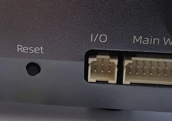

I’m looking ahead to a new laser, and the OLM3 is looking pretty promising. One puzzle, however is about the I/O port on the machine. Ortur uses that port to run an exaust fan and a light in their proprietary enclosure.
Since the fan and light seem to otherwise run off a simple switched 12VDC power supply, is this really an input/output port, or is it simply a power port that is switched by the main board? If it is just 12VDC coming off the main board, it can’t supply much power unless there is some additional circuitry and possibly heat sinks on that mainboard. Also, from the pictures I’ve been able to find, I can’t tell exactly how many connector pins are being used in the I/O port. In some pix, it looks like 3, while in other pix it almost looks like more pins. It’s very confusing, and Ortur seems to have exactly zero documentation about this port, other than their instructions to plug the fan and light wires to this port.

When you look at the I/O port with the reset button on the left, you should have this pinout:
Then you can send M12, M13, M14 and M15 command to change the state of the pins 1 and 6.
Ortur doc says that:
But on my notes I wrote that behavior of these commands is reversed for my OLM3 compared to how Ortur described them, so to be checked on your side.
I also wrote that:
M12, M14 commands make the corresponding pin (1 or 6) voltage switch from 14V to 0V
M13, M15 commands make the corresponding pin (1 or 6) voltage switch from 0V to 14V
And as you said already , I also think you cannot draw too many power from this I/O port.

At least we know of two outputs that have the potential of being used to switch relays for external devices like lights, exhaust fans, and air assist. Although Ortur offers the first two of these with their proprietary enclosure, I consider that lighting and exhaust system to be barely adequate. If I do go ahead to get the LM3, one of the first things I will be doing is to cobble together a control box to switch a better light, and to simultaneously switch both the exhaust fan and the air-assist; an easy thing to do with 2 or 3 common 12VDC-120VAC relays. Hopefully I can locate an appropriate connector to mate with the I/O port.
That port is still a bit of a puzzle… it makes one wonder what future plans Ortur has for that port, and what power load those two 24V pins might be able to support.
In case you decide to go with the OLM3, if one day you find the exact connector name that properly plugs into this I/O port, I am interested :slight_smile:
The only solution I found was to open the aluminium frame (it is easy to do) and remove the connector to solder something else (wires or other connector). But I did not do this as I did not want to void the warranty.

Thanks for this topic - I have NOT connected the wiring up, but did find the connectors to use that would operate a SS relay to activate the air pump.
These are the cables I ordered from www.aliexpress.com ( https://tinyurl.com/msxbphsh ) select the 2X3 pin connector to have the 6 pins.

But I’ve been anwered “we are unable to provide any further information regarding this interface, the engineer has left the company.”
So I’ll have to do with what aureliend2000 provided.
Hopefully as the Ortur Enclosure 2.0 uses this interface, the support of the feature will be continued.
It drives a 6W led strip and an extraction fan.
=> So it’s safe to drive a SSR relay (2mA) or a 12V pneumatic valve (5W => 400mA).
