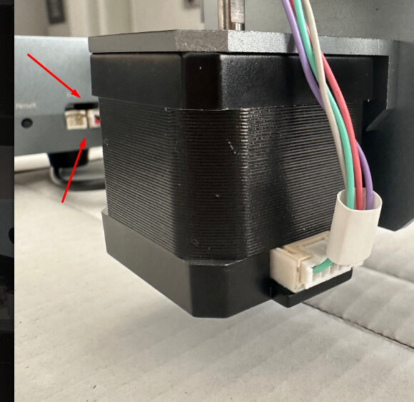

you are missing a phase on your X

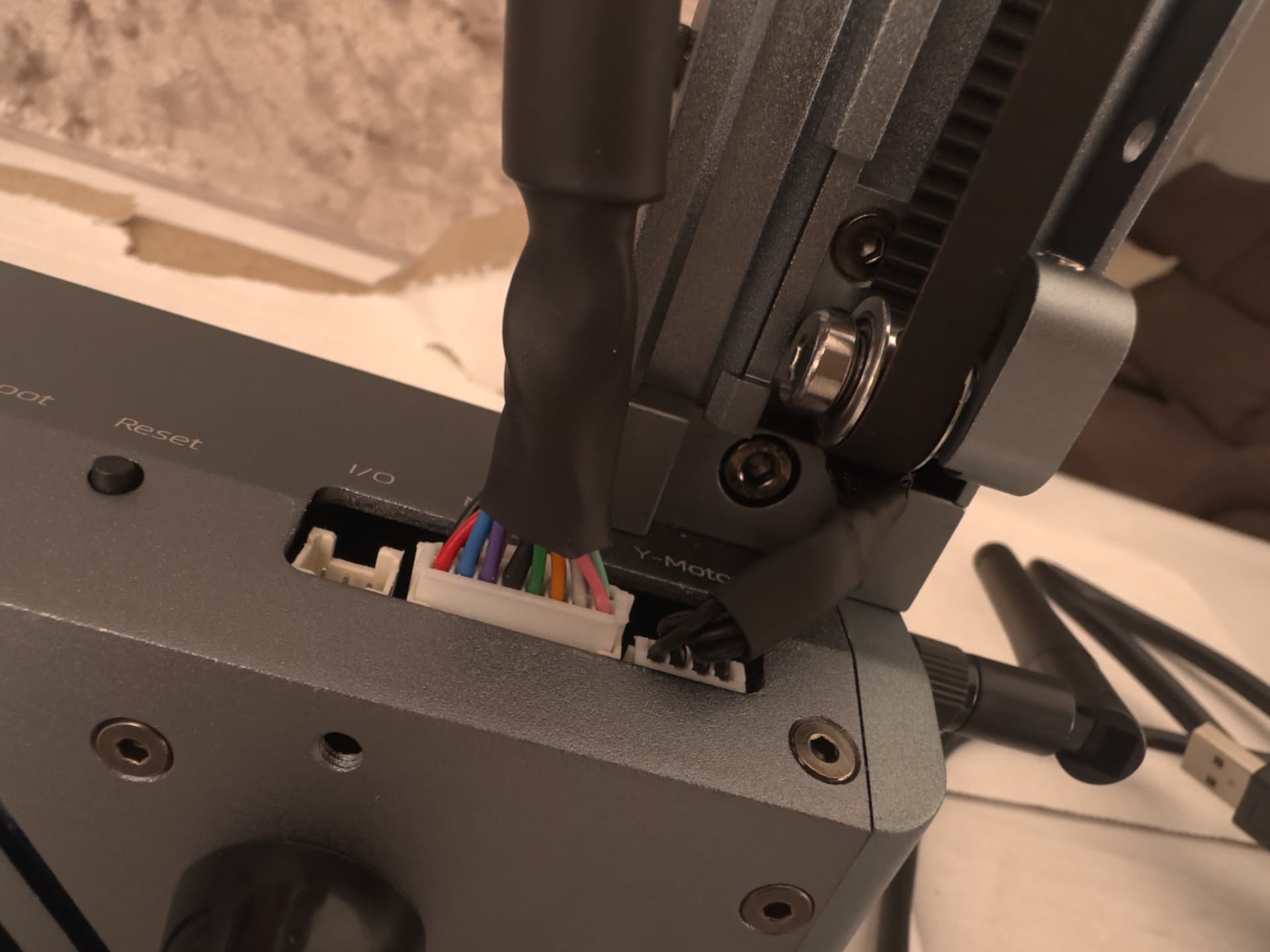

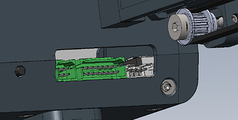

Can you send a upclose image of your motherboard connector, with and without main harness plugged in?
Where exactly is it?

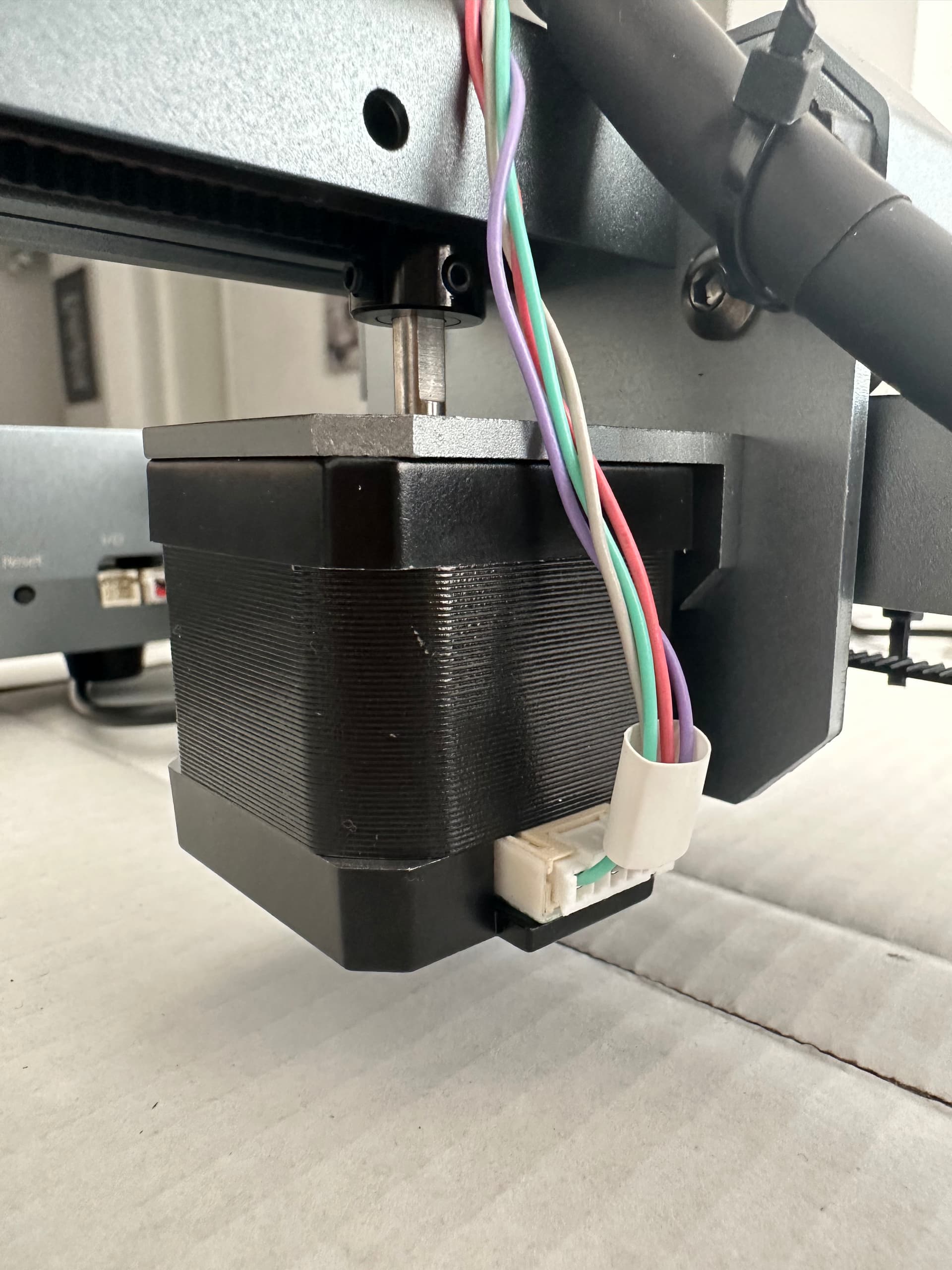

All looks perfect. Let me ask please

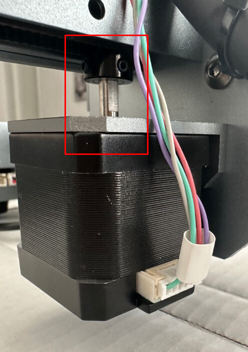

I cant be certain but did you check if the sproket, the black pulley that moves the belt
is fuly tighten to the shaft?
check the 2 little screw and see if you can tighten them more

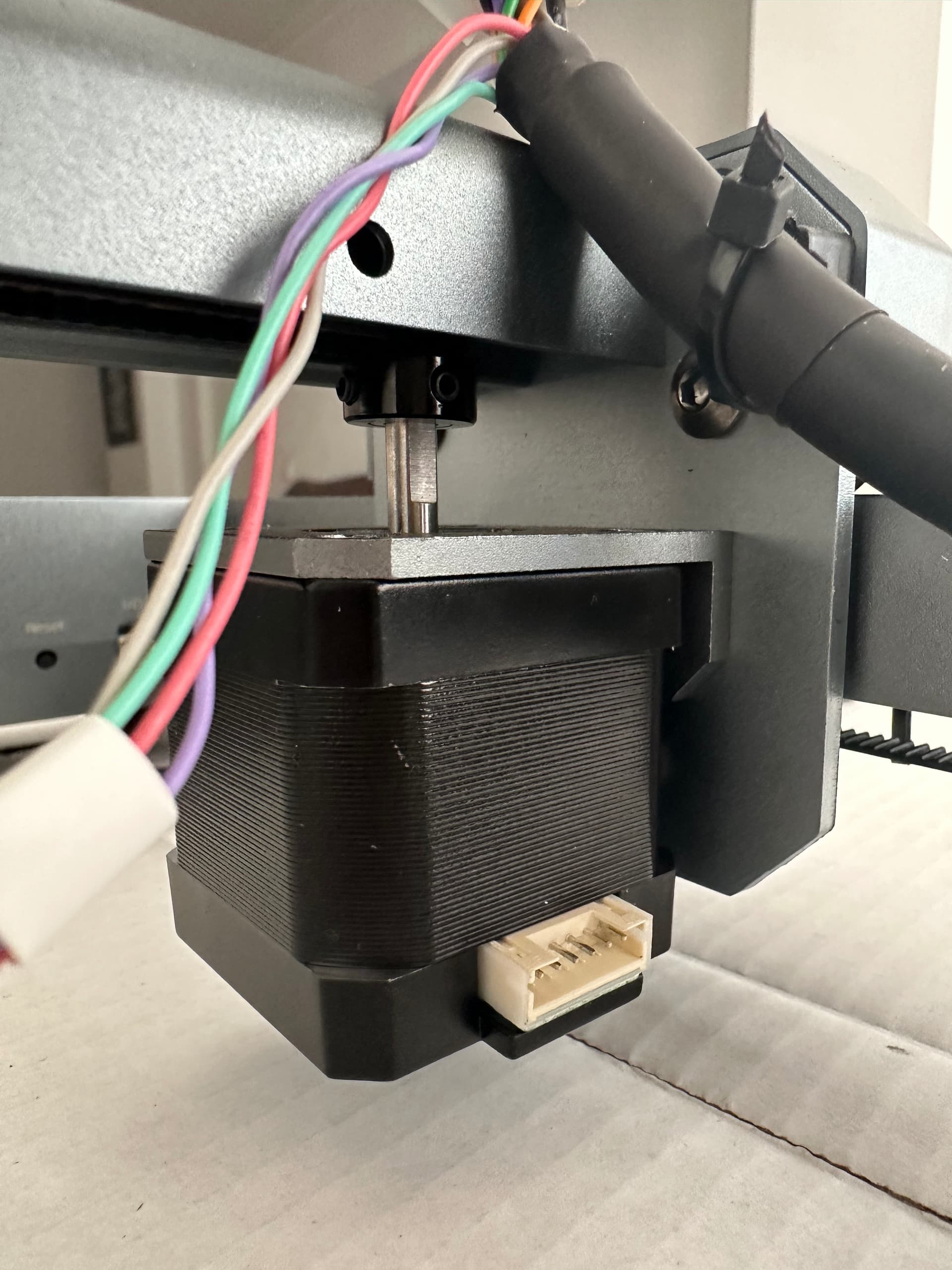

Alternativly, if you have your YRR cable. CAn you move X back a bit
Plug YRR cable to the back port, and to the motor X
then switch /YRR/Ymotor swith to YRR and try moving Y instead of X please
same issue happens?
