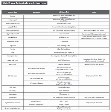

Is the blue light steady, or blinking?
It might want to tell us something. Blinking blue twice would indicate a “Motor Drive”, for example:
From the Manual :
