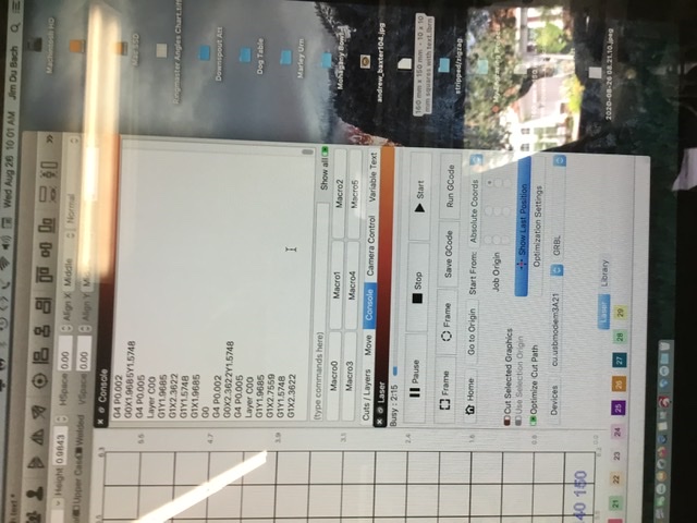

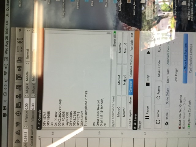

Ok, I turned on debug and ran a project. It stopped about half way. Attached is a couple Picts of the console. The first is when it stopped. The second is when I clicked stop.

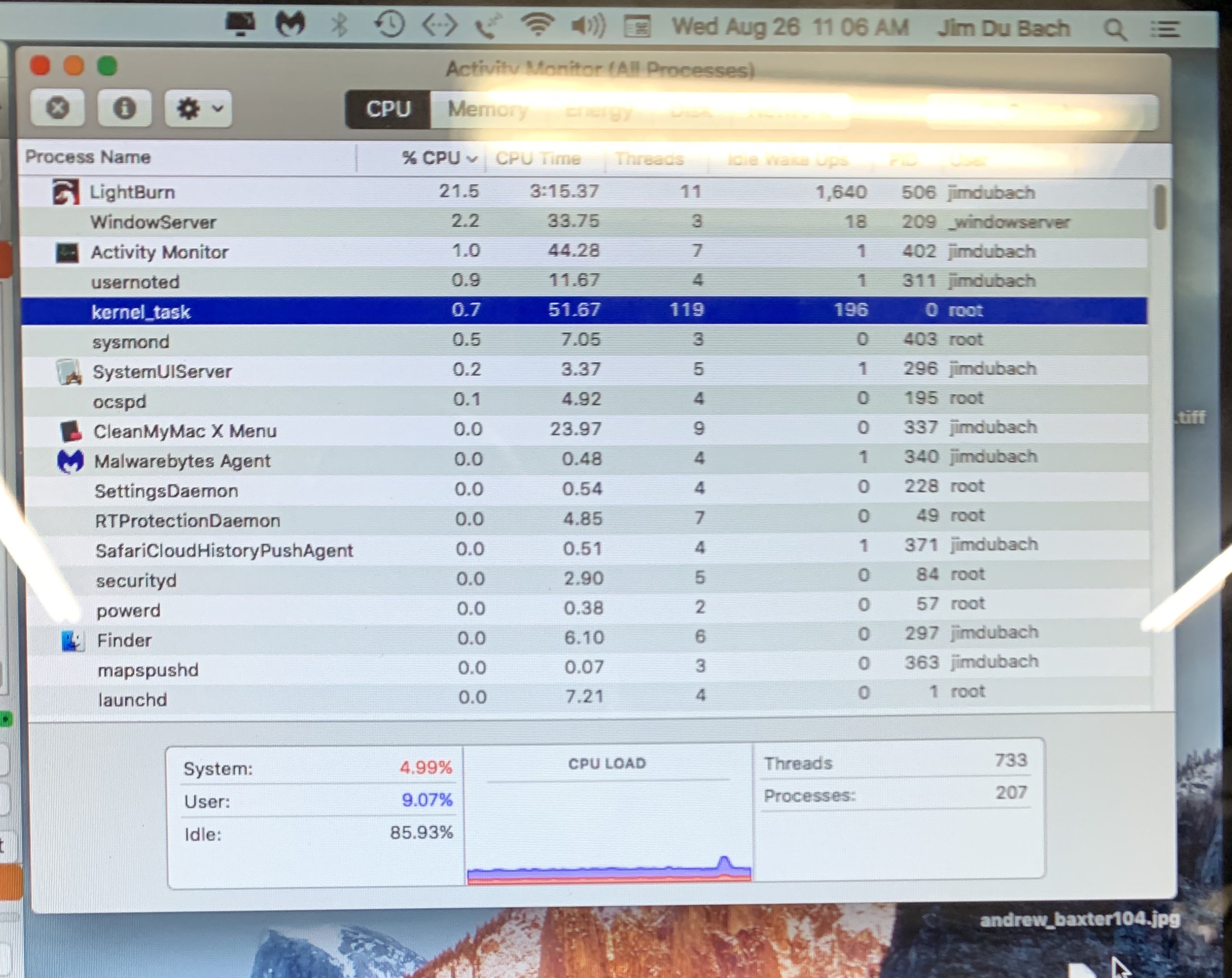

Ok, just tried another burn and stopped. Attached is a pict of the console and Mac activity monitor after it stopped. Hope this helps!

If it just says, “Stream completed in…” at the end, with nothing else after that, it’s likely that the USB connection was interrupted. That suggests a loose cable, connection, or electrical interference.
That’s was after I clicked stop. Before that it was streaming.

When it stops, it does not say “Stream complete in…”. In the attached pict you’ll see in the console that it continues to stream and it will continue until I click “STOP”. When I ry to "PAUSE and “RESUME” it starts, but sometimes only for a few seconds then stops. New 6 ft USB cable with gold fittings.

Also in earlier post I attached the Mac Activity Monitor showing the CPU activity during the burn. Did you see that?

I think LightBurn/ OZ gave up on me. I want to provide more info like the “debug” info if someone at LB would tell me what I should do after turning on “debug”. After I did the debug I see no file to send. I also earlier uploaded a photo of the CPU MONITOR as the file was running. Do you see anything there that’s a problem?
