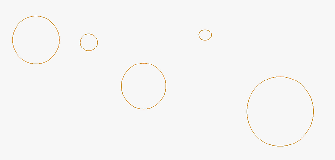

An example of how to make 6 successive passes:
Here I have made 5 shapes using the C00 layer with appropriate settings for a single pass.
I then:
  • selected all 5 shapes
  • CTRL+D (duplicate)
  • click layer 01
  • click layer 02
  • click layer 03
  • click layer 04
  • click layer 05
  • In the Cuts / Layers pane select C00, then click to copy the selected cut setting into the cache
  • select C01, then click to apply the caches cut setting to the selected cut layer
  • select C02, then click to apply the caches cut setting to the selected cut layer
  • select C03, then click to apply the caches cut setting to the selected cut layer
  • select C04, then click to apply the caches cut setting to the selected cut layer
  • select C05, then click to apply the caches cut setting to the selected cut layer
  • set optimization settings’ top criteria to order by layer

Method two / Option two:
(an example for 3 passes this time)
Here I have made 5 shapes using the C00 layer with appropriate settings for a single pass:
I then
  • CTRL+D to duplicate this grouping (once)
  • CTRL+D to duplicate this grouping (twice)
  • set optimization settings to order by group and be sure that you do not have remove overlapping lines enabled
