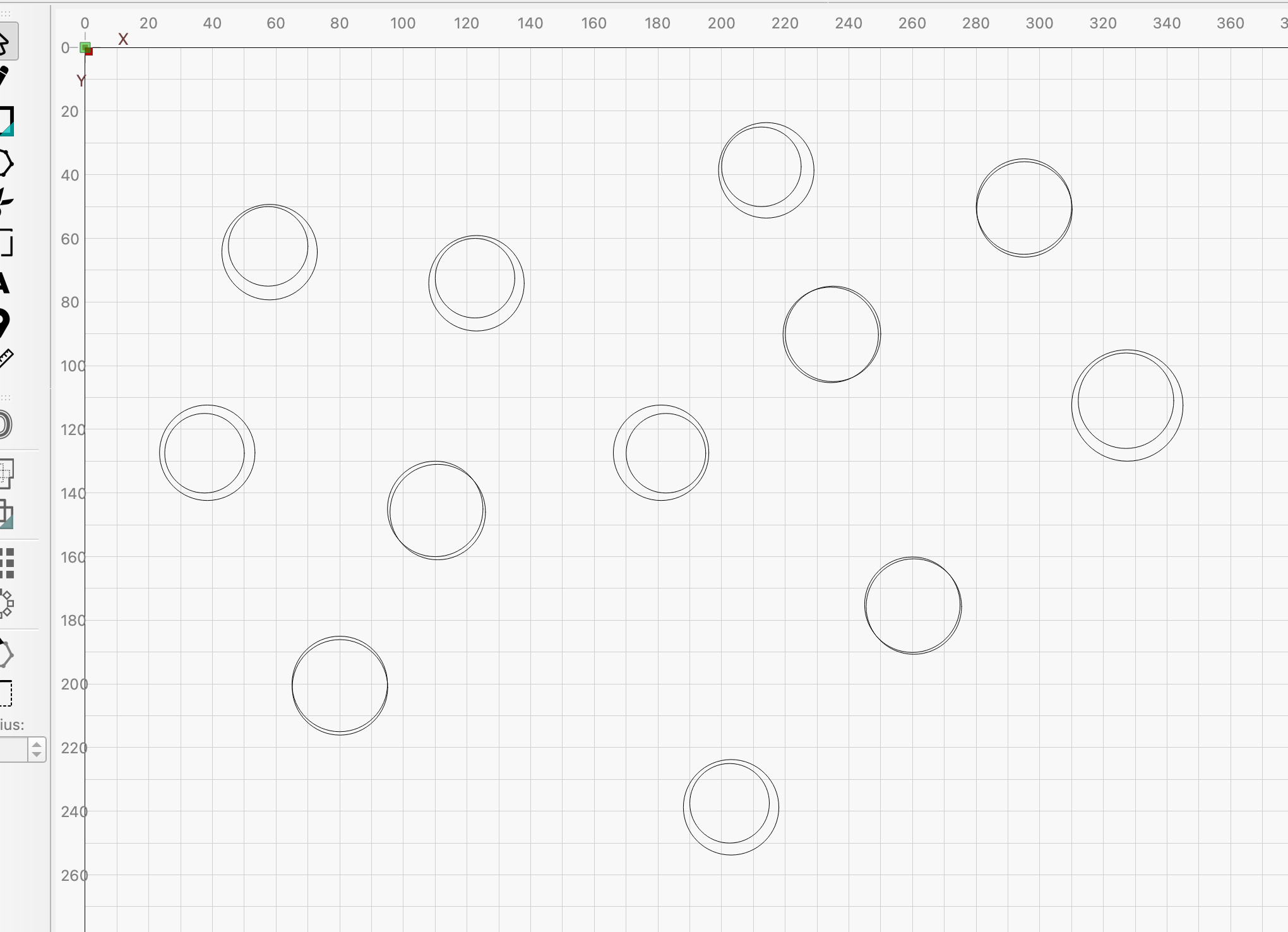

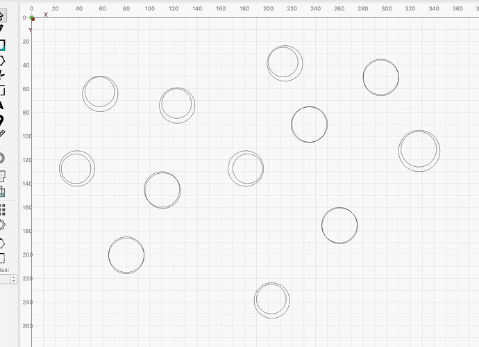

I had a small job yesterday to put 5mm circles on the center of other shapes, the mouse cursor transforms into the center indicator, correctly, but “cmt+V” does not insert in the center of the selected object. That is, I had to realign 60pcs. Ø5mm on the existing shapes. (It is snap-tolerance independent)
It is just a little irritating and does not fit the overall image of the LightBurn presentation.
In the video you can see a small example

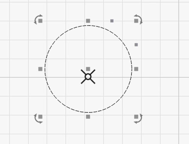

I agree that it is to be expected that Ctrl-V pasted with the geometrical center exactly at the center of the hovered-over shape (rectangle in the middle) if the snapping distance is large enough so that the mouse pointer shows this Center icon
Instead, Ctrl-V pastes the design in the center of the mouse cursor. (Or at the tip of the mouse pointer)
Also indicated by the mouse location in the statusbar here:

This is the result, “paste” after the cursor shows the middle. Snap Tolerance is 5 pixels… Something is not optimal.
On the other hand, when the mouse cursor is not on the workarea, it pastes in the center of the view.
We don’t specifically test for snapping when pasting.
So far, we agree that if the mouse is at a snap point, it would be reasonable to snap the paste.
Depending on the zoom level of the workspace, the 5 pixels of the snapping distance make for a larger distance.
