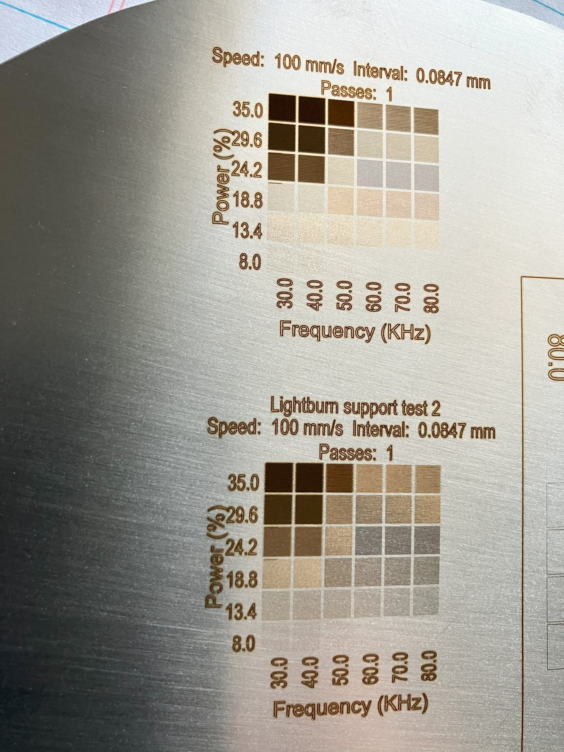

Photo engraving on stainless steel in grayscale

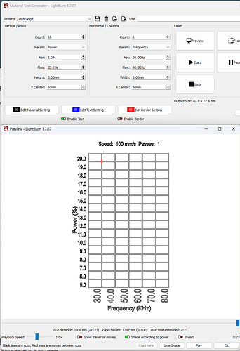

Keep the speed at 100mm/s, then run a material test varying only power 5-20%, and frequency 30-80 if that is your range.

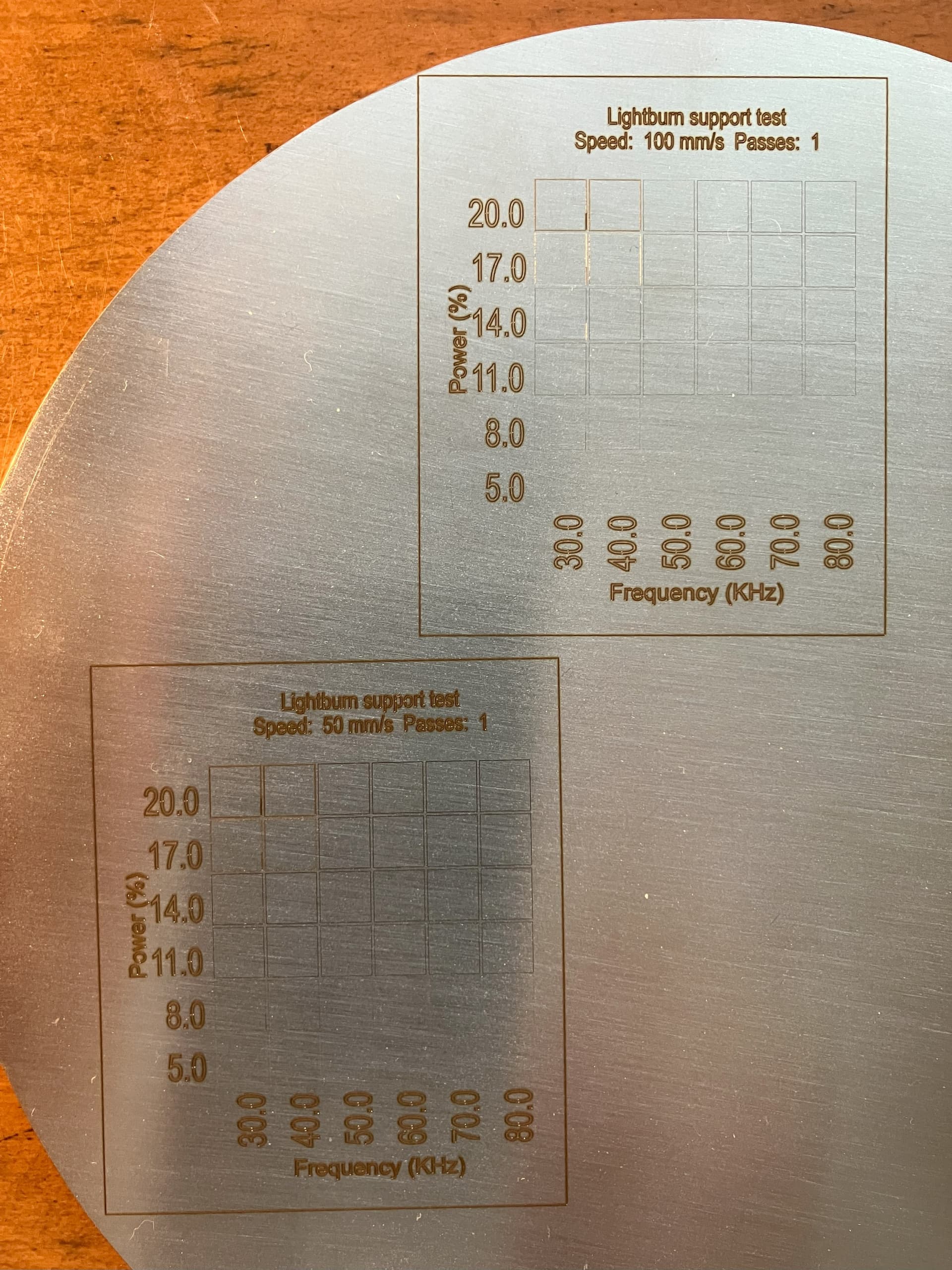

What do you see?

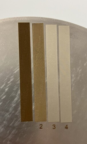

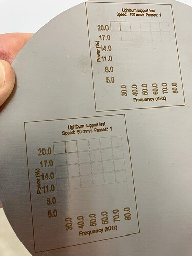

Hi Nicholas. The first test was very light, it didn’t even score the material. So I ran it again at 50 mm/sec and it looks just like the first test!
Attached is another test that I did previously at 60 Hz.
Please ā€˜Edit Material Setting’ for the material test and change the mode from ā€˜Line’ to ā€˜Fill’ @ 300dpi and run again so the squares are properly filled in.
If you change the ā€˜Height’ of the Rows to just 3mm it will take up less space and turn off ā€˜Enable Border’.
But looking at the results I can see…maybe try that test image again with something like:
100mm/s
80kHz
Min 8%
Max 35%
Run it normally once, and a second time as a ā€˜Negative Image’.
The test looks good but (1) I did not see a dpi setting so I set the lines per inch to 300; (2) the only place I could find ā€œinvertā€ was in the preview window, however that did not work as both tests look the same.

It almost looks like the 18.8% power @40kHz is lighter looking than the 13.4% ?
If that is the case, try the test gradient image I sent you with grayscale settings of:
100mm/s
40kHz
Min 19%
Max 35%
Line interval 0.0847 (and try another at 0.1mm)
Hi Nicholas. Ran these this morning. No shading whatsoever. Test 3 is line interval 0.0847 and test 4 is 0.1mm. Thanks

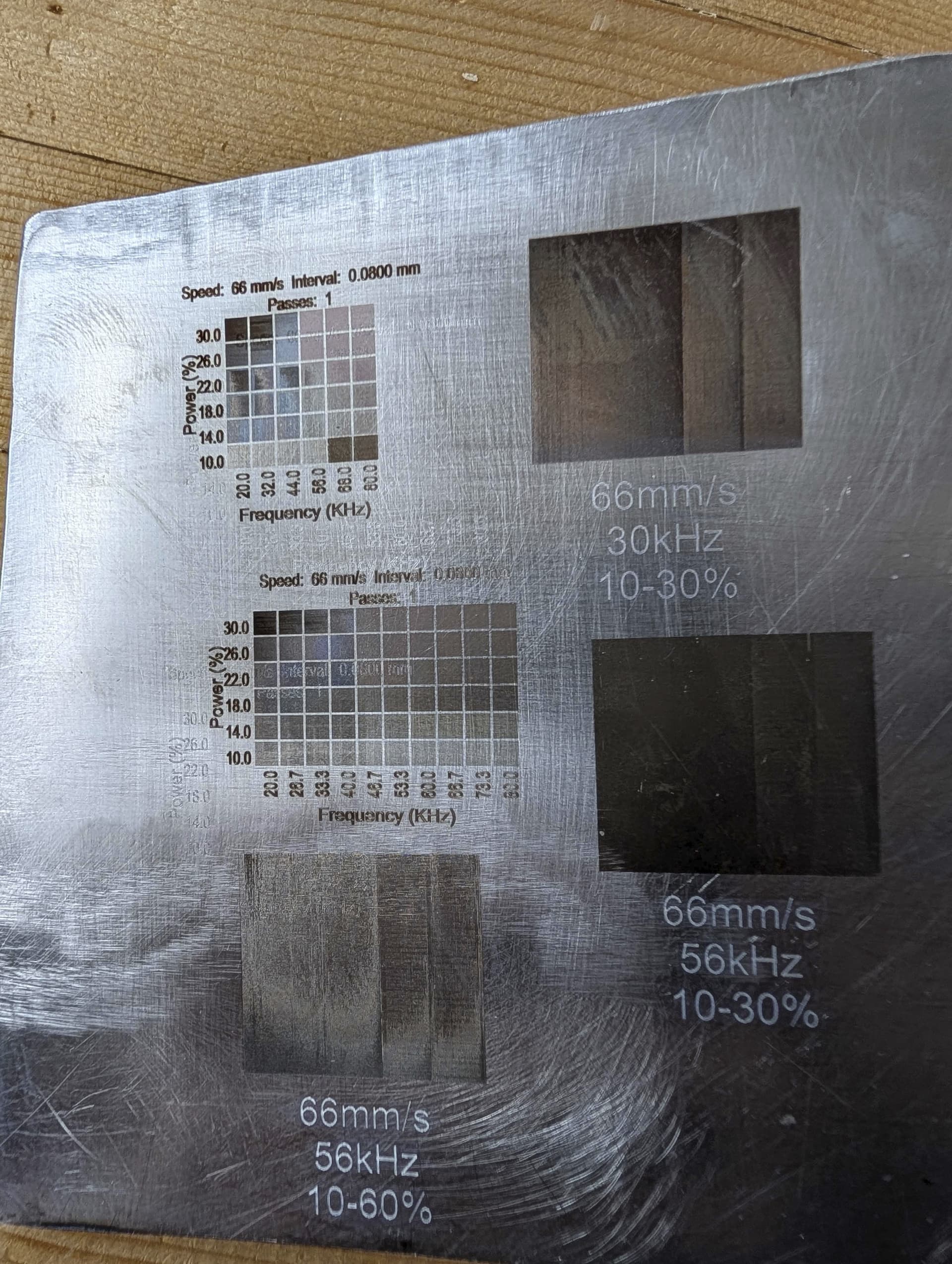

Here’s a picture of a Material Test with the settings @NicholasL suggested. It does cover a useful range.
But see this oddity with the power being stronger at some lower values:

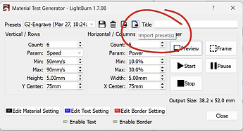

You can import this Material Test preset if you rename this .txt file to .lbmt
G2-Engrave-Stainless.txt (1.3 KB)
I ran a few other Material Tests and tried the the grayscale mode.
There is a very slight shading visible but couldn’t get anywhere near to Nicolas’ results.

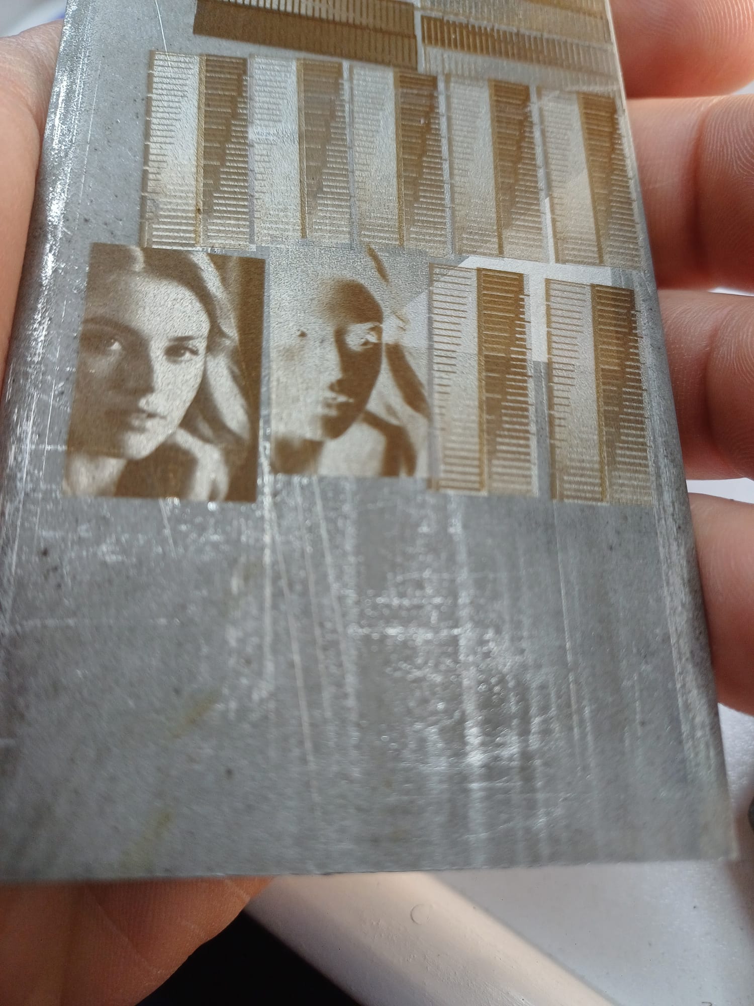

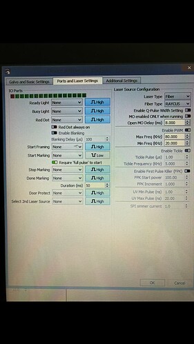

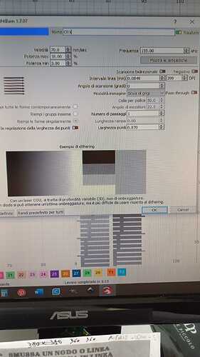

SALVE HO SEGUITO QUESTA DISCUSSIONE e anche io ho un 30w fibra non mopa e con la scala di grigio avevo lo stesso problema sig Geraldz ma grazie al test che ho scaricato sono riuscito ad ottenera un buon risultato , tanto materiale di consumo , ma alla fine sono soddisfatto allego foto e parametri per condividerli, non capisco perche tanti non divulgono i parametri
HELLO I FOLLOWED THIS DISCUSSION and I also have a 30w non-mopa fiber and with the gray scale I had the same problem Mr Geraldz but thanks to the test I downloaded I managed to get a good result, a lot of consumables, but in the end I am satisfied I attach photos and parameters to share them, I don’t understand why many do not disclose the parameters
Hi @giopicc . I was excited to see your success. Unfortunately this does not work with my G2 PRO 30 watt because the frequency only goes up to 80 kHz
mi dispiace ho cercato di aiutarti comunque la HZ deve stare alta per scala di grigi
@giopicc Thank you for sharing your results. Which Galvo did you use? It’s likely an EZCAD2 machine and not using a BSL controller.
@geraldz The grayscale mode also works below 80 kHz. The reason it’s not working is because of the BSL controller the G2 Pro is using.
