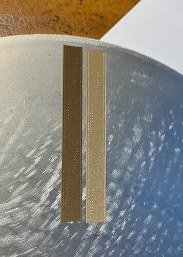

New Lightburn user here and 1st post! I have a Gweike G2 30 watt and want to engrave grayscale photos on stainless steel in Lightburn. I was able to do this on my old 5w diode laser running GRBL; and the Glaser software that came with my Gweike machine does a pretty good job although it has it’s limitations.
I have tried literally a hundred different combination of settings in Lightburn and cannot get the grayscale mode to work! It prints just fine in modes such as stucki and jarvis. Also prints in “passthru” mode but this results in just black/white with no shades of grey. I would really like to get the grayscale mode to work. Has anybody had any success with grayscale on stainless?
Please see the attached picture. I start with a background pass as a white background 835 mm/sec, 63.3 power, 60 Hz. I have tried all sorts of different settings, different images, etc and grayscale just looks awful.

Try lowering the DPI, start at around 255, 1200 may be too small and you are overlapping your lines and you just get mud…

Is your speed a bit quick, have you tried 100 to 150mm/sec?
Have you tried power as low as 30% to 50%?

Hi Nicholas. Thanks for the file. I ran it twice, first with your exact settings (left side). Since it turned out black I ran it again with the speed increased to 200 mm/sec. As you can see there is no shading. Thanks for looking into this!
Doubling the speed was a bit dramatic. You went from too much to not enough. I would try maybe 120, 140, 160, and 180mm/s to see if there is a middle ground.
