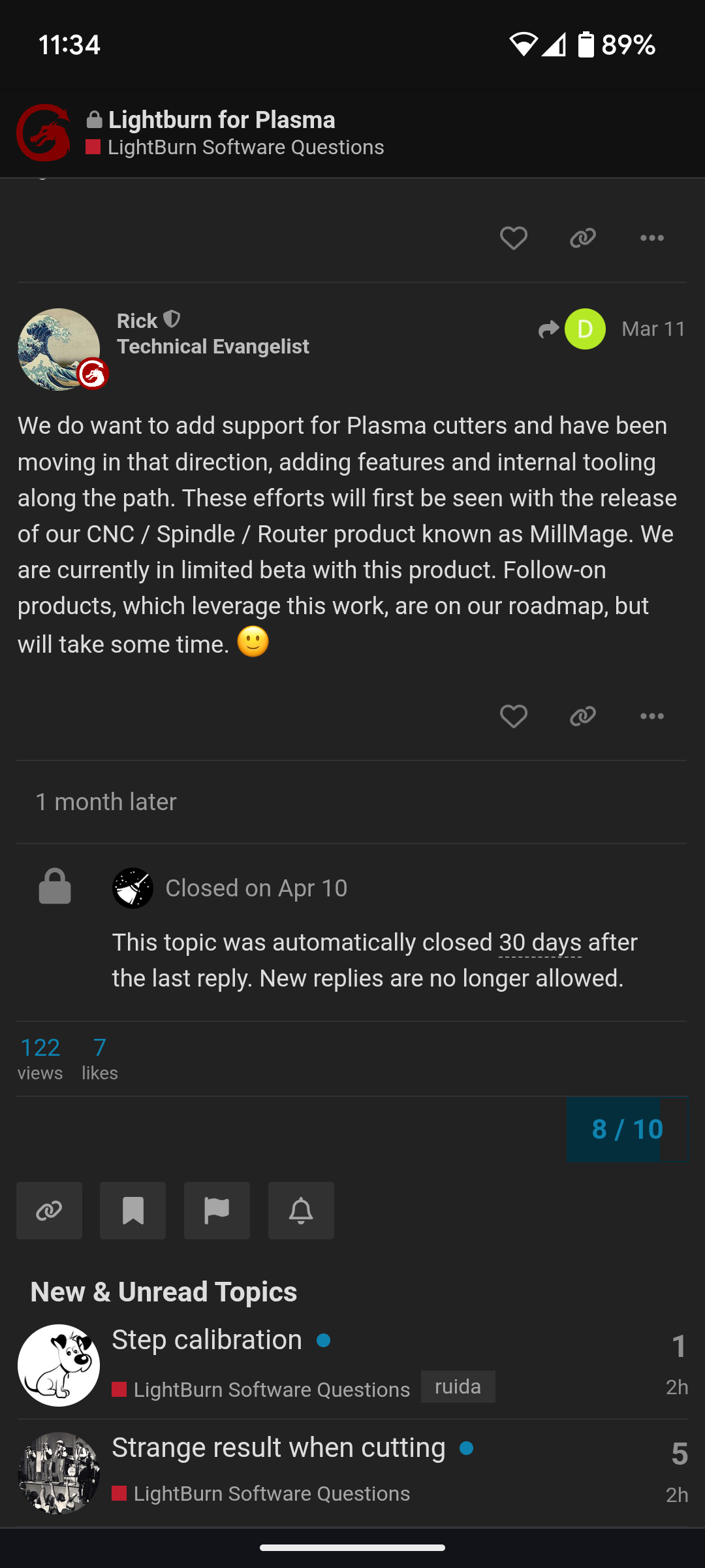

Interesting. Plasma support was mentioned many times when Millmage was talked about.
So now you’re saying Millmage will never do plasma and another software will be made specifically for plasma? Or we’ll just have to wait for plasma support to be added to Millmage?
MillMage is for spinning tools, LightBurn is for lasers, and can be made to work with Plasmas via Custom GCode. We do not have a software package for Plasma at this time. MillMage is not that software. I’d be eager to see where plasma support was mentioned, because it’s never been the case for MillMage, it’s always been intended for spinning tools.

Not gonna go searching for all the posts about it but I’ll post this one because it’s mine.
Note the last post.

For reference, here is his latest, from a March 10th post in response to you.
