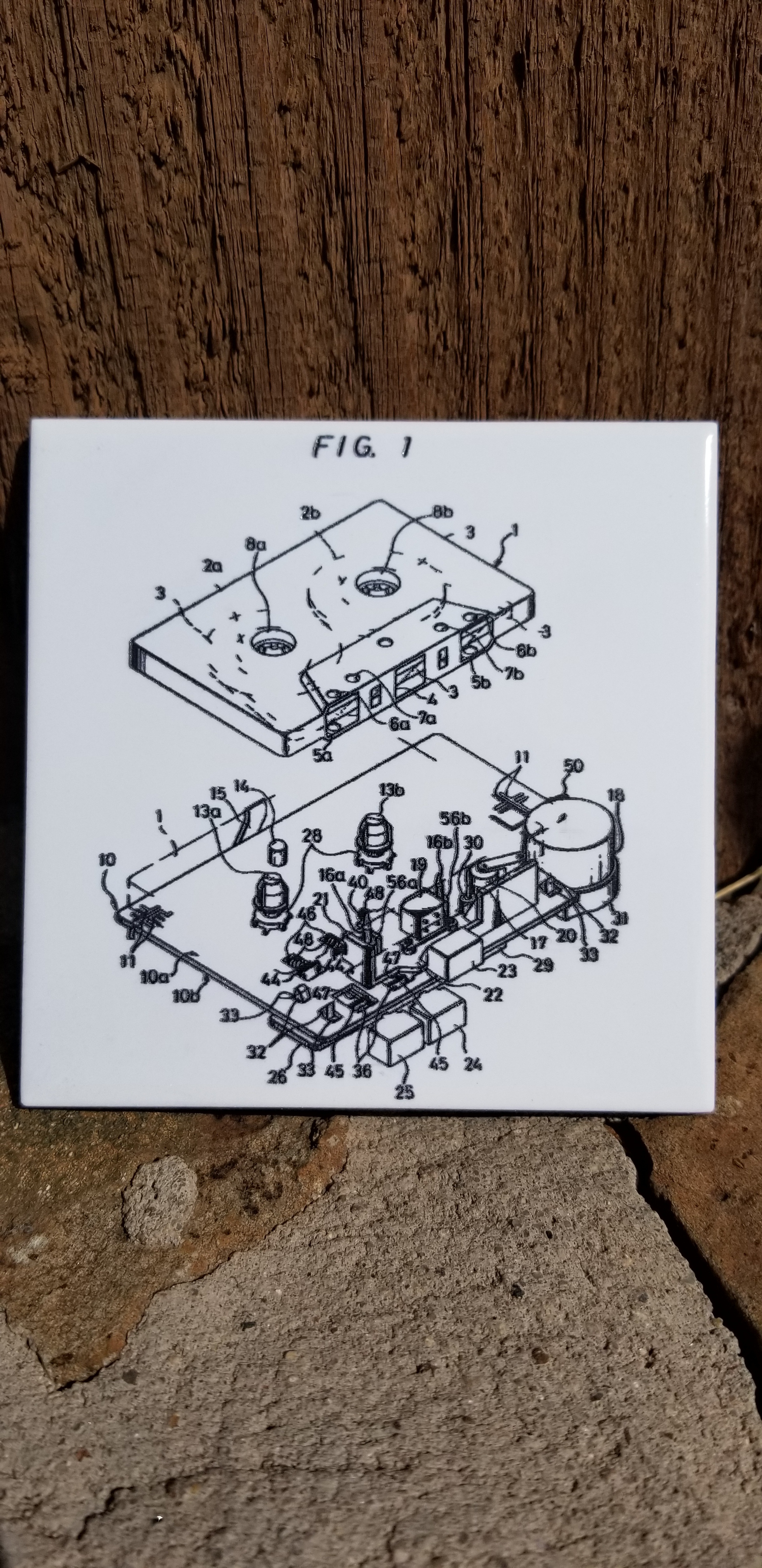

having some fun with cheap ceramic tiles from HD. Amazing results. coloured with sharpie but alcohol ink works much better.
100watt CO2, 320IPM, 60%

As for ink filling, I haven’t done tiles (but other materials) you basically flood the etched area and the ink soaks into the porous surface below. Then wipe off the surface. If you get some on the surface that won’t wipe off, you can use solvent to remove it.
I’ve done it with wood, but your paint must be latex (thick) so it doesn’t bleed too much into the wood.

I do just like Muskoka_Mike says, flood the cut with ink. Sharpies work well too and the excess just washes off with water and a cloth

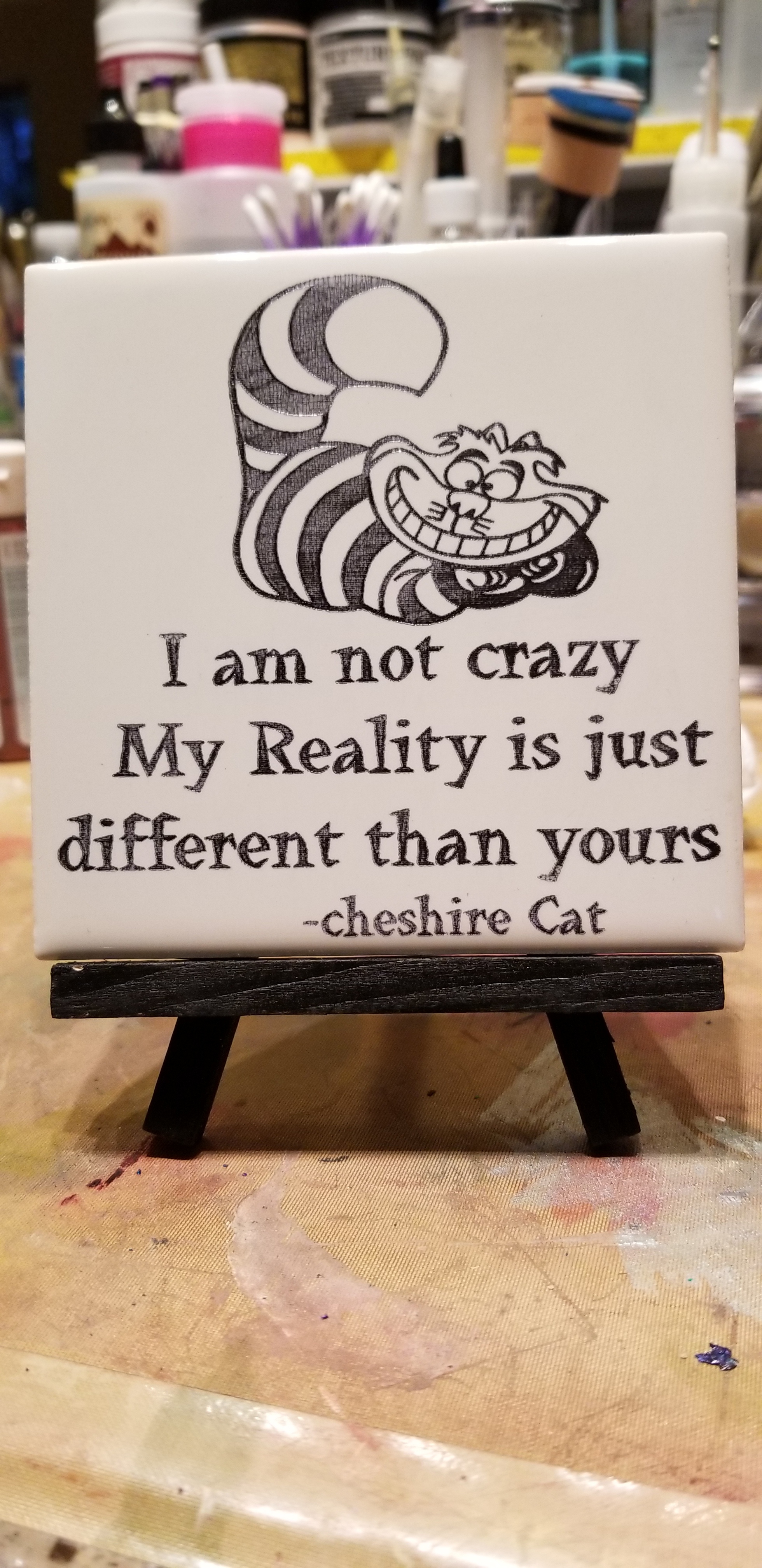

Can’t…stop… building up some stuff. These tiles are a hoot, even my wife will grab a marker.
These are all trivet sizeWow those look great. I’ve been playing with tiles but mine don’t seem to POP like yours or I bleed the colors. Do you mind sharing what markers and how to clean off the non-engraved part without messing up the color.
I have Bic brand markers, I just colour sloppily, let dry for quite awhile then simply scrub with soap and water. Comes right off. If you have running you’re not letting the marker dry enough

Excellent detail level. Was it created from vectors or bitmap?
This is a bitmap. I have better control of the engrave.
That is very impressive, especially from a bitmap image. Which image mode did you use?
