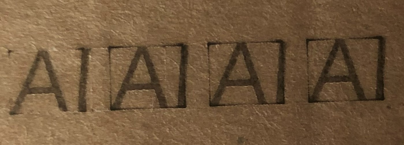

Since I’m still skeptical about how the controller sends pulses (i don’t have an oscilloscope unfortunately), I’ve made some tests on cardboard as you suggested (plus, i’ve marked the frame by putting the framing laser output to 20%):
First one on the left is step polarity invertion disabled for both X and Y axes, second one is step polarity inverted just for the X axis, third one is step polarity inverted for both X and Y axes, fourth one is step polarity inverted for only Y axis.
The engraving starts from the bottom of the text and works its way up… As you can see, all of them are tilted to the right.
For all tests I’ve used the same configuration you see here, except I cycled the step polarity of the X and Y axes to try all combinations:

I did try the workaround i’ve described earlier too, and it seems to work!
If i have to make a guess, the problem originates from the fact that my machine never reaches the max speed i’ve set up in the cut/layers tab.
I think the different lengths of scanning lines translate to different peak speeds of my stepper motors. Since torque goes down with speed in stepper motors, i think there is some interplay between the torque, friction and inertia of my machine. With same lengths paths and left-right-left-… scanning patterns, I think the lost steps are minimized since the forces balance equally in the going and return passes, but this doesn’t happen with the slanted scanning patterns.

I tried to override the step morphing by setting the pulse multiplier of the X axis (only) to full step instead of the base 10 microstep resolution, but the text remained slanted.
During the testing i noticed something though:
The X axis motor was now running at full step and I could hear loud thuds coming from it during the direction changes. I figured it must be because with full steps I have to ease the acceleration, but then something strange happened…
The Y axis was losing a lot more steps and even totally stalling during the X axis’ direction changes, with its same acceleration settings that never gave me any problems!
