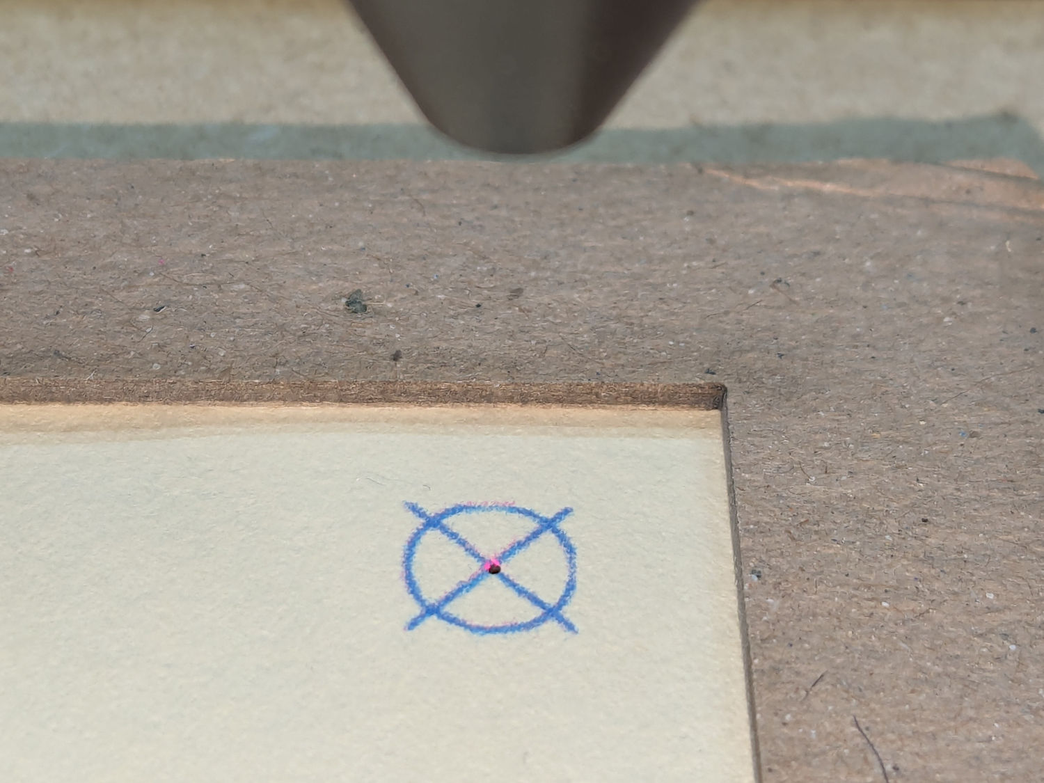

The monitor on my desk upstairs is 27 inch diagonal at 110 DPI and the monitor strapped to the laser is 24 inch diagonal at 121 DPI.
In round numbers, one pixel is 8 mils = 0.2 mm, which makes on-screen vectors just about exactly the size of the focused laser spot:
So you do get some points for verisimilitude…
