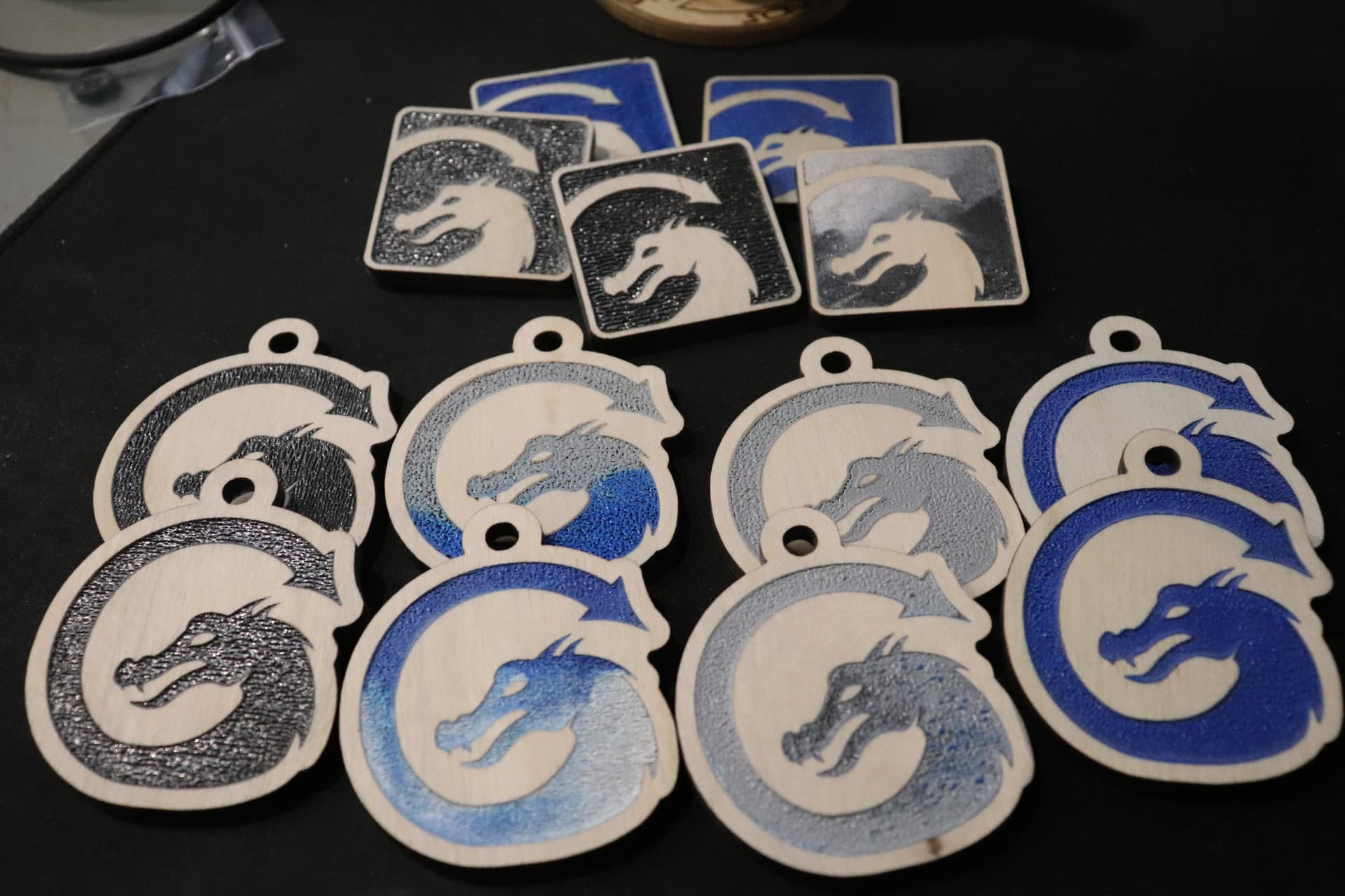

At the LBX 2023 conference in Peoria, there were samples of powder-coated wood with Lightburn logos.
I was told that one of the staff members (from British Columbia?) had produced them.
They looked great – and I would love to know about that process – and how to get those results on wood!

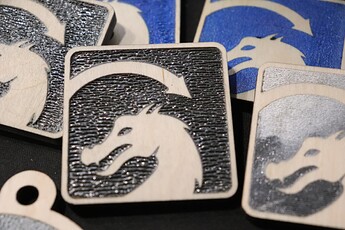

I made those for LBX with my 100 watt co2 laser.
It helps to use some cardboard as a template to place the parts back in the laser after filling with the powder coating. Its messy so I do that away from my laser. I cut the outside shape of the item into the template so I can run multiple parts. Sometimes you may need to add more powder or run the laser over it more than once so, a template is key for making multiples.
  1. Start with a fairly deep engraving, (325 mm/s @ 30%- .2mm line interval), not too deep or the powder will be too thick. You need about .5-1mm of powder. I cut a pile of tags to fill. Sand them off to get a nice clean surface.
  2. Then fill with powder coating and scrape off any excess with a card.
  3. Place the part back in the template, make sure to turn off air assist! Or (flooooof) powder paint everywhere… Run the laser % as low as you can. It may make some fumes so be sure to have extractor fan running. 350 mm/s @ 14% .2mm interval worked best for most colors. You will have to experiment with your settings as they will likely be different than mine.

Double thanks to you: first for making the free samples at the conference and second for these clear instructions. Very helpful and much appreciated!
What brand of powder coating did you use? The colors were sharp and vibrant.

Use a small paintbrush to pick up the powder, gentle tap taps to drop powder where needed… you will make a mess. That is why a choose to play with the colors out in my wood shop away from my clean laser area. Fill the engraving and use an old bank card or something to scrape off excess powder.
I do not use a heat gun, the powder was set with the laser.
Remember if you have the outside vector of your part you can easily drop that anywhere on your jig and cut out an template to exactly orient your part. Simply cut the shape. Pop the piece down in the cutout and then you have perfect alignment. No messing about with trying to align the laser to your work. Instead align your part to the laser.
