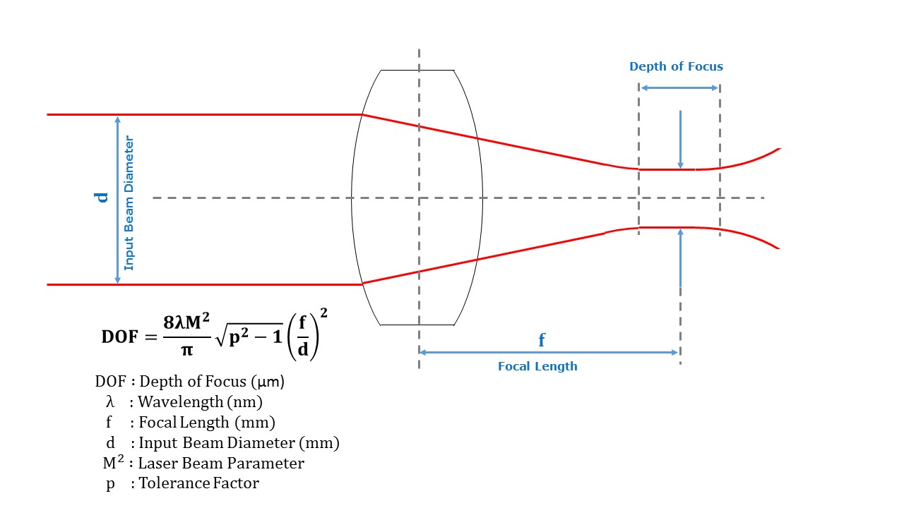

How long of a lens are you using? Spot size will remain the same within it’s depth of focus( dof).
A normal 2" lens has a depth of focus of only ~2.75mm, not enough depth of focus to encompass an almost 5mm deep piece of material. Proper focus on the top of the material leaves you with 1/2 the dof excluded. You’d need a 4" lens, almost 11mm dof, focused halfway down into the material to use the entire dof.
