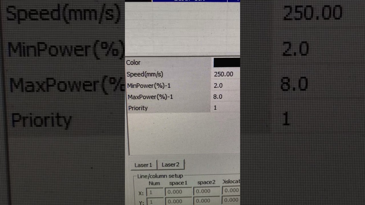

s-value max is a gcode thing and not relevant to your ruida controller. That’s why you don’t find it.

Hi Mike you need to make some tests before changing the firmware, u need to check if the signal is going right to the power supply
I’ve noticed something that makes me curious. You have a 60 watt compared to my 50 watt. When I run 80% I start getting into the 20+ma range and I can push it further. Can you get more than 19 ma through it?
It may be a symptom associated with the problem in that it is NOT going to full power but something different…?
dont mix up the settings for grbl and ruida controllers
display on the ruida shows 8% power, try see what happens if you plug the connector into the 2nd laser port, enable dual laser and set laser 2 to 8% see what is the outcome?

I’m running short on time tonight, but I quickly tried 95% burn and it did not go above 20 mA. It maybe a setting I missed, so I’ll try again tomorrow…thanks for the idea! I’ll check in tomorrow after a retry.
I’m running short on time tonight, but I did try laser two and got two results:
I got water protect shut down
and
I got the actions without any laser fire.
I put everything back to the way it was and tested. I’ll give your idea another try tomorrow and try to find the setting that I’m missing. I did enable water protect for laser #2, but apparently there’s something else I’m still missing…thank you for the idea!

We made some tests and it resulted that the power supply is receiving the signal well from the controller but the power supply is not emitting it well. If for example we did two tests of 10% power & 80% power , the power supply received different signals but when sending the signal to the laser tube it sends the same power of 19ma
Wow, I’m surprise that the power supply would work ok in Fill mode, but give full power in Line.
Did you do the in-line test with an amp meter on the red high voltage wire?
Did you try scanning at 2% power if yes what was the result?
Yes, 2% and even 0.01%. The result was 19-20mA draw and burn through 1/8" plywood.
You’re right, that smells funny. How do you (they) know the controller is sending the right signal?
If it works for one and not the other, that is not logical. If it stuck full on maybe, but this is not the behavior I’d expect either.
Carmel, did they have you do voltage tests or something that the controller was sending out to the PS? If so, I’d like to try those tests tomorrow. If yes, can you please share how those are done? Did you hear from the vendor if they are sending you a power supply?

There’s 2 water protection inputs on the controller, one for each laser (1 & 2)
If you enable laser #2 for testing and enable water protect for it then you’ll need to put a jumper wire on the controller to make it think that water flow is good.
