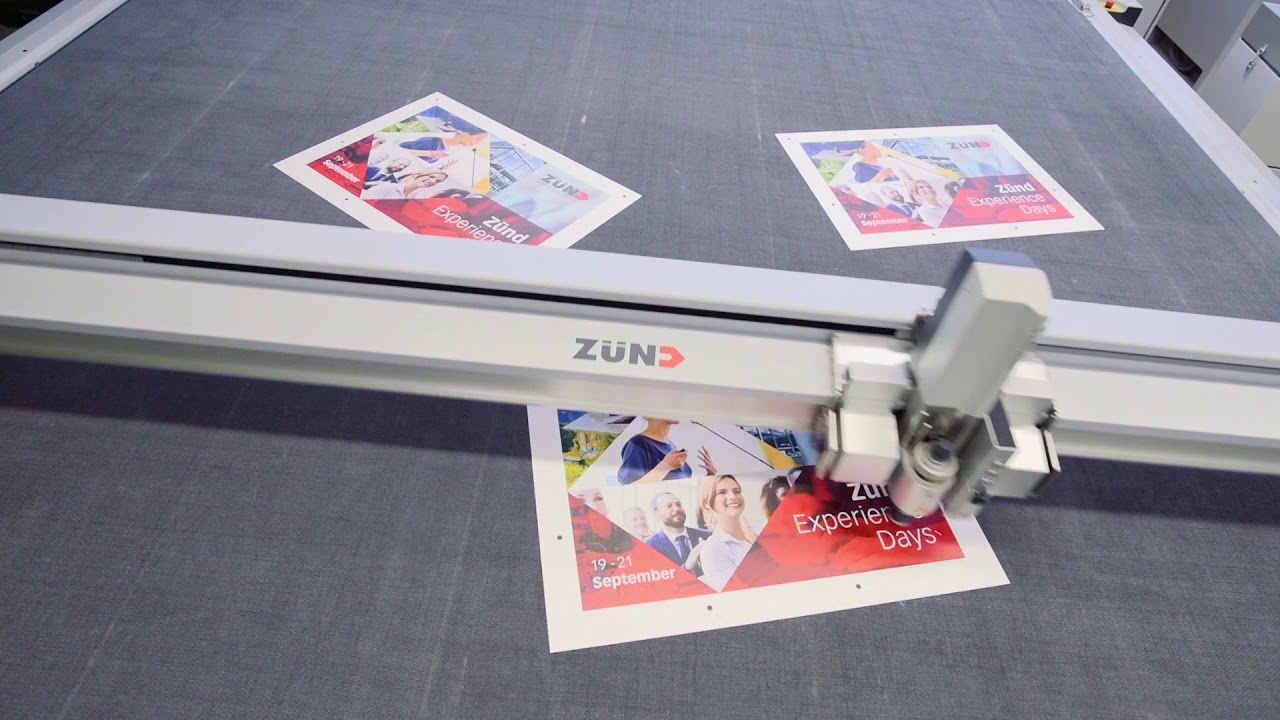

Did this use a head mounted camera to do auto-registration?
Yes. This is a video of the system.
https://www.youtube.com/watch?v=OY0FOWVzQks&ab_channel=Z%C3%BCndSystemtechnikAG
The head mounted camera was adjusted for focus height so I don’t see parallax being a major issue.
3 registration marks could reasonably correct for linear distortion. The video makes mention of correcting for all common printing distortions so curious what else it does. I can’t imagine it handling pincushion, barrel, or other more complex distortion types.
If you notice in the video, they use 5 or 6 registration marks. We would use 3.
They have an updated system where the camera is mounted above the table, and it takes a picture of all registration marks at once.
