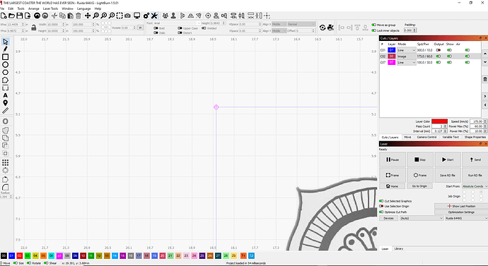

Having trouble with my print and cut… I have experience with P&C so not a problem with setting design up. My origin and home are both at 0,0,118.110. Absolute Coords are set. A little background. Was trying to set up P&C for a design that sat in an area of 10x10 inches. The design is circular, but its frame is square. LB sees the design, not the square. The design fills the square rather completely, so we can say the design is near 10" vertical and horizontal. As I was setting up my machine for P&C, my hand accidentally hit the origin button on the machine (Omtech red 22x28 max) while I was fine adjusting the laser head over the material. The machine went back to origin as it should. This is not to say that this may have caused a problem, as the problem might have existed whether I pushed origin or not. But what happens now is that once P&C is set, the design comes out smaller than it should be, about 7x7 inches. When I run the design without P&C, the image comes out perfectly every time, at roughly 10x10 inches (circum.). When I run frame, it performs in the same way. Any solutions?

forget the design. I just made a simple line square from the shape tool at 10x10 inches, and it still frames the square at less than what it should.
This may sound like a strange question, but what do you think print and cut does?
Please post a screen shot of your design and describe what you are hoping for.
Here you are.
This is the LB file:
THE LARGEST COASTER THE WORLD HAS EVER SEEN.lbrn2 (1.0 MB)

Is this the same design that you’re describing in the opening post? If so, I can’t correlate the design in the file to what you’re describing.
I also see no provision in the design for using print and cut. Can you elaborate on the end to end workflow? It’s not clear to me what you’re doing.
[EDIT] Upon re-reading I think I follow better. You’re describing the bounding box of the design as being 10x10" and you’re working with an image. I’m still not clear on how you are setting up print and cut, however, so please elaborate there.
im using print and cut in this last example as well, an example… the board you see can easily be lasered into without print and cut, but the board I truly wish to put my design on requires it to be placed in a specific spot requiring print and cut… lets not waste time on this part… my design needs to be in a particular area to get the right fit. end of story.
