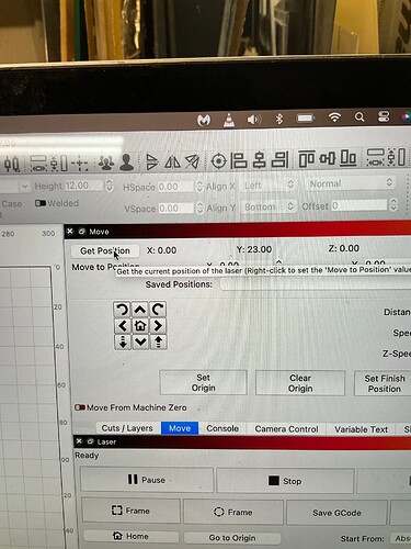

When I home and do “get position” I get 0,0. When I go to jog 1mm my Y axis point changes in lightburn but my laser head moves about 1mm and back into position no matter how many times I push the move button. I have provided pictures of what is happening as I still do not know if/how people go about uploading or sharing videos here. If I move 6 or more mm from home my laser will in fact move, so what I am assuming has happened is that ive been jogging a couple of mm and realized its not moving phyically, but in lightburn it has said it has moved, thus leading to discrepincies in the print and cut positioning. and im assuming the ones that have worked correctly I simply jogged enough from home to jump past the little hiccup its having.
This only happens along the Y axis from the home position only. Once I have moved far enough from home, I am able to move any amount of mm. and from home on the X axis I can move any amount of mm with no issues

In the pictures provided I pushed the move button 23 times in 1mm increments resulting in still no movement as shown in the 4th picture. If I do move 6 or more then yes I am able to move in as little as .5mm increments.
The discrepancies seem to happen on both the X and Y axis in varying degrees from attempt to attempt I assume based on how many “jogs” I’ve done with no motion.

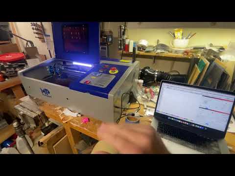

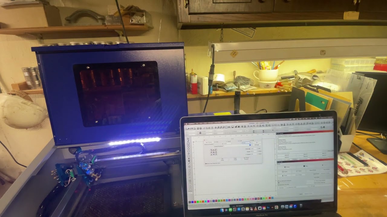

Here is a link to a video illustrating my issue. Hopefully the link works. I’ll do my best to do a mechanical look over but I honestly don’t know if I’ll know if something is wrong or not
Here is another video demonstrating my issue.
hopefully you can see it all ok, I wanted my computer and laser in view at the same time.

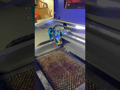

As you can see when I turn on, my laser homes. As far as I can tell it is doing it correctly.
When I try and move the laser 2mm it “moves” but does not actually go anywhere, even though the controller recognizes the motion.
I then change to 12mm and it moves just fine.
I then rehome and switch back to 2mm to demonstrate I am able to move small amounts on the X axis from the home position.
You can also see how my gantry is able to move off of the home position by doing things like framing. And I also show how if i push the jog button a lot in a row it kind of forces it to move, but even after taking my hand off the computer it seems to need to “catch up” with all the clicks
Any thoughts???
Try these tests and report results:
  1. Home machine, jog to 20,20 in a single move. Jog back to 0,0 (not homing). Try moving Y down by 1mm. What happens?
  2. With power disconnected, manually move the laser head across the full range of the bed. Do this slowly as this movement induces current back to the board. Do you feel any backlash, especially on Y axis? Or any greater resistance at any point in travel?
  3. It looks like there may be something pulling back the laser head toward the back of the machine. Is there a cable, or hose pulling in that direction?
  4. In video 2, it looks like Y movements down are continuously being pulled back after moving down. That’s definitely a problem. There should be no springback.

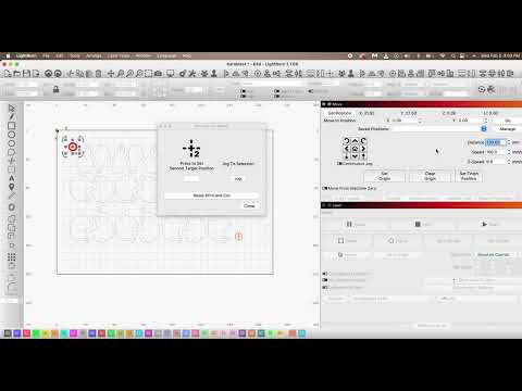

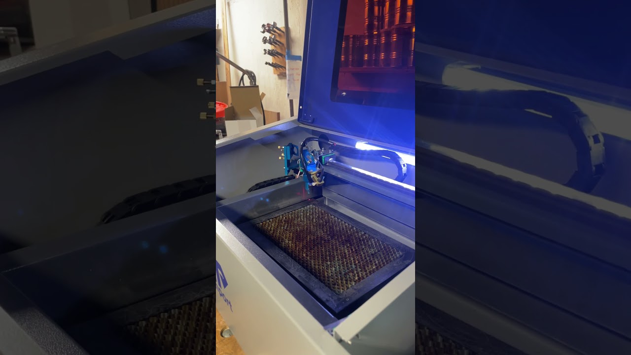

Here are the results of a print and cut test tonight. Provided is a video of the steps in lightburn I took as well as pictures illustrating the results. I have also provided images of my controller, and i think what is a close up of the stepper controls
I was able to do the test by entering into console $1=255 and then moving the laser head manually. I was able to do so with no different effort than if the machine was off, or prior to entering the command.

From the video it didn’t look like the issue was limited to home. When you were trying to move the laser head toward the front of the machine, there was a good bit of springback. It’s possible that larger movements can sufficiently overcome resistance but that smaller ones cannot but I’m only speculating. This hypothesis could be completely off.
I wouldn’t have expected no difference in effort. That’s throwing me off. Was this true for both X and Y orientations?
If so, can you try power cycling the machine, confirming that the configuration remains at $1=255 and retest? You can get the values by running $$ in Console.
Separate question, in one of the failed attempts using no scaling, will one of the cut shapes perfectly match the printed outline of another sticker? Trying to determine if the issue is only about alignment rather than scaling.
