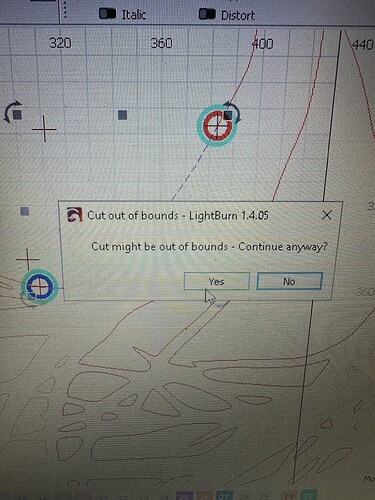

However I found another thing I don’t understand.
I couldn’t align a line connecting with two already cut lines, using the crosses. So I tried to use where the two cuts end as target points for PNC. The first result was that the line were probably 50 mm off. Second and third try it doesn’t even want to send the job to the laser.
First off it says the object is outside the workspace, which I find really strange that it thinks cause the line is between the target points so it couldn’t be outside the laser range. See pictures
