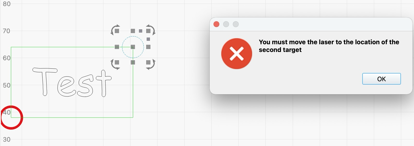

Print & Cut not recognising I've moved the 10w laser for 2nd Target
Trying to get Print & Cut function working in Lightburn (2.x) with my Snapmaker 2.0 A350 10. When I come to set the second I have issues.

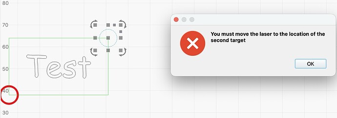

I’ve set the first target no problem. I move the laser (via Move tab or touchscreen) and when I try and set the second, I get an error.
“You must move the laser to the location of the second target”
Its likes its not recognised I moved the laser. It like it can’t get the position.

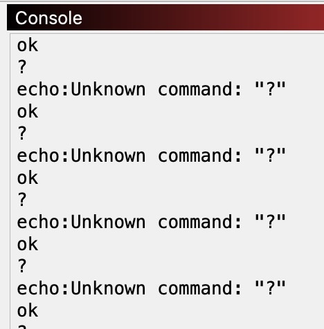

OK, I homed machine, selected 1st registration object (on lightburn design screen), then moved via Lightburn Move to first target position, clicked “Set first target position”, selected 2nd registration object (on lightburn design screen), moved to 2nd position via Lightburn Move, clicked “Set second target position”. Then I got the attached error “You must move the laser to the location of the second target”
Its like I never moved the laser via lightburn Move
When I click Get Position I get unknown command

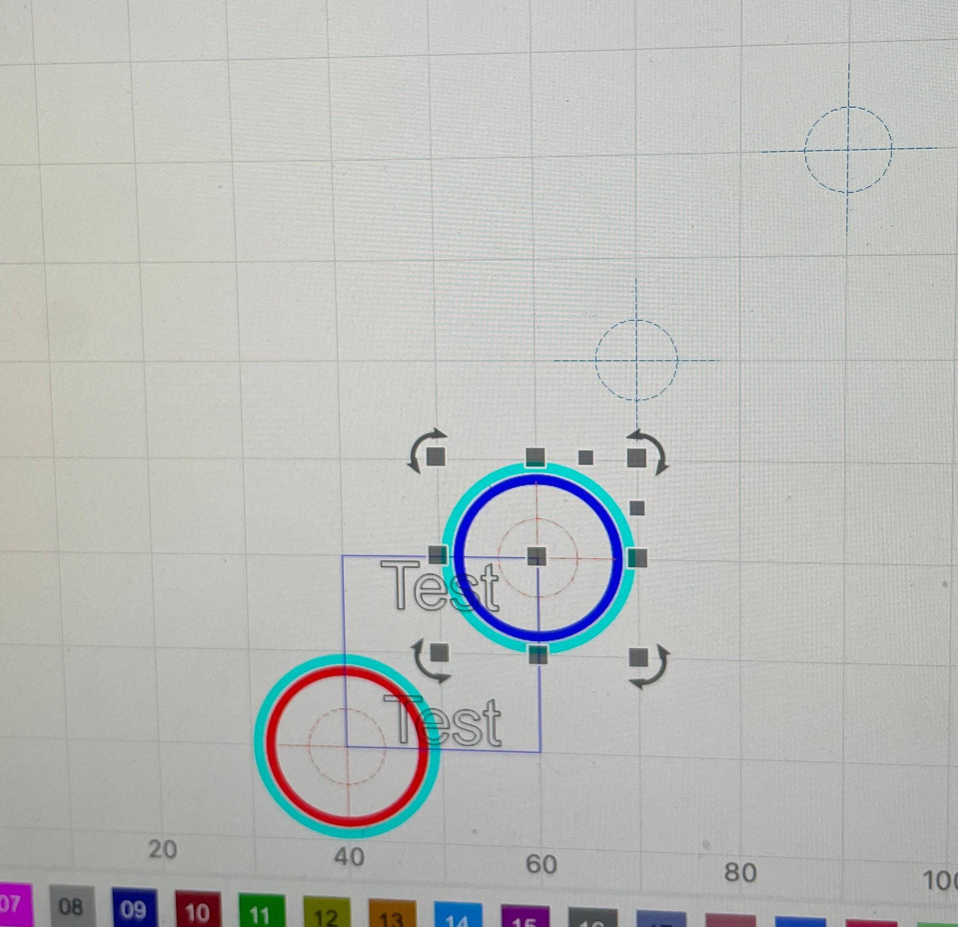

I have not used PnC, but everything I have seen: You cannot use the design for the registration marks. If you view the online Docs, you will see the marks, typically a circle with a cross in the middle, as marks separate from the project. Also space them as far apart as possible.
Thanks for reply. I have used a two circles as a registration mark and assigned them to T1 Tool layer. The first target mark register OK, the second once it the problem. I have used videos in youtube and followed the same designs and registration marks, I think Lightburn simply doesn’t recognise the movement of the laser so its doesn’t think you moved it, even though physical laser has moved.

This appears to be the entirety of the problem - LightBurn is sending a query command to your controller to ask it “what coordinates are you at"?” and the controller is responding with “unknown command” instead of the location.

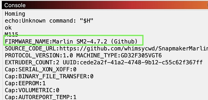

What kind of controller did you choose when you set up the laser? Marlin is what older SnapMaker’s used to use, and the current ones are now GRBL - it looks like yours is trying to use the GRBL query command. It’s possible we got that wrong, or you’ve chosen the wrong device type.
Thanks for reply. I use GRBL-M3 as Marlin / Snapmaker (Marlin) device list failed to connect … I just get “Waiting for connection” in the console.
When I created a device using GRBL-M3 it worked and I’ve been lasering
I’m stuck between the rock and hard place, can you suggest how I should set up device?

I’ve used the device name Marlin, Not Snapmaker (Marlin) and that works with “Get Position” and subsequently “Print and Cut”
I had to Change Laser Control to M03/05 as laser never fired under M106/07, not sure what Inline does.

Marlin is very flexible, but that also makes it complicated to support at times. The “inline” option is to use an S value much like GRBL, instead of using an argument to M3 or M106 to set the power value, but it has to be enabled in the firmware for it to work, and a lot of Marlin options are enabled at the point the firmware is compiled.

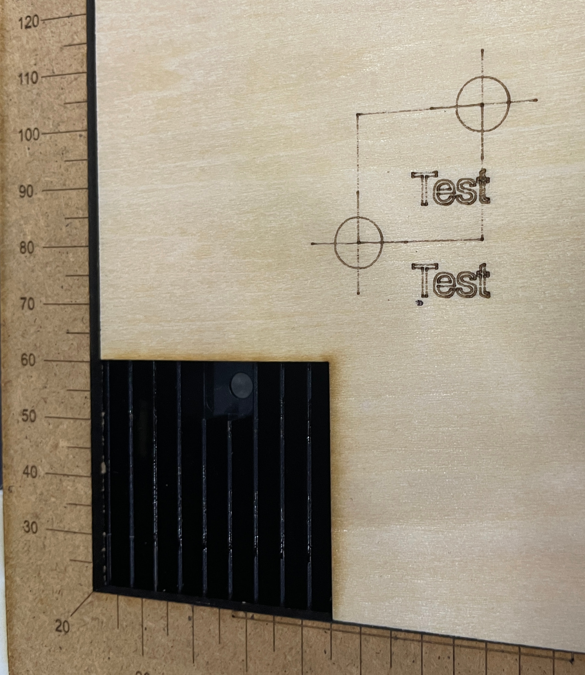

Got the Print & Cut to work but it doesn’t line up with the the spots I moved the laser to (registration marks) I printed the egistration marks and the sqaure to show where the text should go into to help with explain problem. The original designed square was set at very high speed so didn’t show.
You can see text is below and to the right of the first registration mark The laser is calibrated as the test square burns in the exact position it was meant to as well as the registration mark.
I printed the square seperatly and retrieved the “Get Postion”
Am I doing anything wrong as i’ve followed the guides an youtube videos.
Thanks in advance.
Not sure what you are trying to accomplish here. PnC is normally to be used when you move a board to burn areas not normally reachable by the laser (aka PassThru). Your square does not indicate the need for PnC. It will help if you show us what you want to actually accomplish with images, programs, or drawings.
