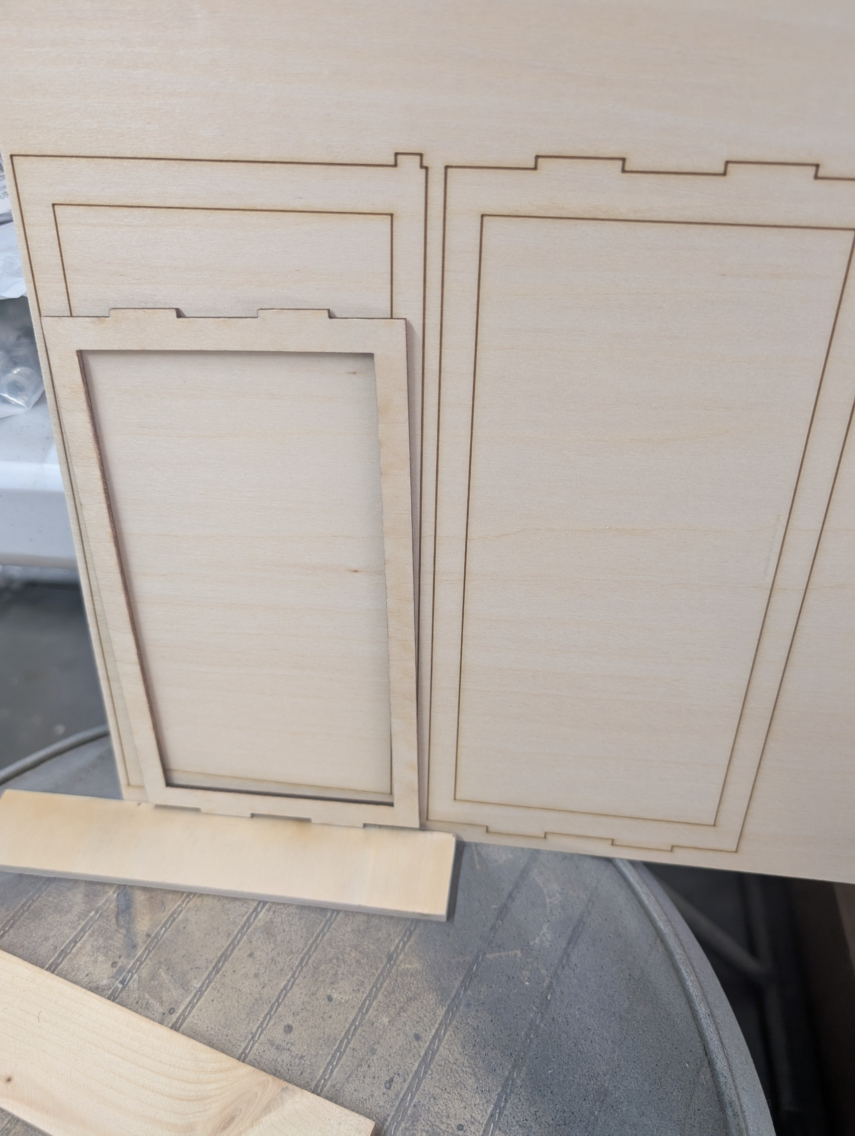

This pic goes with the last one.
This shows the wanted cut size. The actual cut size turne out to be 228.5 x 113.0.
Shows the comparrision of size difference.

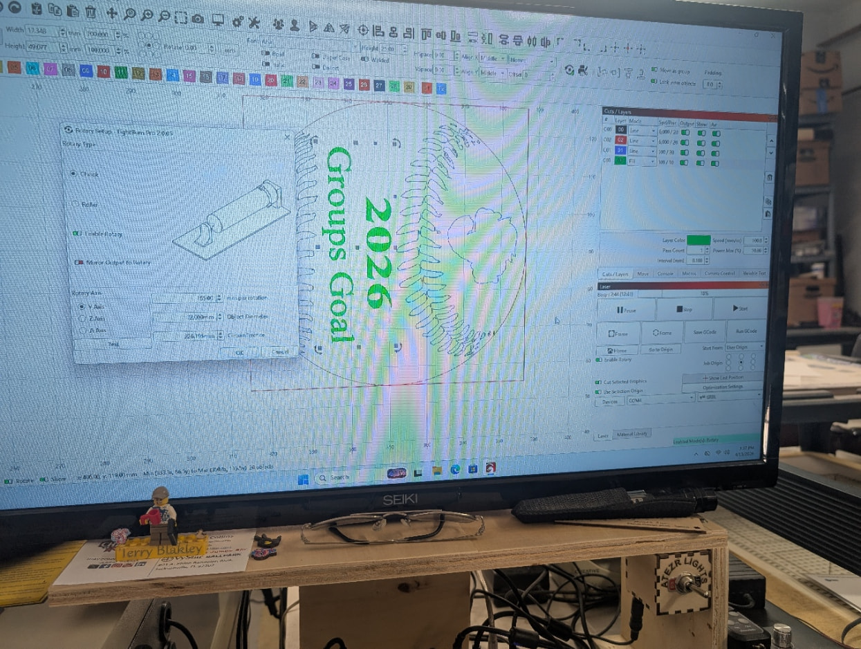

The rotator info showing the mirror not turned on.

I found this when I searched Topics for “Reversed engraving”…It’s about Work Origin, hope its relevant.

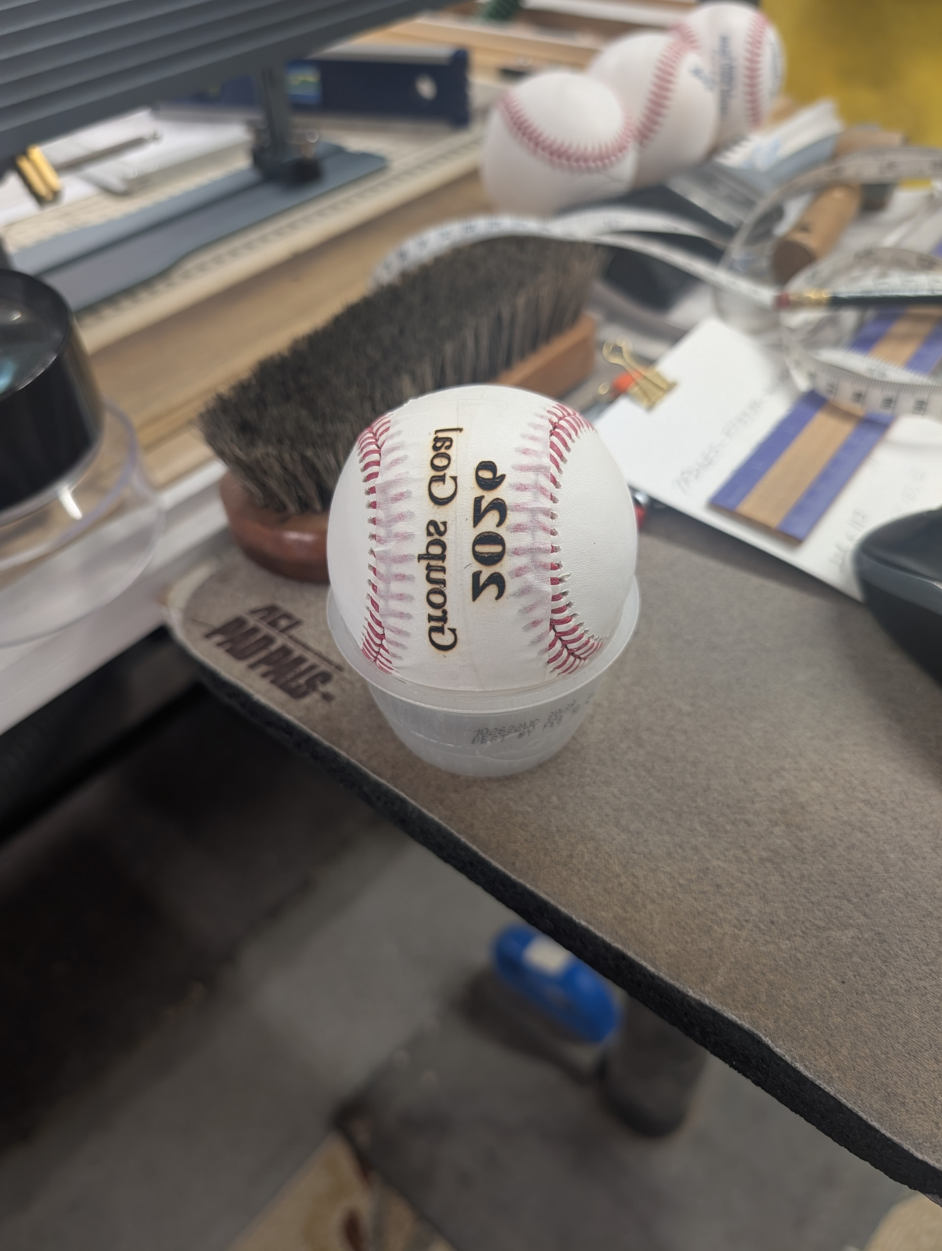

I loaded a file into my AtomStack Swift 7W and it had a “text” name in the design. When I ran the file it engraved and filled nicely. I then loaded the same file into Lightburn and ran it but for some reason the name engraved reversed (like in a mirror). I used the mirror tool and it engraved the right way but the rest of the engraving was a little bit messy. Why would that happen

Another possibility is the rotary needs to be rotated 180° in position.

Need to correct the post. Disregard the Millmage problems. I figured it out. HOWEVER, the Atezr rotary problem needs to be looked at. I’ts holding me up.

Did you check your Origin setting and/or spin the rotary around. You need to tell us what you have done and what the result was.
