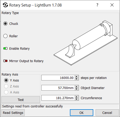

My stepper motor is set to 6400 pulse/rev, and the ratio on my rotary is 2,5, so I set the steps/rotation to 16000.
When I press “test” my rotary goes two complete rounds before it returns to where it started.

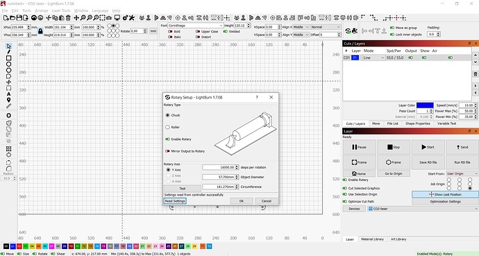

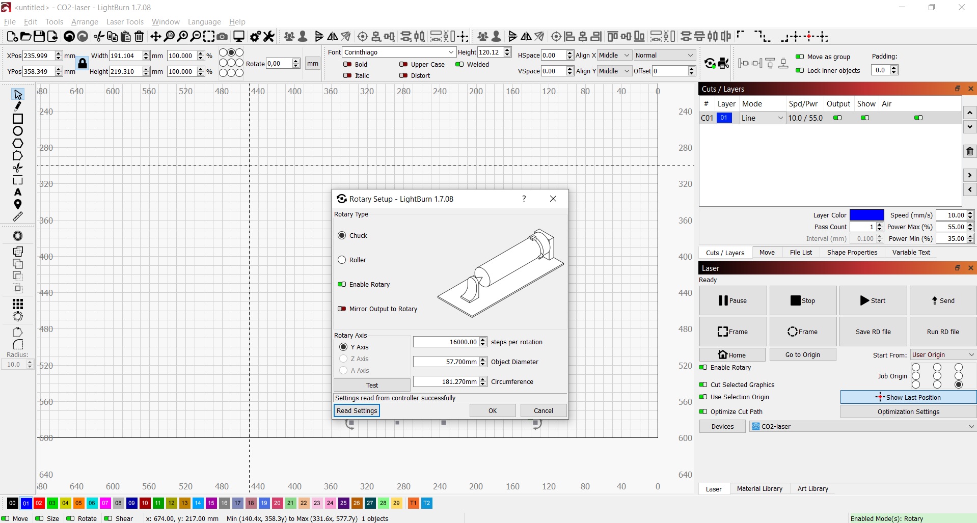

Please post screenshots of your rotary framing screen and the rotary screen that comes up after the framing screen. To be clear, it is the “Test” button in the LB rotary “Setup” screen that is producing exactly 2 rotations? Your dips on the microstep driver are set to 6400?
Yes, this is still the case.
It does not matter if I type 500 or 21000 in the steps per rotation window.
It is the test button in the LB rotary setup screen that produces two whole rotations.

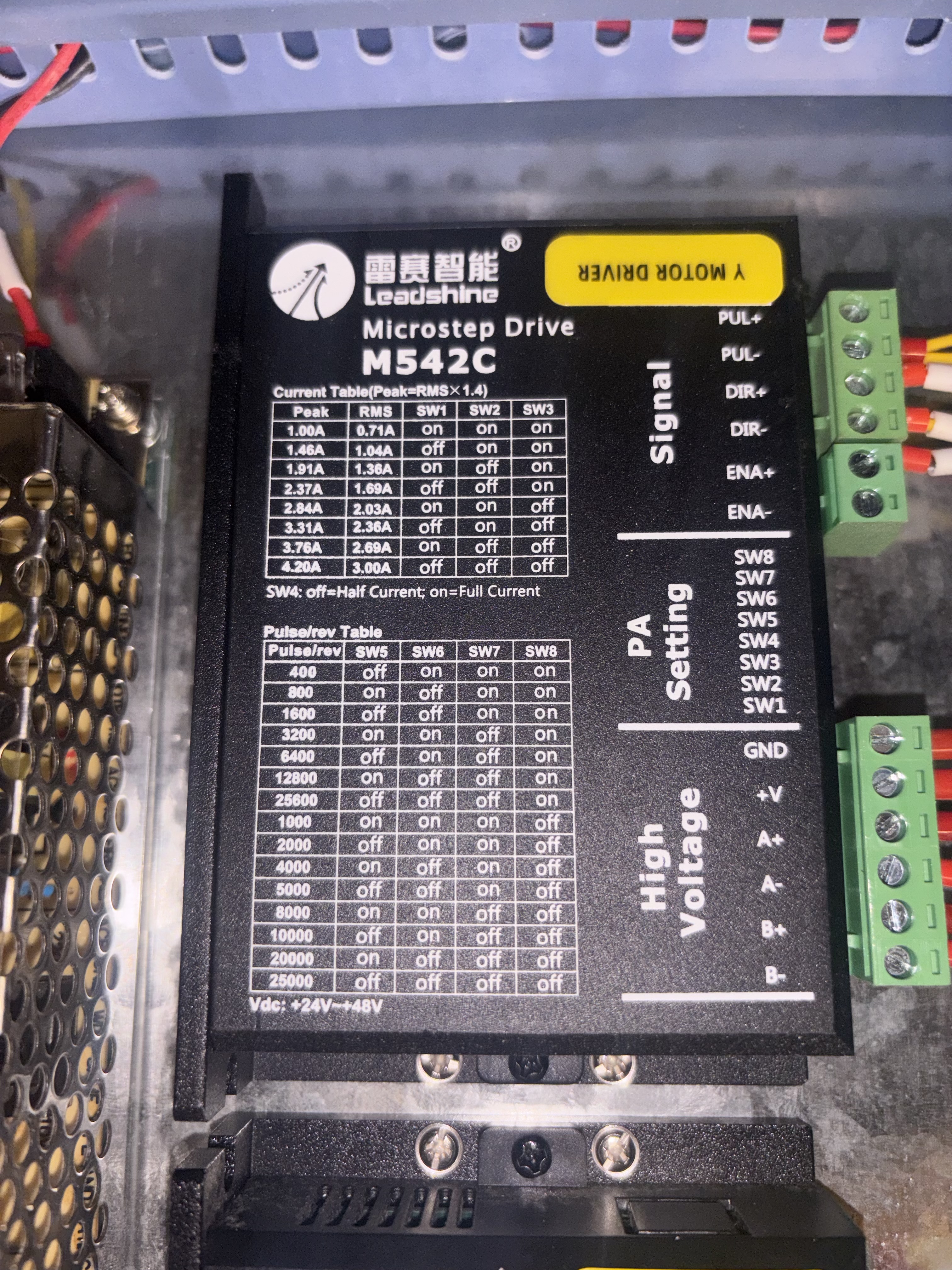

The dip-switches on my Y-axis is set to 6400, yes. And i counted the cogs on the rotary wheels. It is 50 on the biggest and 20 on the smallest.
OK, just throwing things out now, if you double the circumference and attempt to laser, does it make 4 turns, 2 turns, or 1 turn? Does the square get longer?
If I try to put in 28.85 (half) then it goes 1 complete round. So there is finally a change a least :slight_smile:
But test still spins 2 rounds?

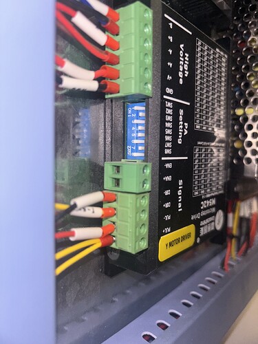

I’m wondering if they read the motor driver switch setting correctly.. On is usually towards the circuit board. It’s also marked on most of the drivers I’ve seen.
You need to ensure the hardware is correct… if that’s not right, it won’t ever operate properly.

If i did like you said, still have it on 16000 spr, and change half the circumference it goes one round with the test button :grinning_face:
As far as I can read the driver switch setting 6 and 8 is on/down, and 5,7 is off/up. So that reads 6400?
Yes it appears to be 6400. You have a 2.5:1 ratio, so it should be set to 16000 as you’ve stated.

As far as my limited knowledge, the test button shouldn’t have anythin to do with diameter/circumference with a chuck, that’s why I suggested cutting it in half, didn’t think it would would but make a difference it did. Something else we are missing don’t think its LB.
6400 × 2.5 is 6400 × 2.5 no matter what the diameter.
The steps/rotation apply to the motor. I was suggesting he set it for what the driver is set, which is 6400 and see if the motor responds to the test button with one complete turn and back.
Maybe. OP said no change regardless of steps with test button. But also test does change in regards to diameter. Thats backwards, AFAIK.

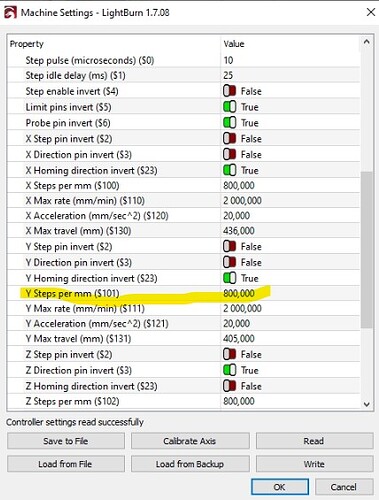

My experience with the rotor unit settings is that “steps per rotation” has no effect at all, that setting should affect Y Steps per mm ($101) in "Machine Settings.
Try entering your value there.
