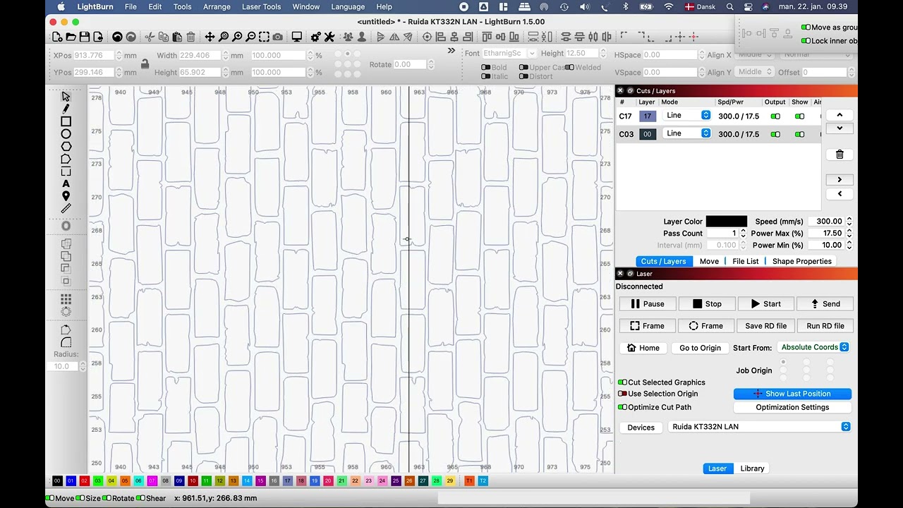

It went faster than expected, here is a small demo of how it works (here for me).
Notice that I duplicate the square and set it up on the red layer. Then I deselect everything, select my brickwork and the red square afterwards, as the cutting tool.
Cut shapes mark everything outside as the result, but a click inside the window reverses the selection. Now I delete contents of my red “help window” and the bricks and the red window disappears.

Correct, but I can’t clearly show it in a “normal” YouTube video, so I try to make it more visible this way and I also go through the menus to show what I do.
