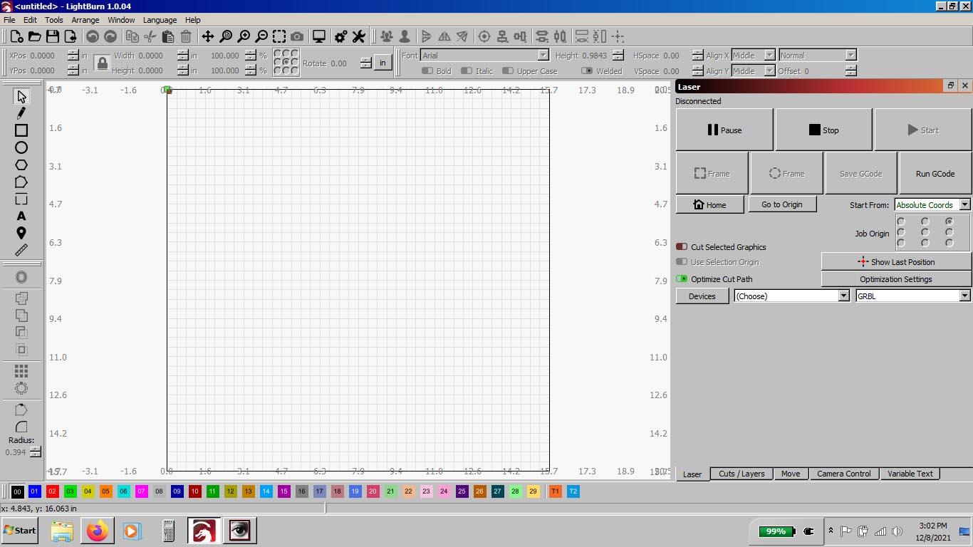

I’m new to LightBurn and am running the trial version 1.0.0.4 on a Windows 7 Pro platform using a Lenovo laptop E545. I’m having problems with the docking palettes to the right of the workspace and my layers bar at the bottom.
When I first boot LightBurn, the bottom of the bottom docking palette is cut off (think this is the LASER tab). I can remove the Library tab behind it and then it kind of works but the layers bar disappears. I’ve played around docking and undocking several of the tabs, and it only gets worse so I usually end up by doing a WINDOW>>Reset to Default Value, which kind of fixes things but the layers bar is still missing until I reboot, then the issue with the palettes starts all over again. In reading some other forums (outside the LightBurn forum), it appears this issue is happening to others as well.

Can you take a screenshot of your entire desktop and post here? You can just drag the image into the text entry window.
Also, make sure you have LightBurn maximized? It might be that the window is being drawn beneath the taskbar.
What do you have the display set to? Are you applying any scaling to that?
You may have solved this for me. I did have the page maximized and the laptop is set to its maximum resolution(1366x768) but when you mentioned having the page maximized, I thought I might check just in case. As it was after booting, the top of the right positioned (lower position) laser panel was cut off (1). I tried undocking the Laser tab and once undocked, it wouldn’t re-dock (2). I deleted the Library tab which was underneath it. Now all I had was an undocked Laser tab and the Cuts/Layers tab on the right which went full height after I deleted the Library tab. Now I popped the Laser tab back over the palette position and it re-docked (3), going full height, but my layer bar was gone. I decided to minimize and re-maximize the screen, and that got everything working (4)!!!

For what it’s worth I don’t think you’d have any problem adding control tabs now. I think the entirety of the problem was in the LightBurn application window being drawn under the taskbar. You could have “solved” this alternatively by hiding the taskbar or possibly by running, ironically, with the window not maximized and just resizing and moving the application so it sits entirely above the taskbar.

The issue, in broad terms, is that LightBurn’s default window layout requires more than 768 vertical pixels. All of the windows have a minimum height, and when the Cuts/Layers window and Laser window are arranged in the default way (both visible), there isn’t room.
The correct fix is to only have one pane visible, and tab them, instead of vertically sticking, or lowering the size of the tool buttons to make enough room for two to fit.
The next release of LightBurn will detect if your display is too small, and will do this for you, instead of you having to do it manually.
