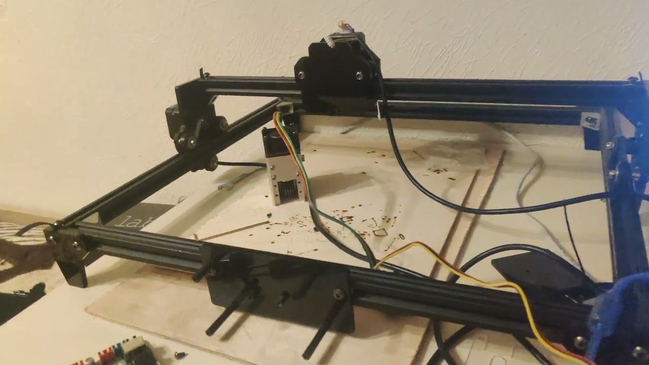

Problem with one of Axis

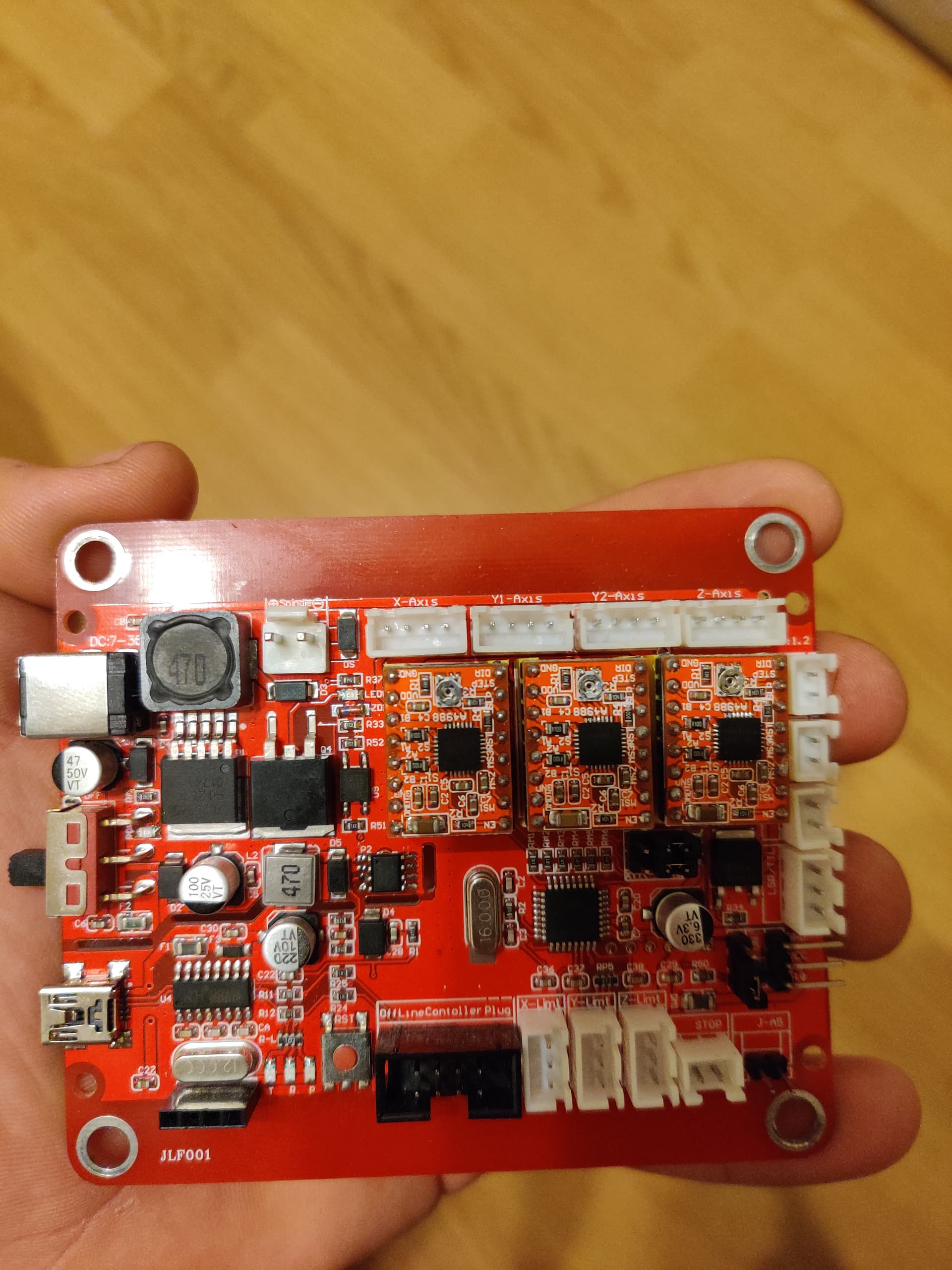

What motherboard do you have? From video you post before seem quite like an Eleksmaker mana se, if so you have to change it with another one like MKS DLC 2.0 cause that MB can’t supporto new firmware, has not enough memory
Yes, GRBL1.1 Controller Board 2Axis Stepper Motor Control Double Yaxis Support Servo For GRBL Laser Engraving Machine|Woodworking Machinery Parts| - AliExpress

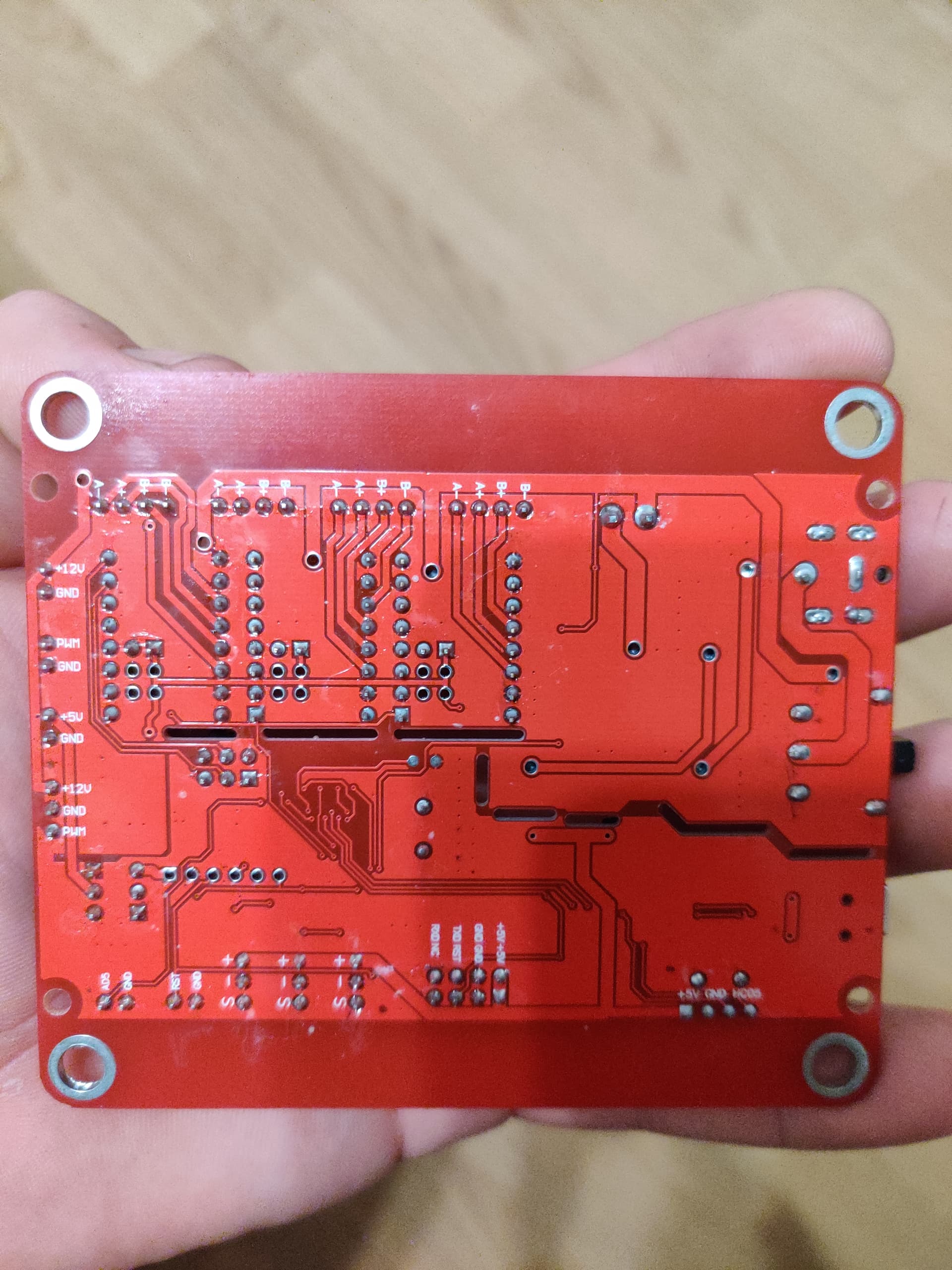

But i wanna flash a new firmware to other Mb dont know what named is, for now have a image part of her, maybe you will know and can say me can i flash new version to this one
P.s you are amazing, saying big thanks to you for helping me.
@killrob btw, yep mine is too A40630
I’m still searching infos on your mb
@killrob here
https://www.google.com/search?q=jlf001&oq=jlf001&aqs=chrome..69i57j0i30l2j0i10i30j0i13i30j0i30.2988j0j4&client=ms-android-oneplus&sourceid=chrome-mobile&ie=UTF-8#imgrc=yVnOoyfMV-d20M
Ok is possibile to upload new grbl with Arduino ide, is not so difficult but if you Google how to, you will find a lot of tutorials
@killrob ok i gonna try that, text you if get some wrong

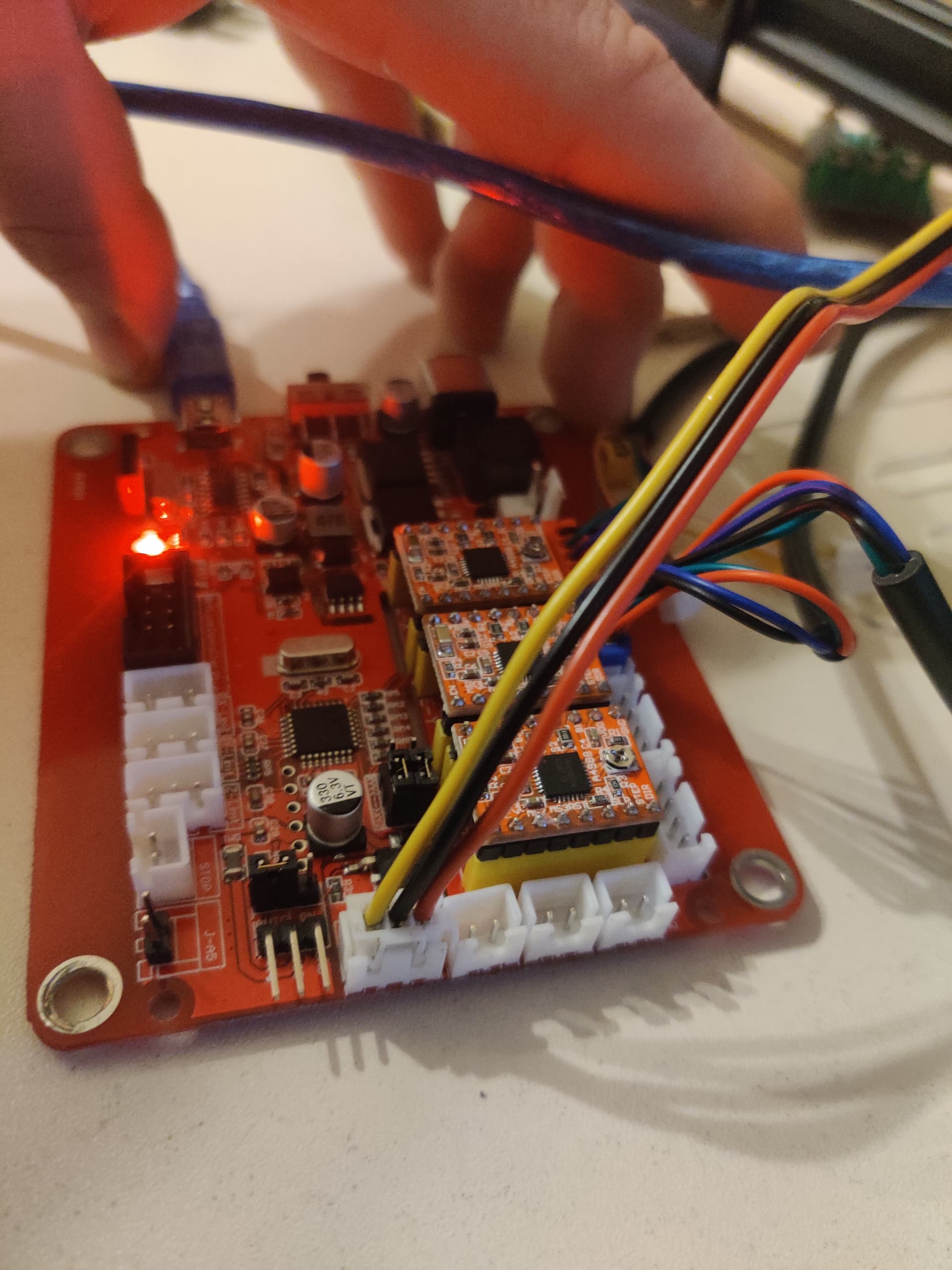

@killrob so i upgraded to v1.1h version, but problem still are, he just turn on laser but not too mutch, still need to push test button, maybe you need a video?
Also made $30 = 1000 like value max

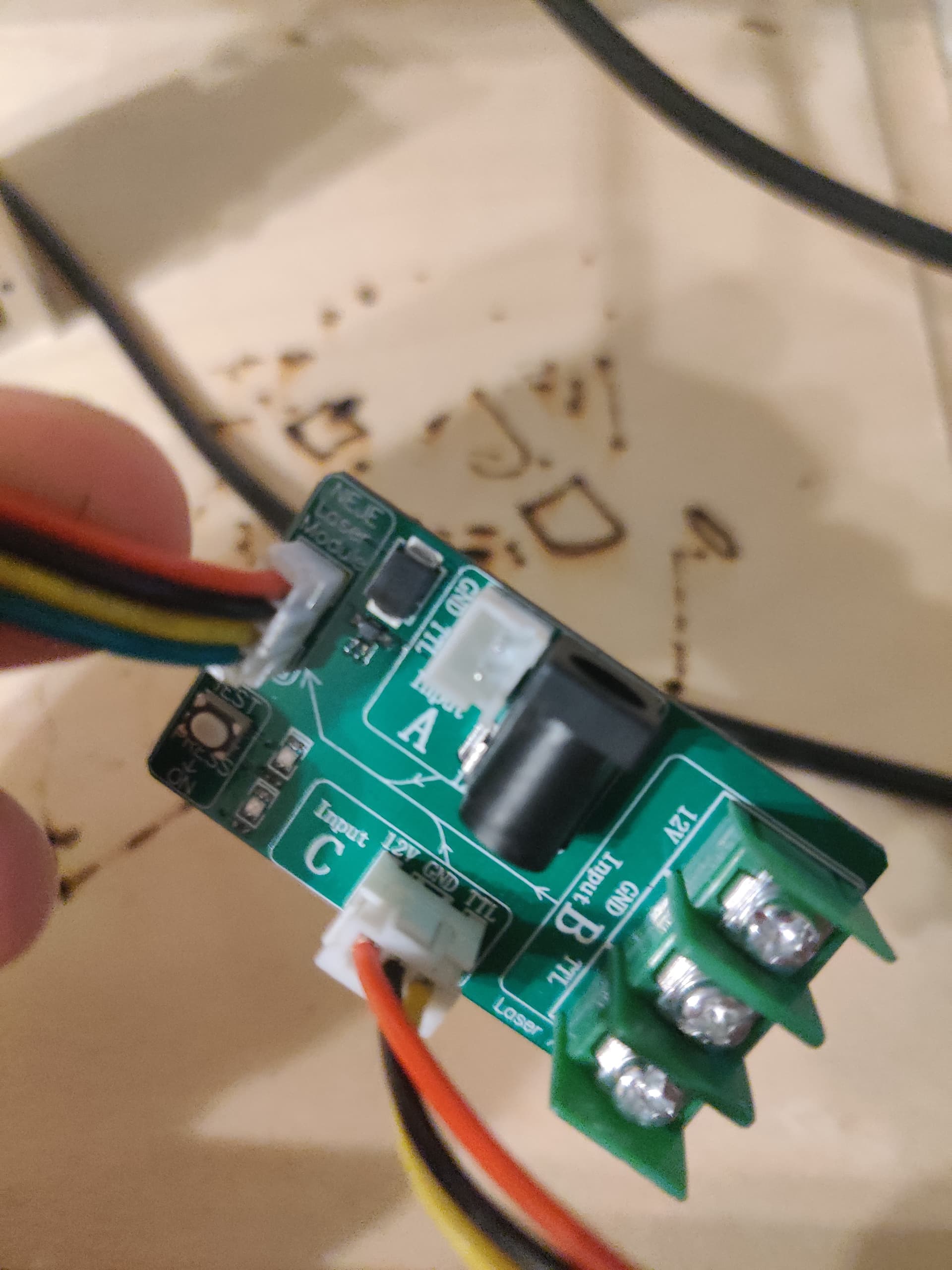

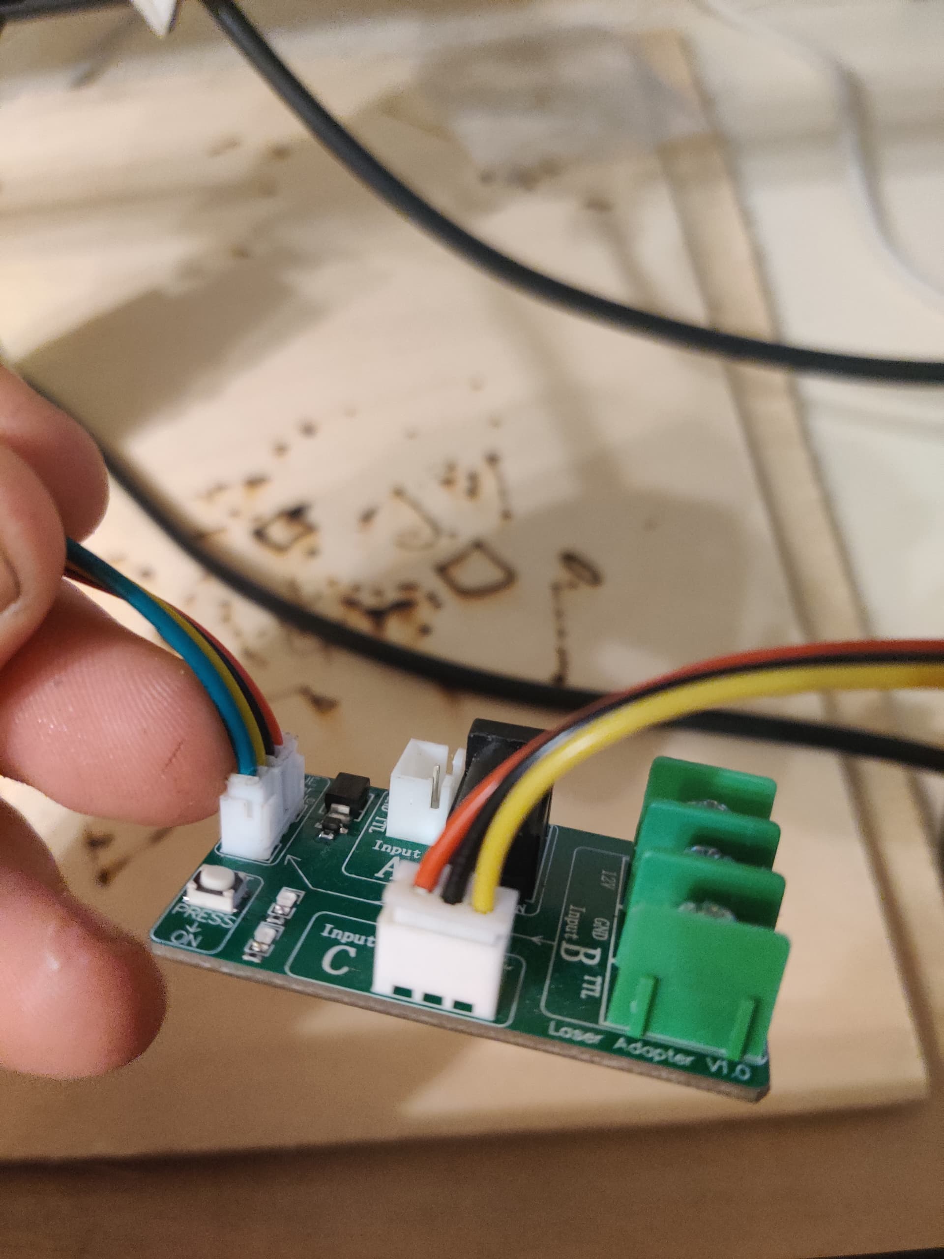

Ok i saw video and is not normal at all, make some picts of the 3 wires cable, both side, MB side and interface adapters side please.
Also done $31=1?
@killrob
Ok i found the issue, as you can see from this link that MB can’t manage module over 5.5W, but the Solution is simple, you can use only the 2 pin pwm from MB to control laser but give him power directly from power supply
This means that you have to use A in the interface adapter
So i need two chargers? One for interface next one for mb?
You can double the output of your actual power supply
@killrob with some adapter or what?
Or you can buy this one, one intput and 3 output.
Btw is my configuration. I use this power supply with a connection for MB and a connection for laser module
