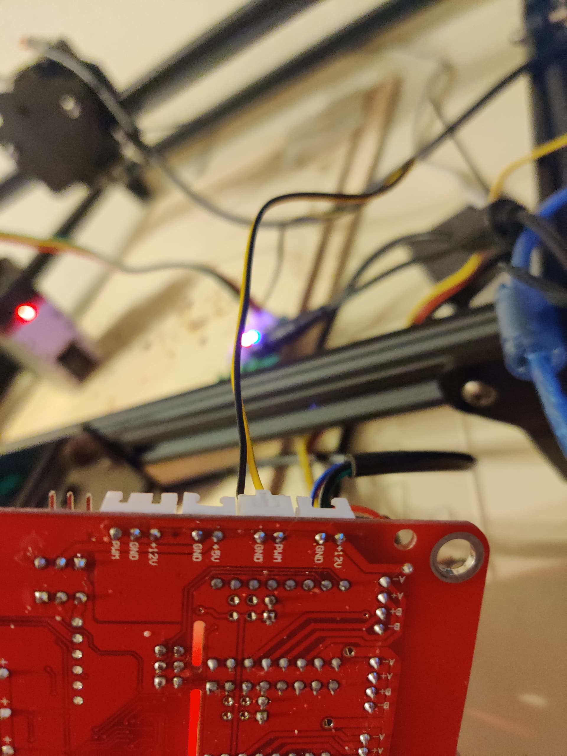

But laser still dont turn on then starting engraving, maybe you know what is the problem here?
Atm i’m not at home, when i came back i’ll post a pict of my connection on both sides
Okay, i waiting for you, because laser still not working :smiley:

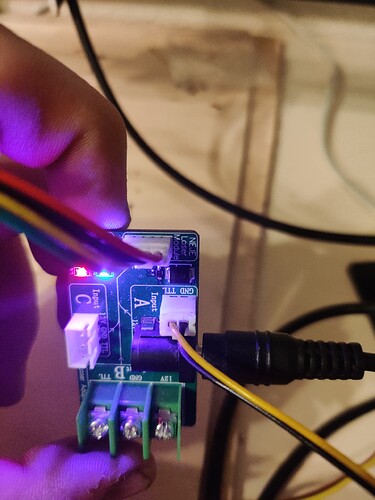

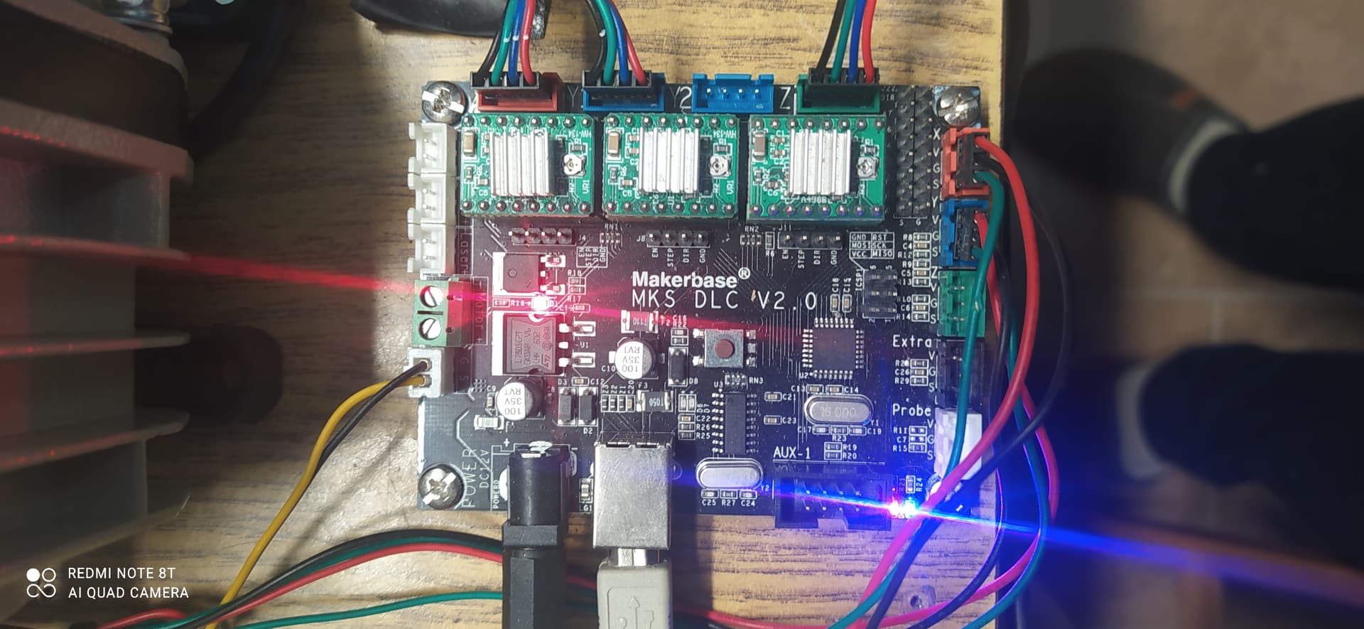

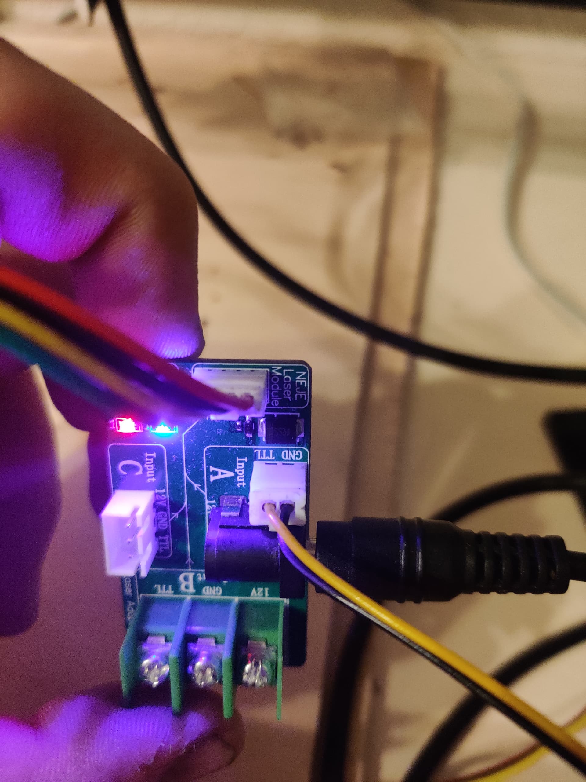

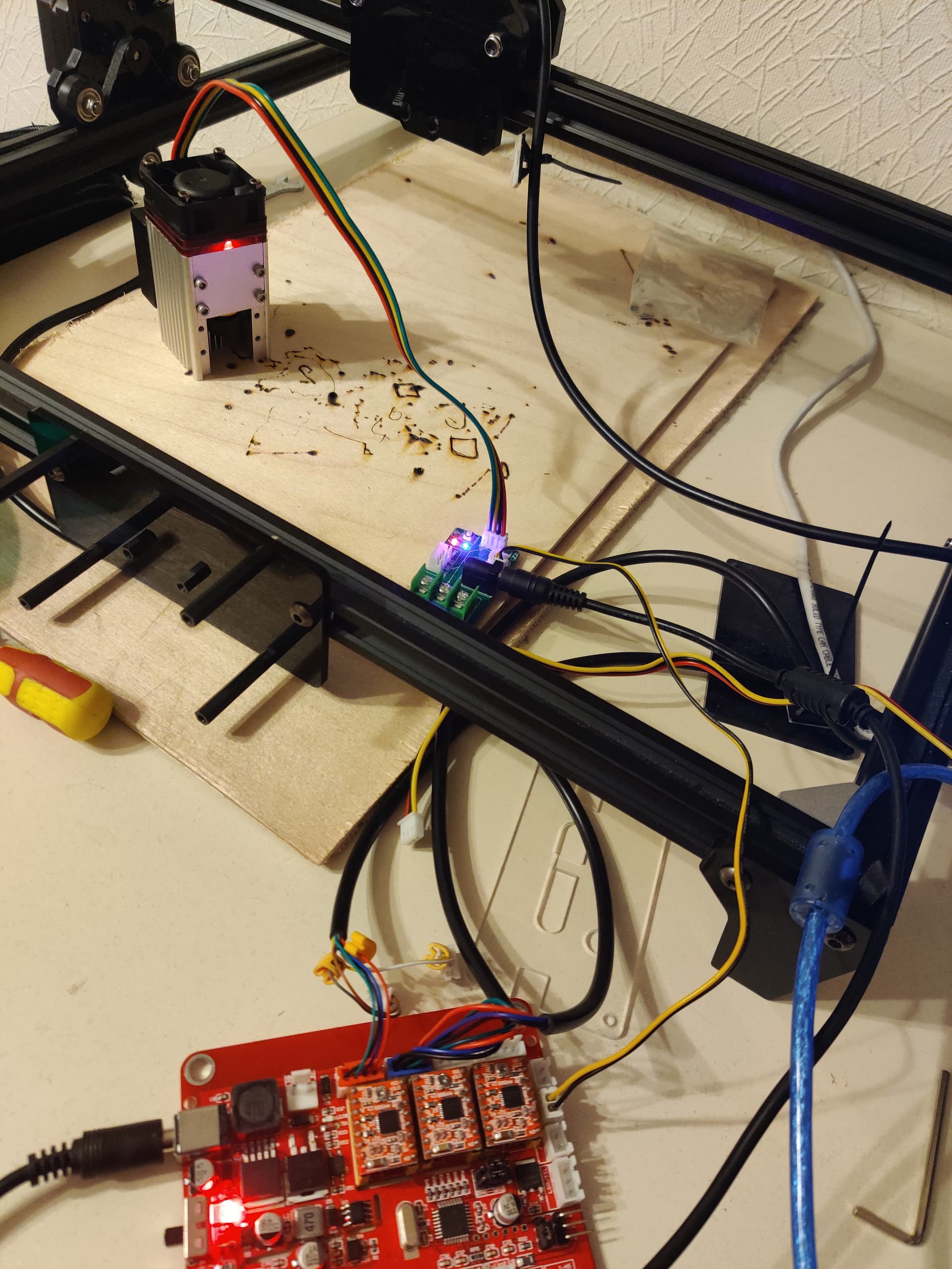

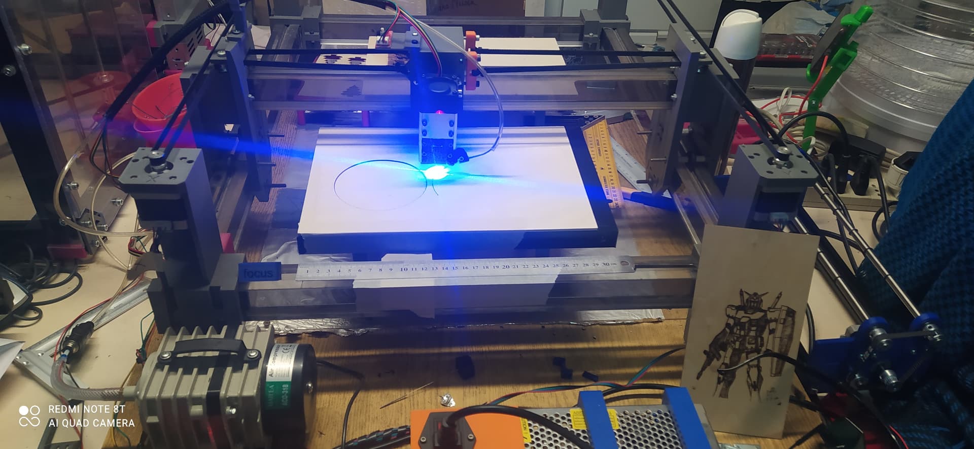

Ok here the picts
First pict is my machine
Second is the laser connection on MB side (are the Black and Yellow wires)
Third is connection on adapters and i give power to laser directly from power supply
@killrob thanks, kind a like mine, but my laser still doesnt work, how we can solve this problem? Settings looks normal, what i have to watch next?
i told you, is you MB that does not support laser module over 5.5W, and the A40630 is a 7.5W.
If you buy this one your problem is solved
