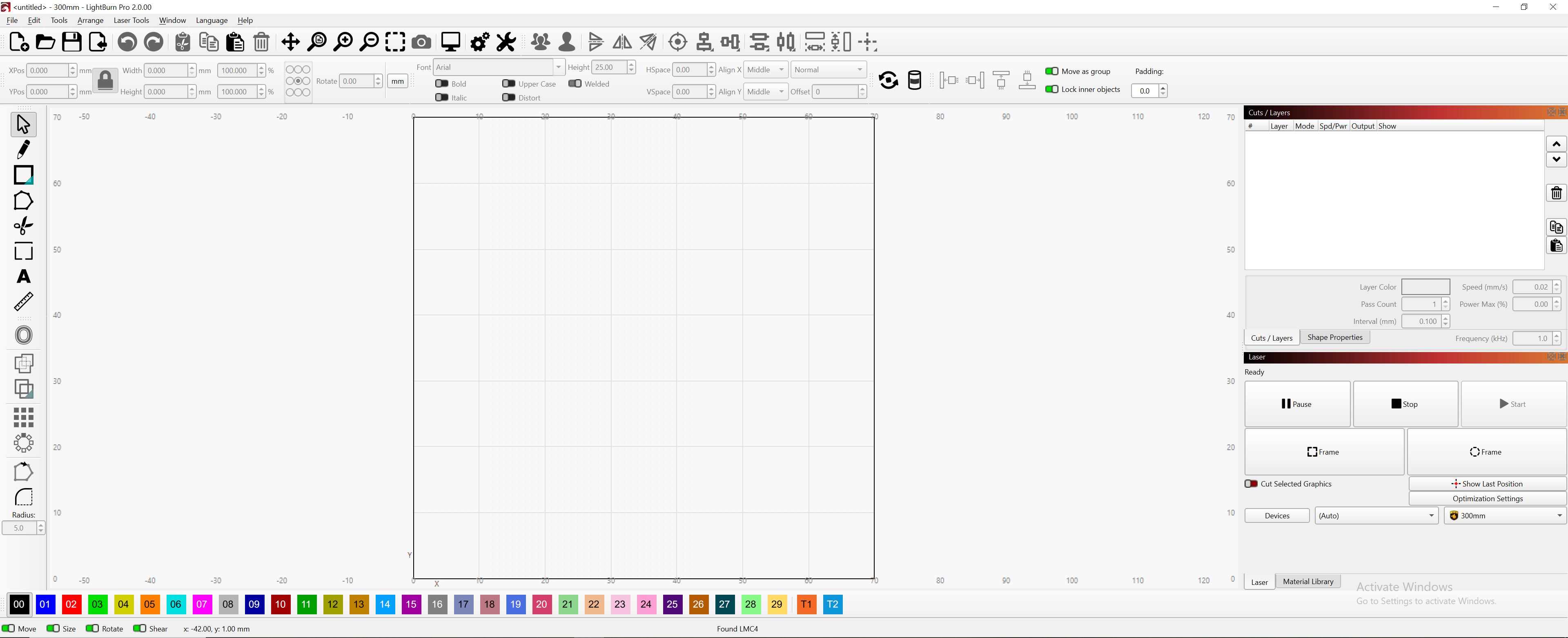

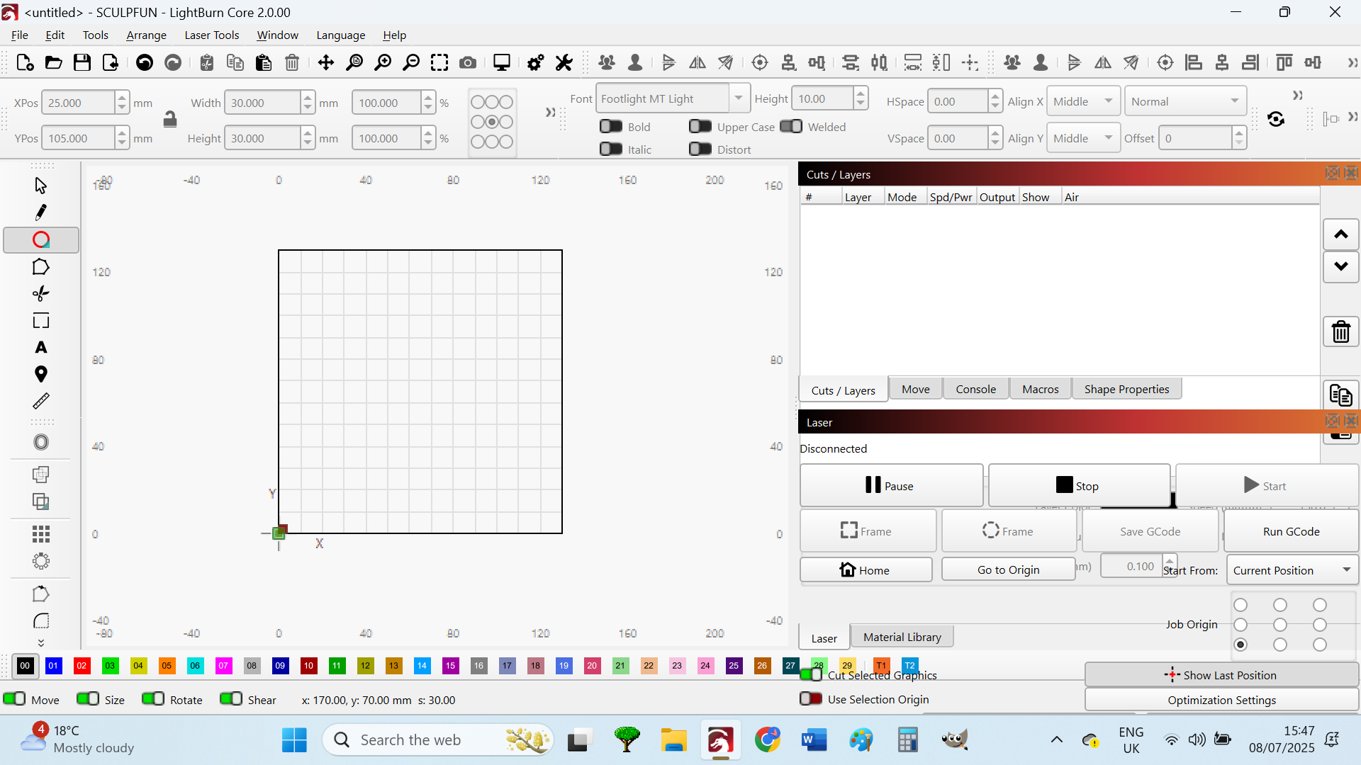

Firstly all the buttons seem to have been enlarged? I then simply wanted to draw a circle, but it does not give an option to do this? Also, all the selections on the left hand panel from the offset shape are not active and grayed out

This is explained in the release notes, you need to click on the small triangle and will get the option to draw other shapes. Or use the keyboard shortcut.
As long as there is no object in the workspace, you can’t use those tools.

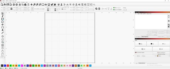

I am seeing the same problems. All sections too large for a laptop scree. I’ve reduced the font size but this hasn’t cured the problem.
There is a slider to adjust the size of the icons. You can also adjust the font size.

There seems to be a small scaling factor issue on Window machines using Scaling equal or above 150%.
Try these steps to have a better control on your icon/font/Spacing scaling
