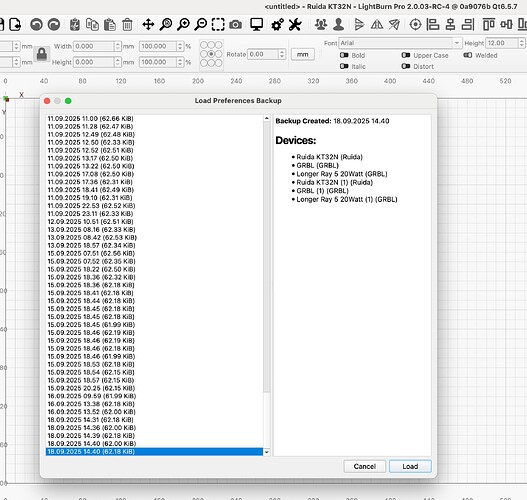

Try to find your preference folder and load the last one that worked for you.

As Bernd suggested, I selected and activated an older folder. The laser then started working again. However, the camera image is still not displayed in Lightburn. Nothing happens in the ā€œCamera settingsā€ field where the image is normally displayed. The camera settings are correct, and the device manager shows that the camera is being used by Lightburn. Nevertheless, the image is not displayed under camera settings.

The ā€˜Prefs file’ that Benrd recommended reloading, is re-written every time settings change. So, now you have at least one good one and at least one bad one in that folder.
Please send me a direct message with the most recently changed lbprefs file (that partially fixed the problem today) and the Lbprefs file in that folder from just before that.
This may give us enough to go on.

I took a look at the issue and found the following.
Before loading a past folder, nothing worked at all. I then loaded a folder from June 2025. Everything worked again, except for the camera. I then loaded every folder, including those after the license renewal, and checked the date when the laser stopped working. Now here’s the surprise: since the laser started working again with the old folder, all subsequent folders are working again too. Even those after the license renewal, which caused problems at the beginning. Very strange. Nevertheless, the camera is not working. I can’t calibrate it either because it doesn’t project any image onto the Lightburn surface at all. Nothing works. I made the switch to Com7, but still no image appears from the camera. Should I completely uninstall Lightburn and reload it? Could that help?
