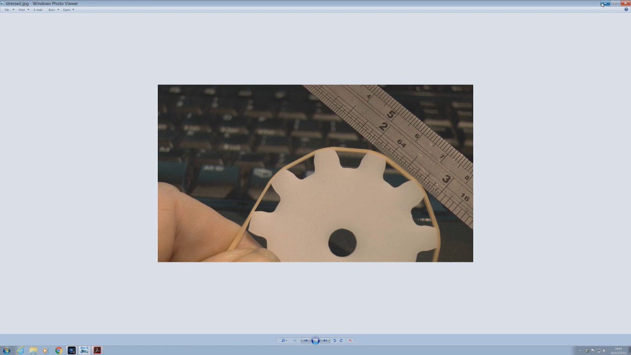

I used to think so, too, until we got a report of NEJE shipping mismatched belts and pulleys. As a result, a perfectly adjusted machine had dramatic skips & backlash, because the belt teeth did not correctly fit the pulley teeth.
While I doubt that’s the case here, it’s prudent to consider all machines as a collection of random parts requiring verification of the obvious assumptions we all make… :frowning_face:
Yeah, if you’re using the wrong belt for a given pulley then all bets are off.
But when using the correct parts, belts have no backlash.

If it’s a toothed belt, you can have the belt stretch as it’s coming into contact with the toothed pulley.
