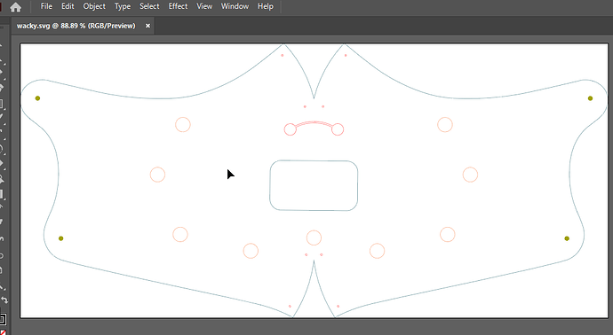

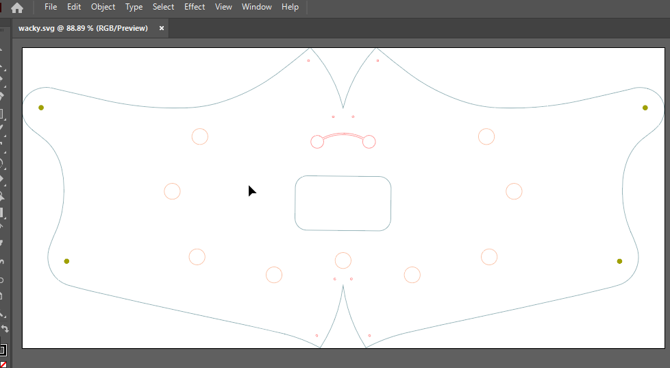

Problems with svg files since latest update. It is Easier just to show you
Problems with svg files since latest update. It is Easier just to show you. Thank you in advance. https://youtu.be/SBXGJokAH-g

Super Wacky svg file exported from lightburn
I am not able to replicate errors when importing a svg created Adobe Illustrator as svg into lightburn but what it did was changed line thickness (thinner) and r

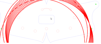

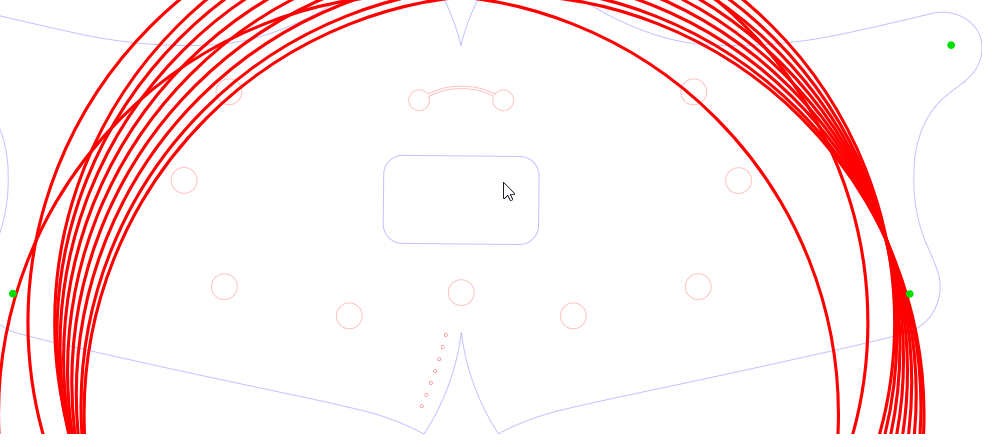

Exporting SVG from your lbrn2 file, i get this:
So i am unable to replicate or - i am doing some step incorrect
sorry, this is the file. The one I sent you did show missing parts but this is the one you want.
I Believe the forum is rendering the SVG into an image.

I can import your file into illustrator and it works fine

Ah ah ! THIS one done it for me too!
yes, All my new svg files I export from lightburn show up wacky in illustrator since update.

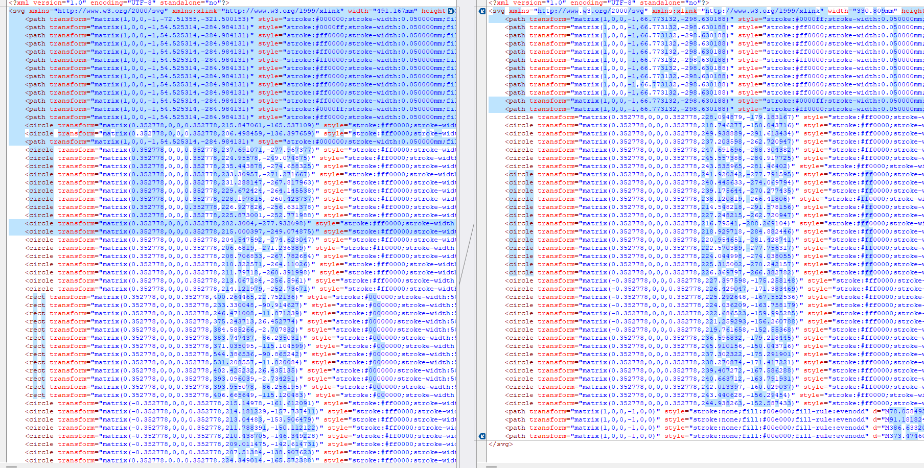

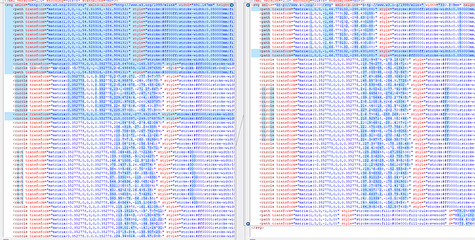

Do this for me please Baron
Open your NOW Best so far.lbrn2 (37.9 KB)
Edit > Select all > Copy
File > New
Edit > Paste
Export.
Can you see if export now is ok?
no, still wacky. This has been happening to all my svg’s
ok latestTTTTTTTT
Very odd. by simply doing the above the exported svg changes a lot
I can definitely replicate however, rendering between Illustrator and The browser are not consistent.

I was able to make it wackier by changing it to 150% scale
Super strange
