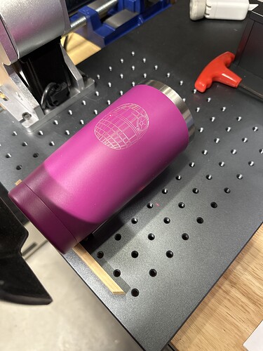

Hello People of the LightBurn Community,
I’m having issues with the “cylinder correction setup” tool. I have my image laid out within the etching boundaries and it looks good.
My mirror distance, object diameter and all other settings look good. When I start the laser, it obviously etches exactly as shown in the “preview”. What is causing the perfect circle to be etched in an oblong fashion? Any and all comments are well. I am a fiber laser noob, so take it easy on me. Thanks in advance for the help!
Cylinder Correction is meant to be used if you are not using a rotary. So i don’t think it will help with your issue here.

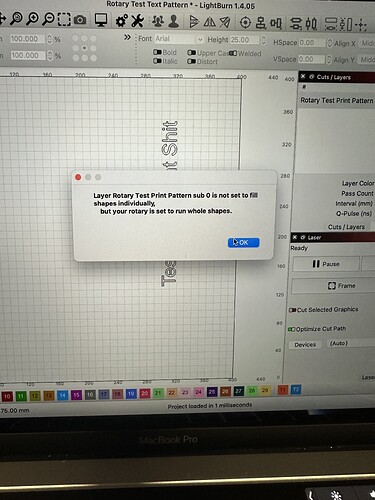

Thanks baric1317 for the help. I will give it a try. I was only trying this method because I have a rotary tool and my results are even worse than this. Here are some pictures of my messy rotary tool work. This is really frustrating. =(
It shows you have 5000 steps per rotation. that doesn’t look even close to the correct value
Yes, I corrected it and made it 12800…and the problem still persists. I just want to make a darn personal tumbler! LOL
When you do the test from the Rotary Tools Setup does the rotary turn in both directions and end up exactly where it started. What model of rotary chuck are you using. 12800 still seems way to high.
Try putting your mug into the rotary. Put a little piece of tape or a mark exactly on the top (0 Degrees) of the mug then run the test. The mug should end up with the mark or tape exactly on the top where it started from
Your screen looks a little different from mine. I dont know what Split Size is for. I dont have that on my screen. Also your screen says steps per rotation and mine says mm per rotation. Maybe your using a diferent version of Lightburn

I think your diameter was wrong on your first photo, just comparing it to the hole spacing on your table.
I think Albroswift is correct. I missed the setting for circumference. Correct the steps for rotation so the tumbler makes one complete rotation in each direction and returns to the exact starting point when you do the test from the Laser Tools Rotary Setup. . Then correct the circumference setting. Mine ended up being around 275 mm for a 30oz tumbler . Yours should be somewhere around that.

Very first image laying on the table. Chucked up image further down was showing how not to configure rotary!
I check with the manufacture, Omtech, and they told me the proper setting is 12,800. I did test the rotation and it does go 360 degrees and back to its origin.
@baricl1317 Yup, I pulled a bone head move! My calculated circumference is WRONG. I will recalculate and try it again. Thanks for the help everyone. I will up date y’all one way or another.
@Albroswift, sorry for the confusion…I was not using the rotary on the first image. I’m trying any and all methods to squeeze a tumbler out of this machine.

Don’t calculate it, measure the diameter and let Lightburn do the calculations…

If the curve allows cylinder correction to work, it will do a nicer job then the rotary, but like noted above, rotary more versatile.
Agreed, Measure the diameter of the tumbler.
