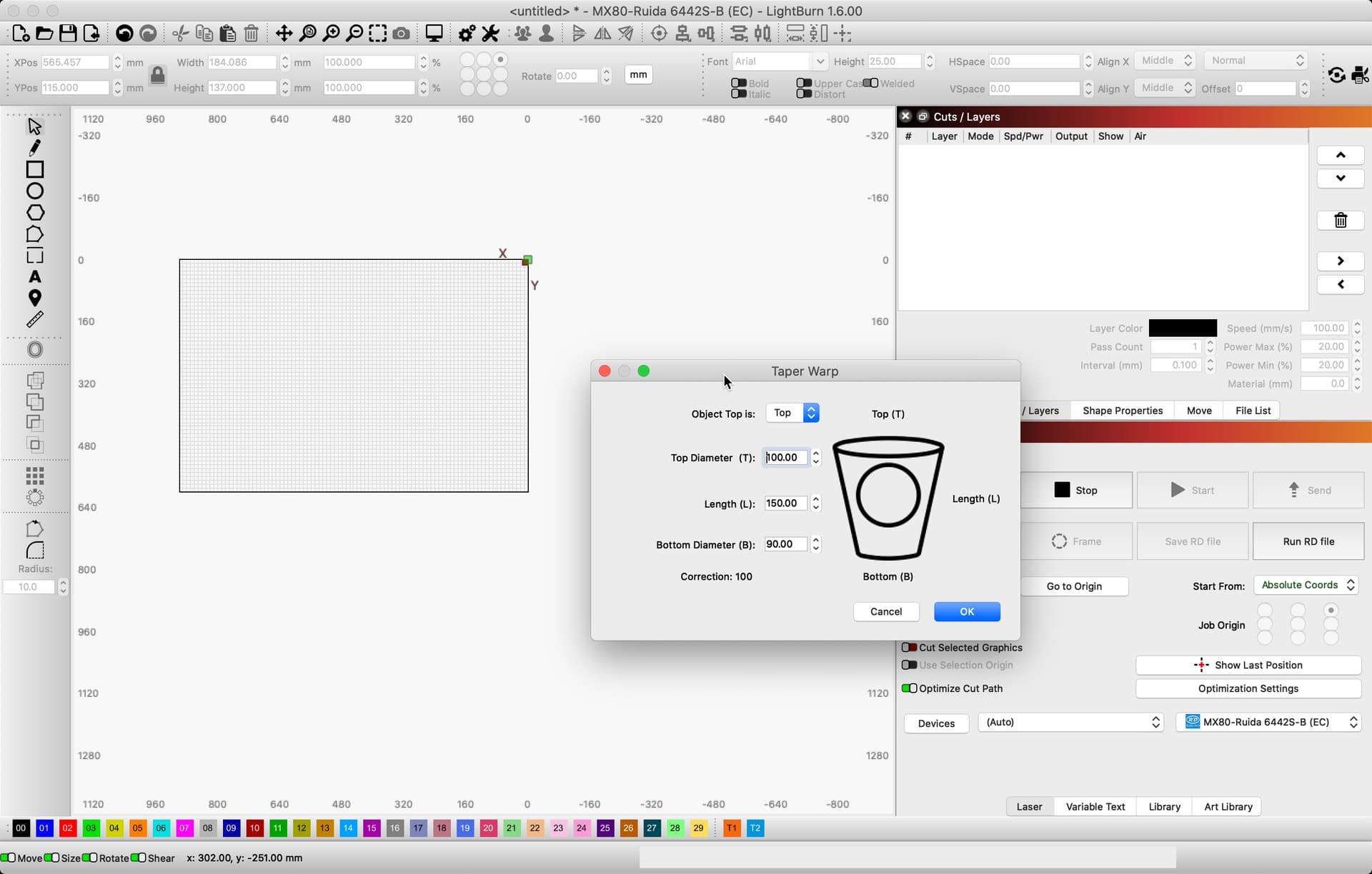

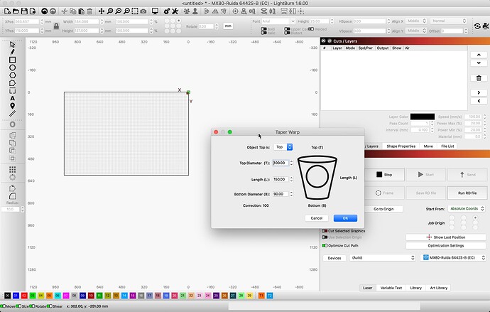

Thanks @sutick, so not sure if this is intended, but for me, the Taper Wizard with empty file.
Weird? I think you misspelled ‘Software’. :upside_down_face:
Indeed. still trying to find the variable that triggers it.
But does seem is more than the unselect
Because if you were to move the taper from top to lefr or right you would get a -3.xxxxxxx weird number on the wizard so might be another buggy
OK, have figured out a little more. If I leave the settings in the Taper Warp wizard at defaults, everything will work multiple times. However, if I change the settings from default, it will fail on new files. I’ve been able to replicate this on two different machines.
My steps are as follows:
Create a rectangle, select it and do a taper warp. Set top to 86.5, height to 148 and bottom to 60.5. Select OK to perform the warp.
Now, start a new document. Create a rectangle, select it and do a taper warp. The rectangle will become unselected in the background, and no matter what you do, taper warp will not have any effect on it.
Bingo! Thank you for continuing your testing. @adammhaile, I am able to replicate this using these steps on my Mac as well. :slight_smile:
Found and fixed. Will be in the next update.
