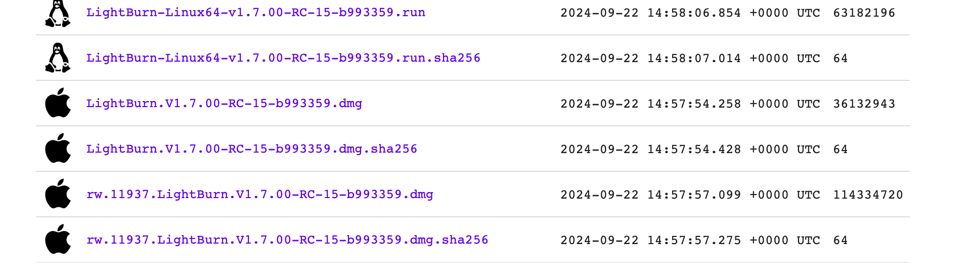

RC-15 is out: Index of /LightBurn/RC/LightBurn-v1.7.00-RC-15/
  • Bugfix: Interval edit followed by sub-layer tab change wouldn’t commit the interval change

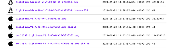

What’s the difference between version RW.xxxx and the other version (for Mac)?
Not sure what you are referring to.
Oh, the rw.XXXX versions is a glitch with the CI system that I need to fix. There actually shouldn’t be any difference but don’t use those.
Ah great. I missed that announcement. That’s good to know. Thanks.

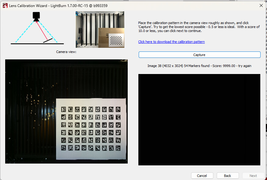

WeCreat Vision 40 Camera Calibration issues.
I’m having a very difficult time getting through calibration. Constant 9999 scores when it’s as clear as can be in the preview. I’ve tried with and without backer material and it seems to work better just laid right on the slats.
I’m focusing the machine first before I do calibration so it lowers the camera down to the correct height for the material. Should I be doing this at the full height of the machine and not doing a focus first?
Also do I need to use positive stops for the positions. i.e. right top/middle/bottom do they need to be exactly the same right alignment or if one is inward or outward from the other will that matter?
Thanks.
And when I do the circles (yes I’m selecting the right pattern on the first screen) it tells me pattern not found
