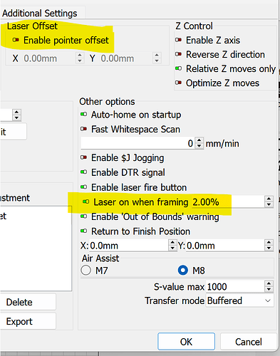

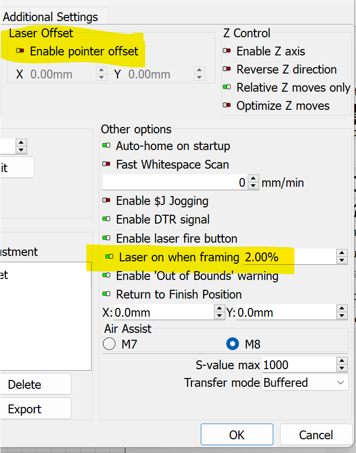

Can frame use the offset “laser X” instead of the actual laser. This is a big problem
The updates between different RC versions are mostly small clean ups or targeted bug fixes to an already existing function. We don’t publish the changes in detail because they don’t include new features generally.
The recent update from RC11to RC13 was mainly related to language translation files and GS1 control codes.
What do you mean by “laser X” please?
If you have an additional laser pointer for the framing, you would set the offset to your actual laser and turn off “Laser on when framing” in the “Edit > Device Settings”:

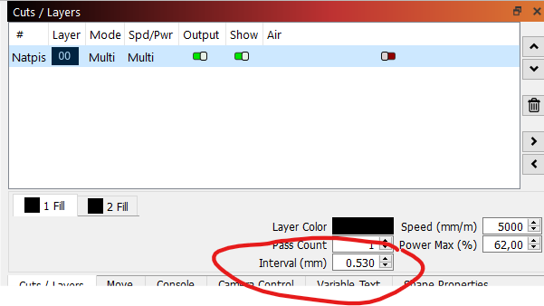

@adammhaile Could you please check this also and fix before GA if possible, I often forget about it, so if I don’t double check, I run the laser with the wrong settings :grinning:
Not sure what you mean. Works as intended for me with latest RC.
sub_layer_interval
Cut settings editor is OK, problem is only in Cuts / Layers window.
