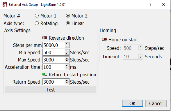

I am planning to buy a Galvo MOPA laser and I have a question, if LightBurn supports sliding table.

To answer your original question, you should be able to use “Repeat Marking” with a little experimentation. I thought I saw a “Linear” setting in there somewhere, can’t find it now.
Here it is: Laser tools> Repeat Marking> Setup
Thank you.

I use Universal G-Code Sender “UGS” my controller is an Arduino Uno flashed with Arduino IDE. I haven’t used it for repetition, only to move workpiece left or right to extend the work area for larger continuous projects, like a 1911 slide (Have to move artwork same distance as table moves.) If I were doing repeat I would drive it with lightburn. I mostly use the UGS to drive the Z axis, only way to go, it supports a library of macro’s and allows input commands in the macros, so for example I have a macro for 300 lens that has an input for material thickness.
It looks kind of complicated but really not.
