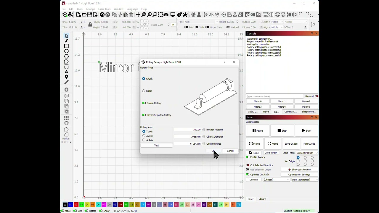

Jack, it behaves normally when Mirror is turned off in Rotary settings. When turned on, it becomes weird, for example, using current position the green job origin dot appears way outside of the job area… very strange.

What does seem questionable is that Lightburn is showing the green origin block elsewhere. If this problem exists in the machines firmware, this should not occur.
This is problematic because you configure Lightburn separately from the machine. Such as machine/software origin. You get unpredictable results when they are configured incorrectly.
The green dot positioning certainly is puzzling.

I made a quick video that shows the moving green dot.
Job is set to Start from current position, with job origin at top left.
Note how the green job origin dot moves off of the object when rotary mirror is selected.
Is this the expected behavior??? If so, why?
Disregard the selected Y axis choice in the rotary setting in the video, it should be set to Z on the D1. The results are the same.
