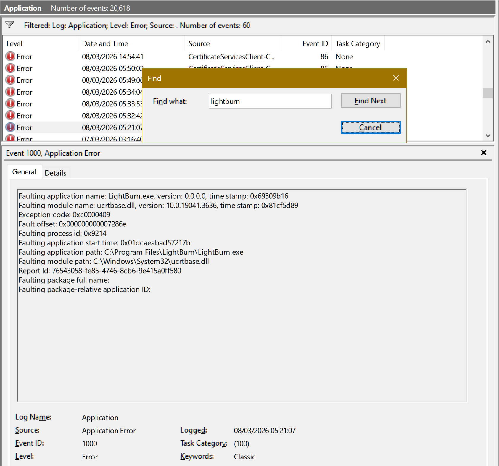

To add to the errors above, I did a search in the Events and have a few more errors one of which (ucrtbase.dll) is below, although not noticed:
Also sometimes there is a bit lag that hadn`t noticed before, I have to check if it was something that Microsoft messed with my system, because I had to let some services communicate with the outside to activate Corel Technical Suite.

The ucrtbase.dll appears to be part of the Universal C Runtime. Reinstalling Microsoft Visual C++ Redistributables might help:
Uninstall all Microsoft Visual C++ Redistributables from Control Panel > Programs and Features.
Then:
Ok didn´t check. Thanks. I think gonna check for a Restore Point before the Corel activation and move from there.
