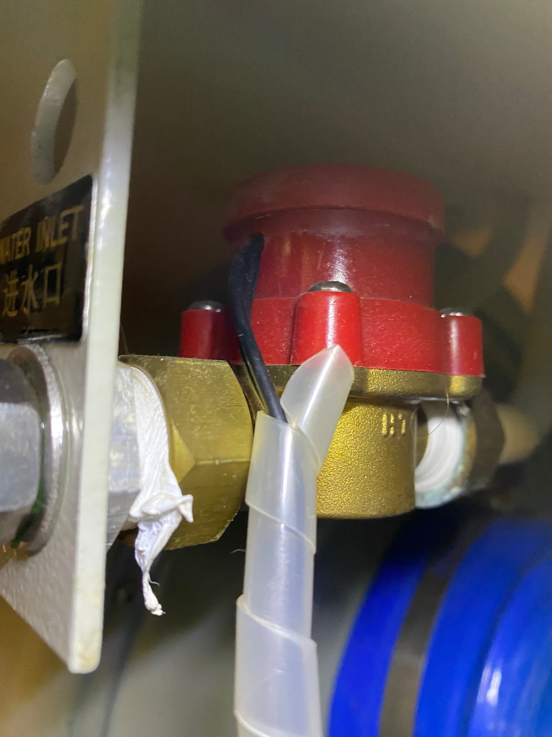

Can you send me a picture of the flow switch?
sure can!! give me a minute. I will have to crawl under the cabinet. I have a very bad back and it will take a minute or two…lol
Take you time, don’t hurt yourself…
Here is the pic of the flow sensor
From the photo I can’t tell what type you have. More expensive than what was in mine.
Can you follow the wires?
I’m assuming one side goes to ground or +V, where does the other end up?

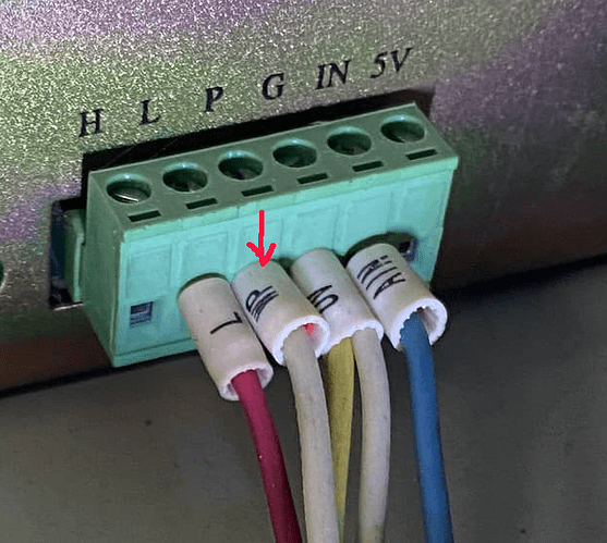

Where does the WP (white) wire in the lps photo go.?
This could be another way to enable a water protect scheme. This would disable the lps or prohibit the lps from firing.
Let me try to follow the wires for ya
The sensor is actually the two inside white wires
It appears to me that the flow switch is wired to the lps.
The P input is water protect and needs to be pulled low to fire the laser.
This will serve as a laser protection, as far as firing.
The controller will not know there is an issue and all the ā€˜stuff’ in the laser will be operating as if nothing is wrong, but you won’t get the laser firing… if this makes sense.
When you have time I’d suggest grounding the P connection and moving the WP wire to the WP1 input. You would also have to enable the Ruida wp sensor.
