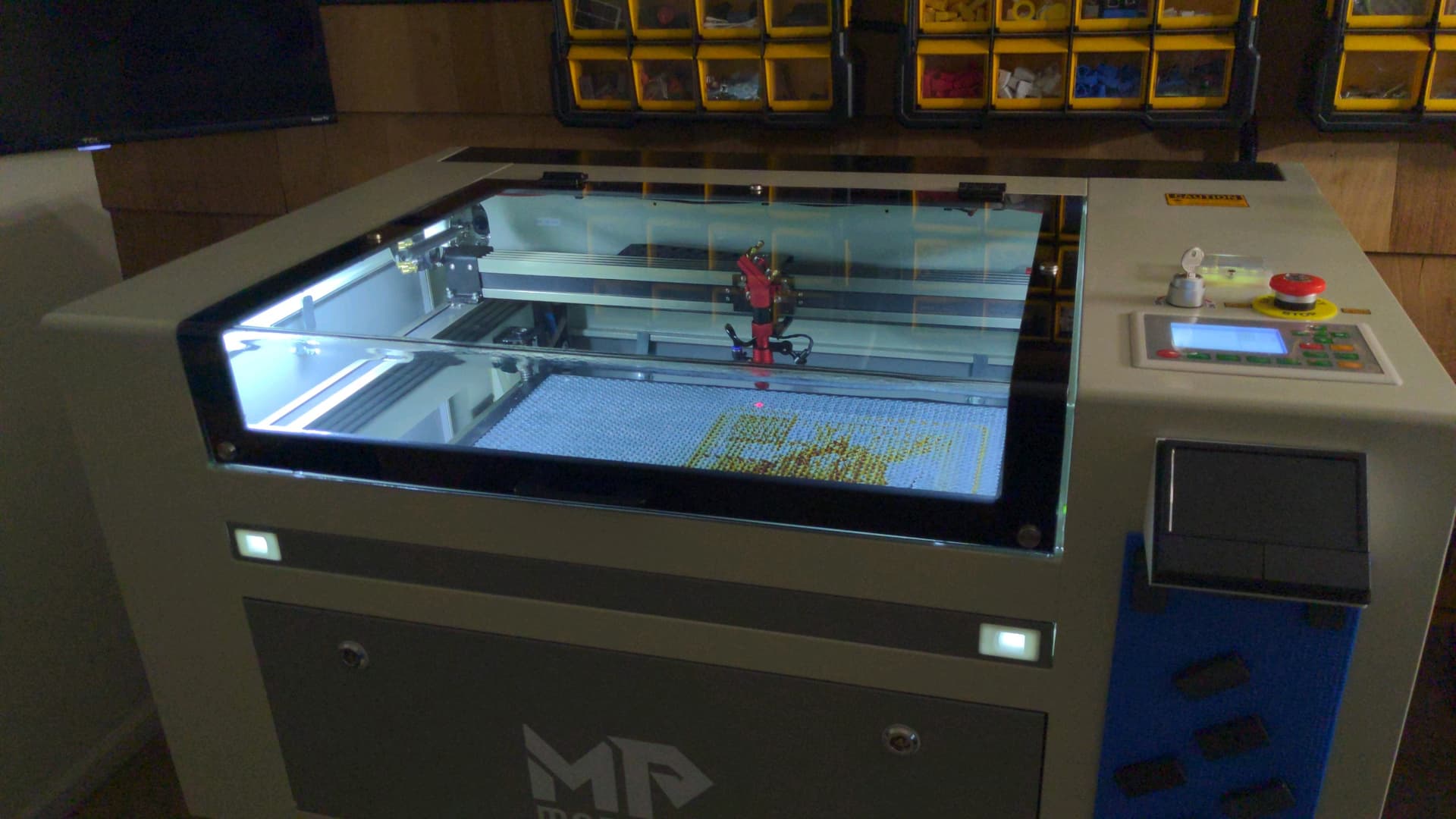

Well, I grabbed the Sharpie Marker and the 2" Hole Saw and got the Milliamp Meter mounted today. Haven’t wired it yet, but I pre-ran some wire the last time I had those goofy grey wire chases open (they’re a pain to get off). So it’s just some clipping and crimping tomorrow, to get things finished.
I also designed and 3D printed an angled doo-flatchie thing… to hold my wireless touch pad anywhere I want (notice the two massive magnets built in - it can be placed anywhere on the steel chassis).
I think it will go here:
I was just going to set it on top of the laser chassis… but I have premonitions of going to Left-Click and accidentally depressing the Stop button with my wrist. So I think it best to stick it in front of the control panel instead. :grin:

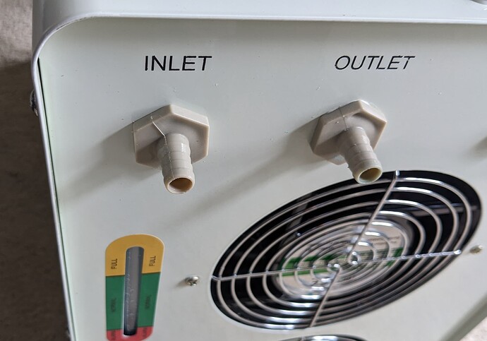

Wow… they just keep stepping in it…
From their website:
High-Grade Ports
Monport CW5200 chiller’s inlet and outlet ports are made of high-quality brass to keep long-term, non-corrosion performance and prevent any issues with leaks as it operates.
From today’s delivery:
The deceit is just pathetic. These “Brass” inlet and outlet ports are as PLASTIC as they can be. AND the drain plug.
Even my no-name, un-branded, non-chilling, CW-3000 Chiller had metal ports.
Unreal.
Jim

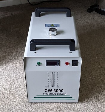

Yup. Read that article a while back. My CW-3000 was just distilled water. I know it does not actually chill… but at least it was a closed loop system and kept bugs and other what-not out. I even wired up the alarm output into my K40 (since it had no flow meter) so that anytime I tried to fire up the laser without the chiller working, it would not. I tied it into the hatch switch circuit as well.
The Monport 60W already has a flow sensor in it, so it’s just the Input hose and Output hose to deal with. This CW-5200 is certainly louder than I was expecting, but I’m expecting years of service out of it anyway [knocks on wood].

You can purchase those hose nipples and replace them with bronze versions that are pretty resistant.

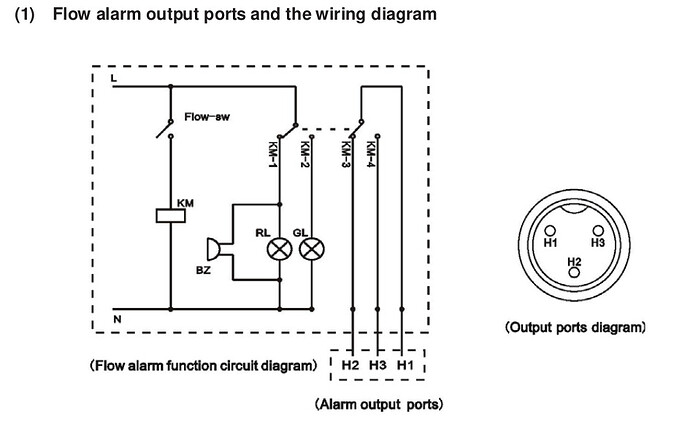

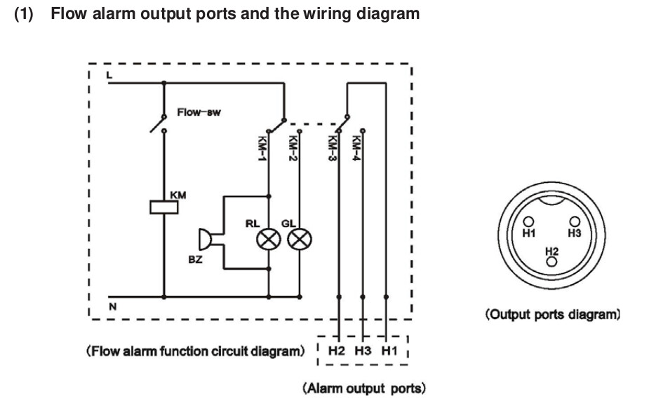

Forgot to mention you can remove the flow switch from your K40 and route it through the 5200. That will take advantage of over/under temperature along with flow and power fail of the chiller.
Uses the smarts of the on board temperature controller in the 5200… it’s a simple wire addition…
Mine is wired similarly.
Already sold the K40. Didn’t see the need for both, so after I had the 60W up and running, I listed the K40 on Craigslist (where I got it from back in November) and got my investment back, plus a little. The new owner is already up and running and particularly liked that it was a K40 running Lightburn. I kept the CW-3000 chiller for the 60W, and gave him an unused aquarium pump system. But now I have the CW-5200, so I just listed the CW-3000 on Craigslist also.
For the record, I had the same connectors between my 3000 and my K40 as you’ve shown.
Do you have the chiller wired to your 60W?
No, the 60W has its own flow switch… If the water ain’t flowing, it ain’t glowing.
The k40 didn’t have a flow switch, so I just tied into the normally closed circuit in series with the cover switch. If either one of them opened, the laser wouldn’t fire.
I didn’t see the need to tie the CW-5200 into the Monport, since it takes care of that internally.
It won’t halt it for a failure to maintain temperature, both high and low, but the 5200 will…
What’s on the 60W is just a flow, nothing else…
