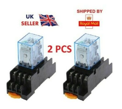

Turns out it was the relay all along!
Yikes! I’m not sure how I would ever have successfully troubleshooted that problem. Good on you!
Hi Simon thanks for your reply, did you change the stepper and then find it was the relay. how did you test for the relay, my machine is moving slower since i replaced the stepper and only half way across the bed, how do i check the relay, Sam
Hi Sam, I didn’t end up replacing the stepper as I found this burnt out number 7 connection (rotary switch) and decided it may be somehow related. Swapped the black relay over with one from ebay and hey presto, fully working again!
